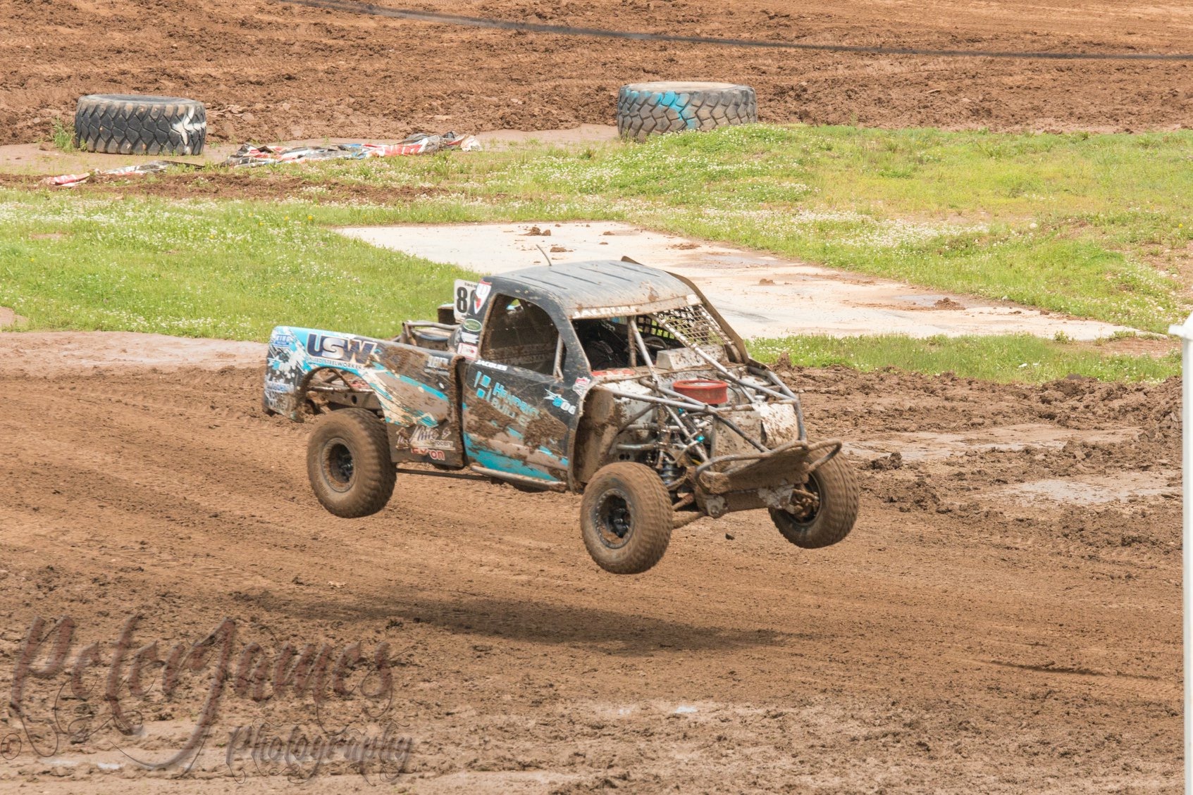

Which brings me to our current race truck. In 2014 we “rebranded” as NineZeroSixRacing, and I bought our current chassis - a 2012 U-Weld Chevrolet.
It took me roughly a year to get the series to allow this truck in the Super Stock class due to the front end using coil overs. TORC / USAC gave us the go ahead to build it June of ‘16, and we hustled it together for the July Bark River race that same year.
That was the only race we ran in ‘16, we attempted a full season in ‘17 but missed a few rounds due to engine failures and budget issues.
Last year came around and we headed into it with a really fast truck, but bad luck bit us again when we lost a motor in pre season practice. We bought a motor from Comp Products in Wisconsin for our first round in Crandon and blew it up 4 laps in. 2 motors blew our chances for that season, and we decided to hang it up, but came back for Fall Crandon with a real motor and a new engine builder and ran hard, with our last race ending up with a smoked trans. Another awful year of luck in ‘18. Here’s some pictures of the new truck.
The chassis when I purchased it in ‘15 The truck after at our first race after taking it from bare chassis to “running” race truck in less than a month
