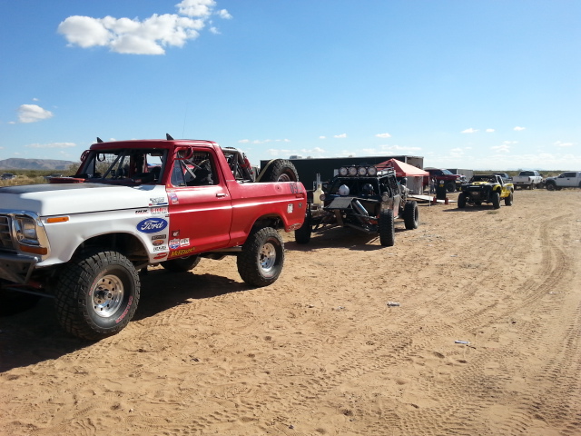

- Getting ready
- 20141122_124420.jpg (163.77 KiB) Viewed 34077 times

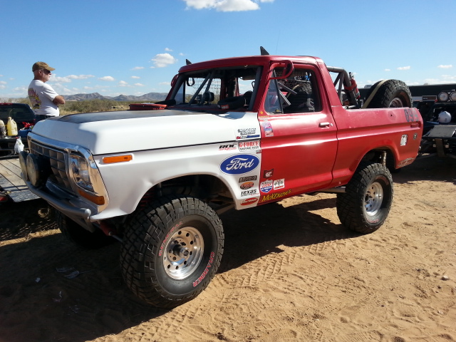

- A couple guys from a few other races we did showed up.
- 20141122_124352.jpg (160.27 KiB) Viewed 34077 times
