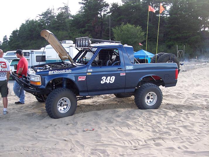

Scott Wooden out of Corvallis Ore. .Built by Kevin B. of Extreme Motorsports Beaverton,Ore.
robs bronco 001.jpg (100.68 KiB) Viewed 5560 times
yogib
Posts: 170
Re: Scott Wooden,s class 3
Post by yogib »
A few details: stroker W motor.Mass air conversion,Air cleaner in cab,3" King coilovers,engine cage,king Bumps,King 2 1/2" bypasses in the rear,2 1/2" wide deavers in back,1 1/2" longer shackles,boxxed beams,15" longer radius arms with Heim ends,swing set steering,trussed 9-inch,C-6 trans..Picture taken at Sandlake Dunes,Ore. on a 4th of july I believe.
