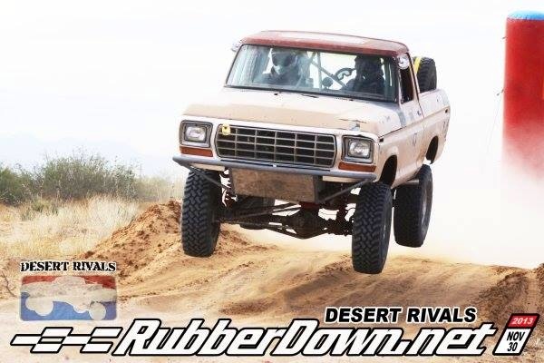

Were looking for feed back on are C-6 trans and 4.11 gears. Bronco has the 400m seems to work okay. We keep Lucas oil stabilizer in it . For the tran we know we need to beef it up.we installed big trans cooler with back up w/ fan. Thinking about adding manual valve body . Any thoughts? Also seem to run second gear most of the time. Was thinking about changing to 4:88 or 4:56's.. Thanks

You don't say here what tire size you are using but I would recommend 4:56 for 33" tires and 4:88 for 35" tires. Used a basically stock trans for one race and it did not like it very well. Going to needle roller thrust bearings helped as well as opening up the cooling circuit flow. A manual valve body won't help with trans life but does improve the drivability. You do end up running in second gear a LOT, just the way it is.
