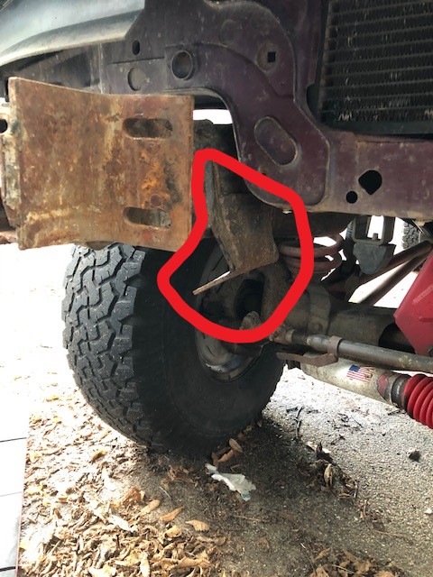

Excuse my ignorance here but can anyone tell me what these brackets are? There is one on each frame rail. I pulled off my front bumper to start fabbing up a new one and saw them, just want to confirm what they are before i go ahead and chop them off.
Thanks!
nubreed71
Posts: 1531
Re: Midwest Long Travel Build
Post by nubreed71 »
Pretty sure they're either brackets for the front swaybar to bolt to, or for an OEM skidplate to bolt to depending on the vehicle. I think Solo's pre-fab bumper uses them as mounting points, but you're look a little bent, so probably best to just lop em off.

S00TLYFE
Posts: 1076
Bronco Info: IT RAPTOR NOW
Location: Buena Park
Post by S00TLYFE »
nubreed71 wrote: ↑
Fri Aug 14, 2020 1:56 pm
correct theyre sway bar bracket bolt
