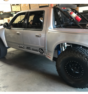

So this is going to be my ride for a little while. Some of you may know the truck and her old owner.
Ford F150 Super Crew
2 inch cage front to rear
H&M front end with 2.5 c/o 3.0 bypass race series king and ram assist steering
rear is linked with 2.5 3.0 race series king
The truck has been back halfed with 50 gal cell dual Tranny coolers and Batteries, it also has some aluminum boxes in rear behind cab.
Reaend is 40 spline floater and 10 inch third member
2.5 hubs with 6 piston brakes on all 4 corners
6 on 6.5 RG with 39 BFG KR2
PRP seats
PCI Intercom and head sets
110 kenwood
switch pros
Baja Design light
I will add to the list once I go through the truck.
It is a proven drive to location then drive home after vehicle that has been well cared for.
The build is done well with lots of up travel in the rear and a solid front end for what it is.
The truck is easy to drive and load the family in.....it meets my new life needs.

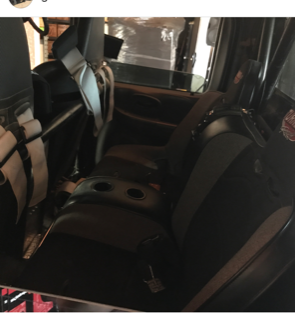

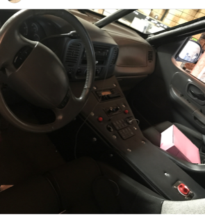

some more from before me owning.

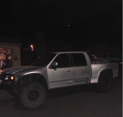

more late night pictures
