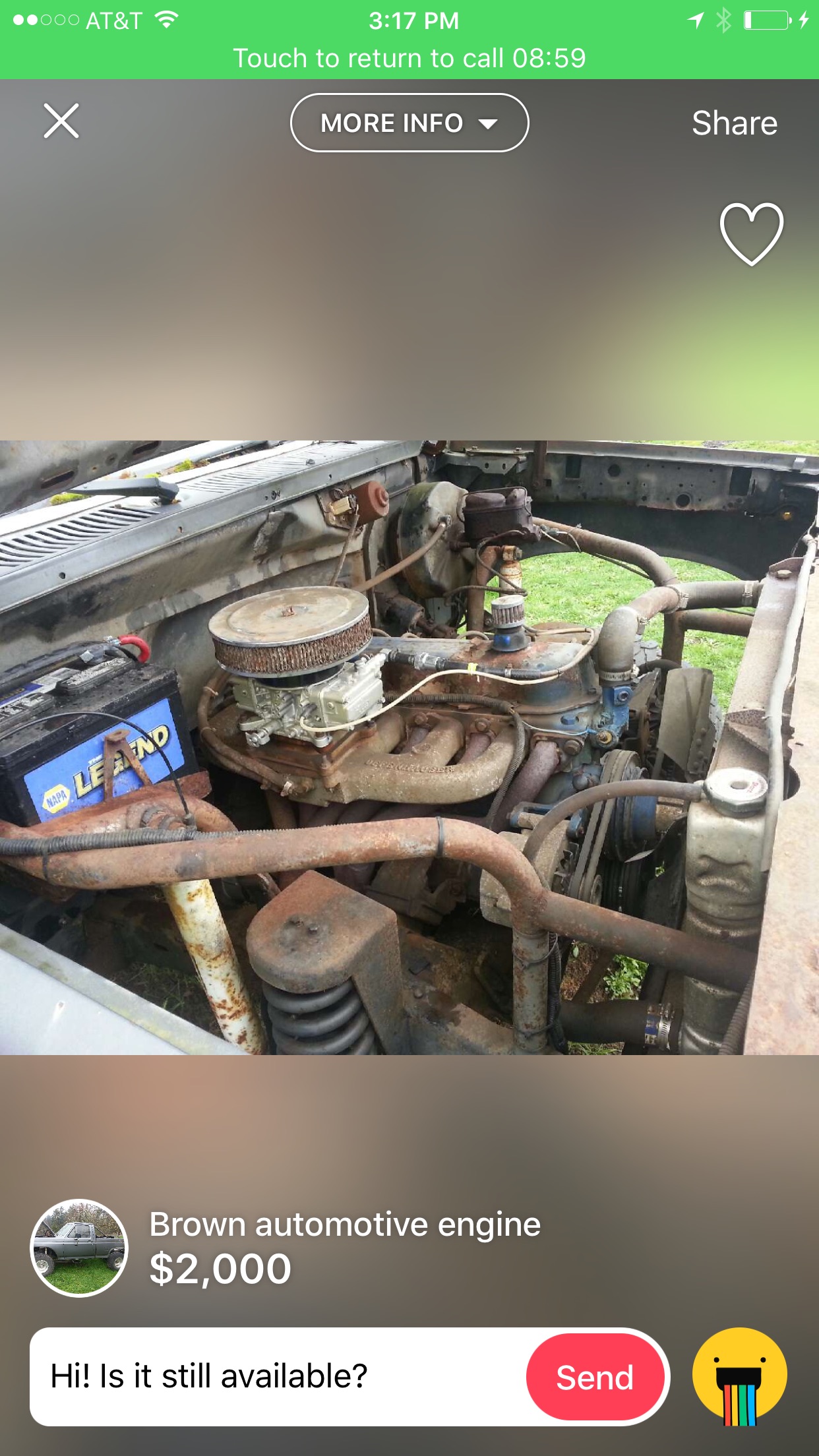

So, I just picked up this truck that I have some history with, back when I was in high school a buddies dads friend had this truck built by some shop in California, had a bunch of $ into it and then the guy got huge ( 450+lbs huge) and didn't fit in the truck, so he stored it at my buddies dads for 8 years, basically forgot about it, we used to steal it and take it to the dunes until he found out and came and took the truck. Fast forward 13 years and thenteuck pops up online for $2k, I had to have it. Now the truck has been sitting a long time and is very outdated now, old school rancho 9012's with air compressor under dash and controls mounted next to driver seat, built 300 6 cylinder and 4 speed that have to go. This truck is still 4x4 with what I was told was all autofab front end. This is how it looked when I bought it.

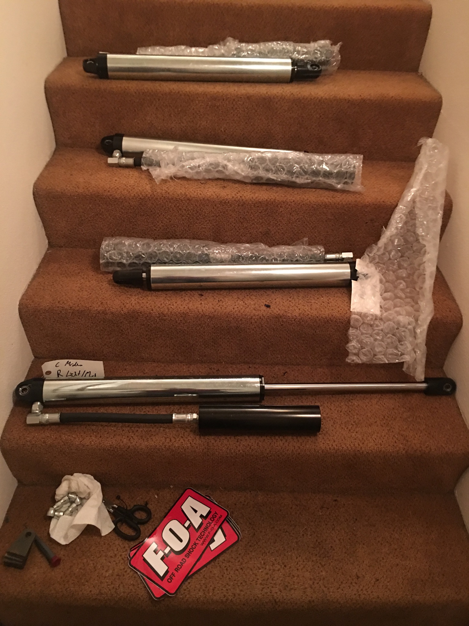

Well once I figure out the images thing, I stripped and sold the motor trans and t case, bought a 351w that's at the engine builder being turned into a 393 stroker, I built a c6 with upgraded internals and a full manual valve body, and purchased 4 foa 16" 2.5" remote res shocks, and I'm contemplating going to 63" rear springs for now until I link the rear.

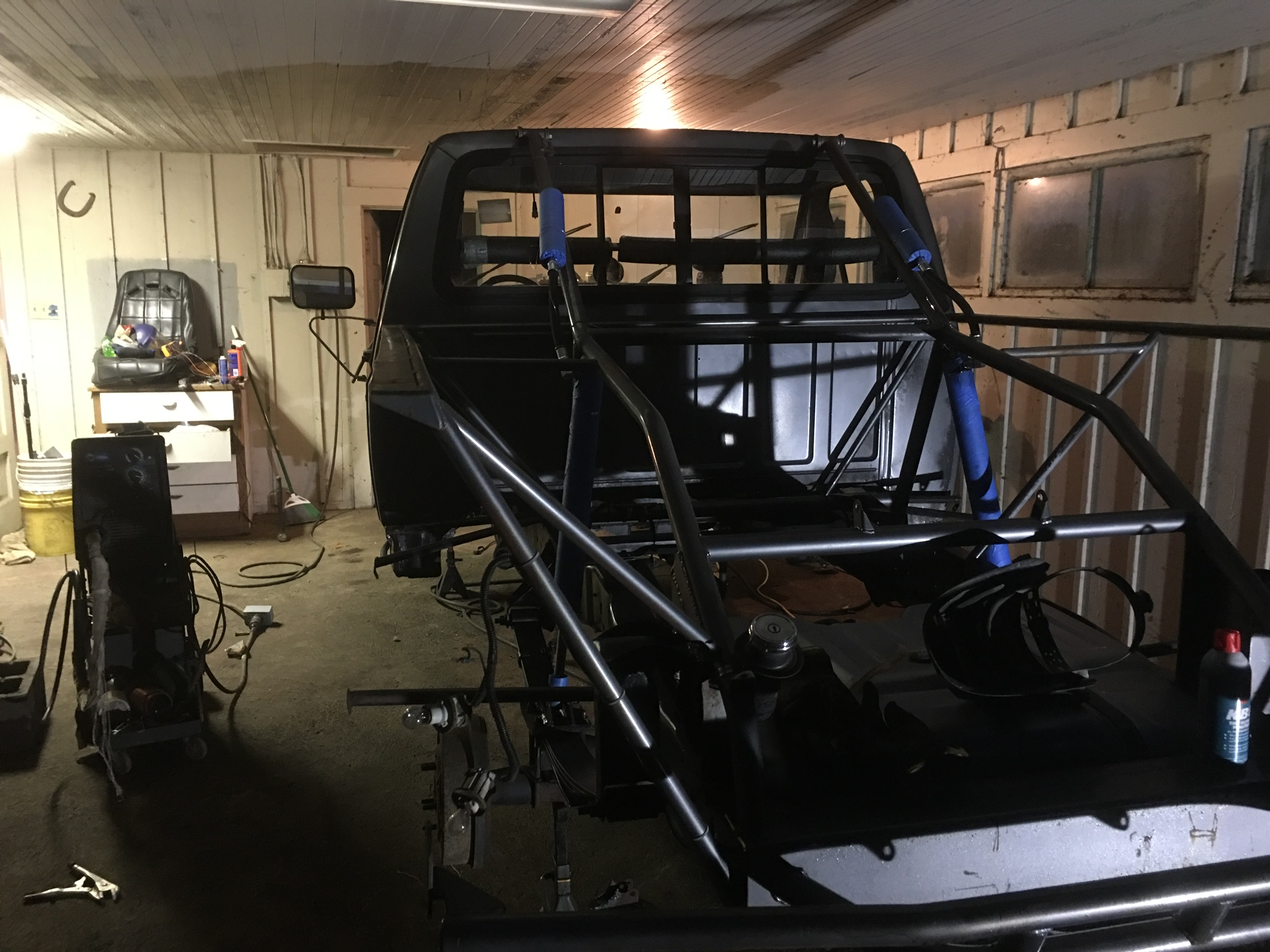

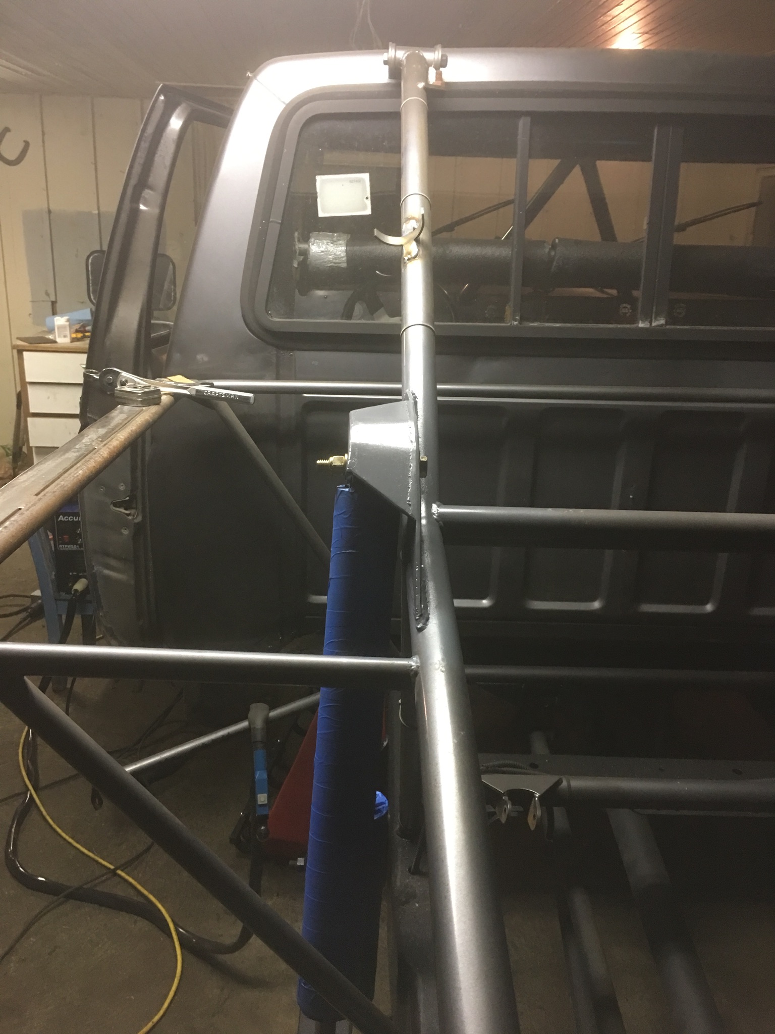

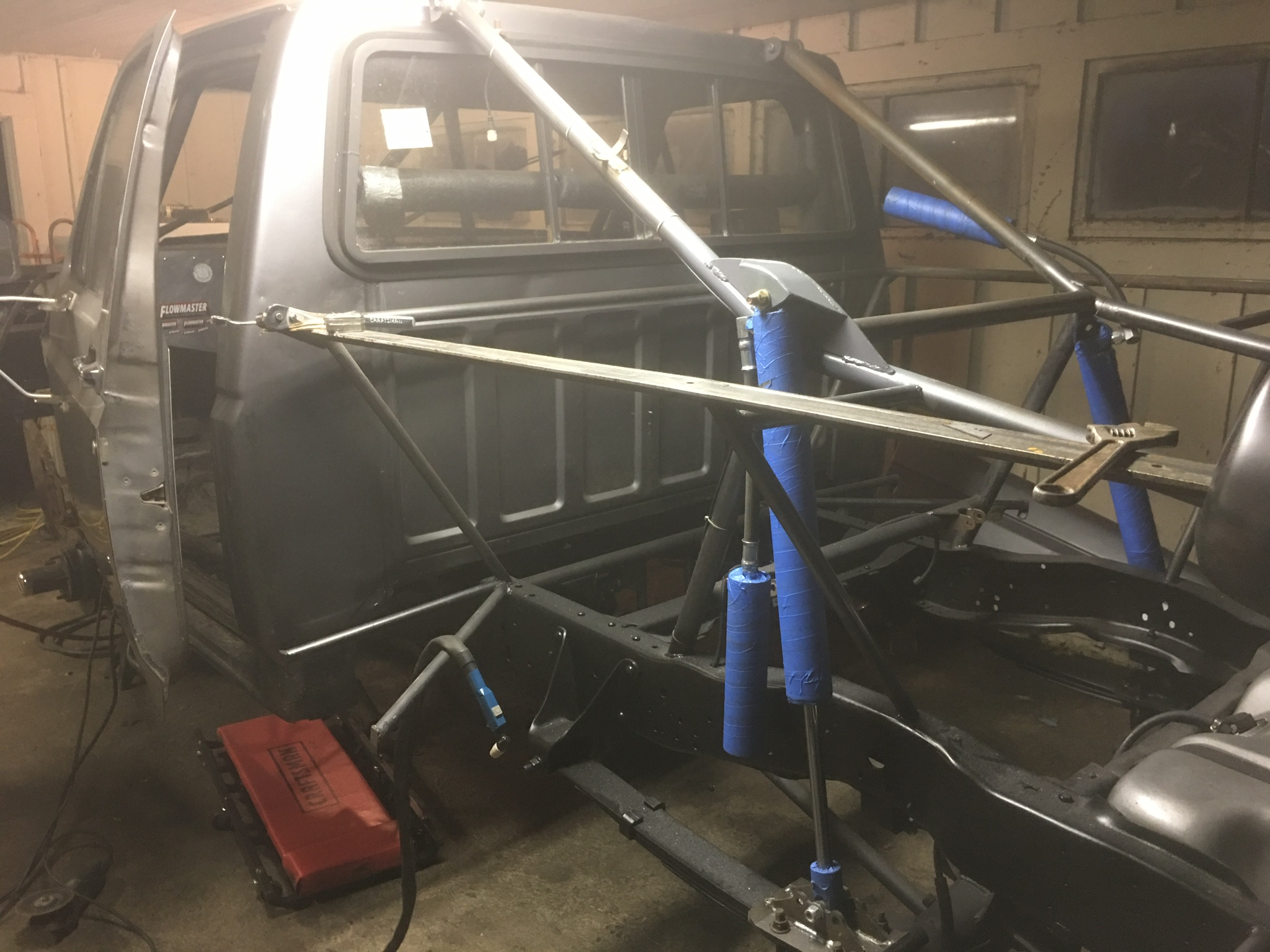

Post by Earthad58 »
Got some work done today, and got my plasma cutter all set up,man, I don't know why I didn't buy a plasma cutter years ago, sooo nice, got winshield v bars added, and made rear shock upper mounts, not stoked on ho mounts turned out, they arnt done yet but here's what I have so far. I also ordered up two new mastercraft original suspension seats tonight so can't wait until those show up

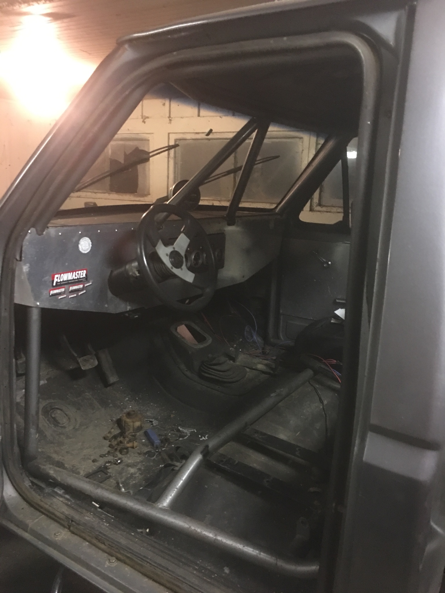

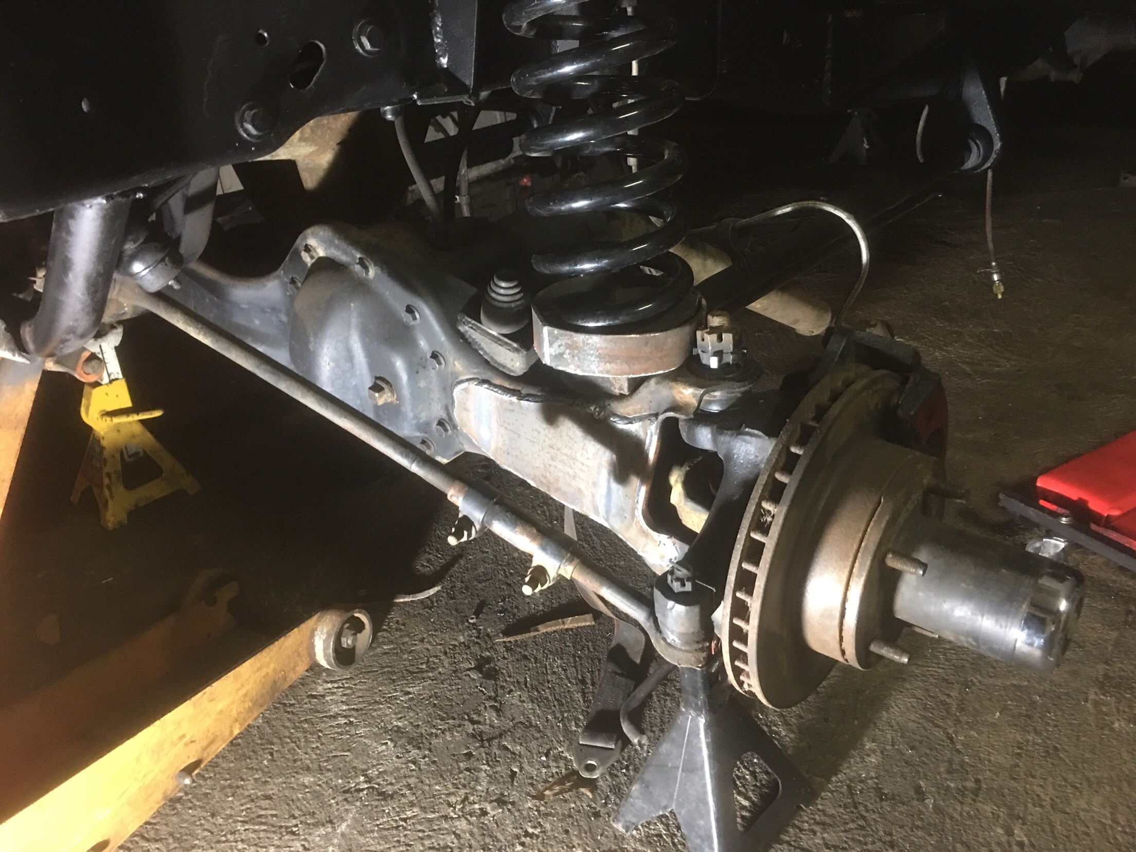

Did a little work last night, plated the front ttb on the front outside and the insides as well to box them in, also went to mount my new front coils only to find the the bottoms don't taper to a small round coil to fit the factory style bucket and clamp, so I dabbed up a coil bucket and a new clamp and installed front springs. Tonight I tackled installing my under dash heater which went in super easy and seems like a great little unit, just got to hook up two wires and I'm ready to start building my center console, the picture I attached of the console is basically the style I'm going for only instead of the ruddy console I'm going to just extend it to back between the seats, and I was thinking it would be cool to find a small cooler I could slide down in the console and the lid would double as a arm rest.
Earthad58
Posts: 31
Joined: Sun Feb 12, 2017 9:59 pm
Bronco Info: 81 f150 4x4 long travel auto fab suspension 393 stroker
Re: 81 f150 go fast race truck
Post by Earthad58 »

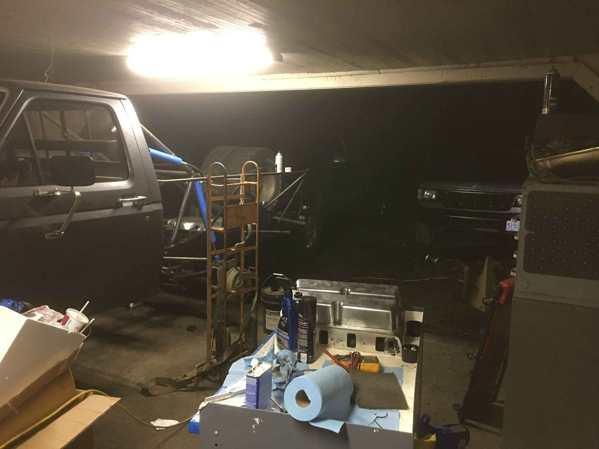

Started on the center console today, turning out pretty decent, turned out bigger than I thought but that's good, lots of room for stuff
