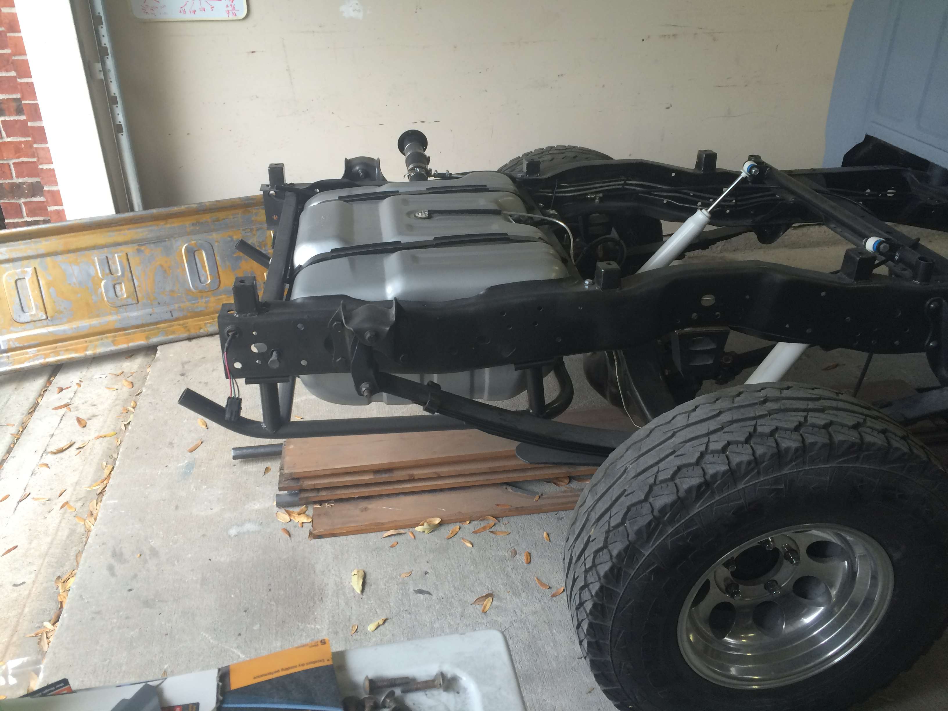

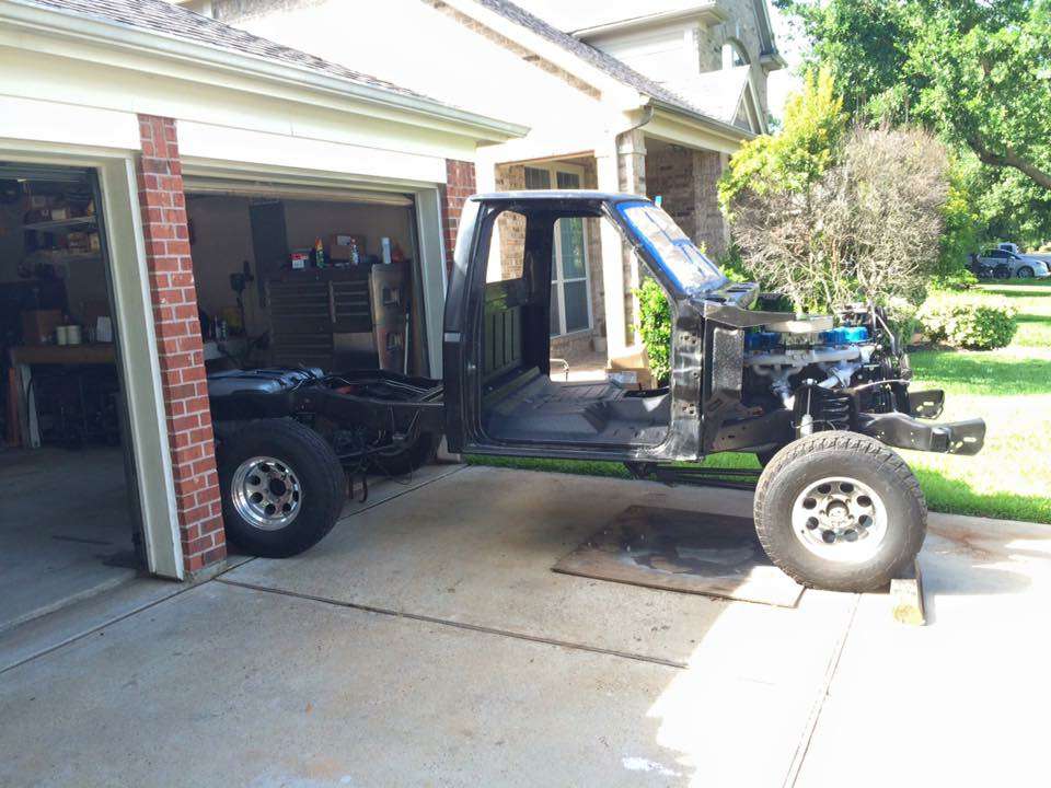

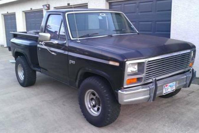

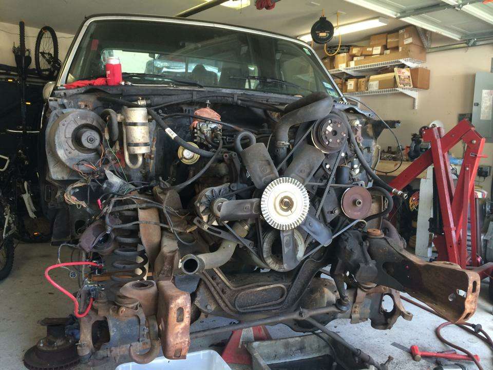

This is what we've been working on for the past year. 300, C6 (converted from 2wd), 208, 9" and D44 TTB.

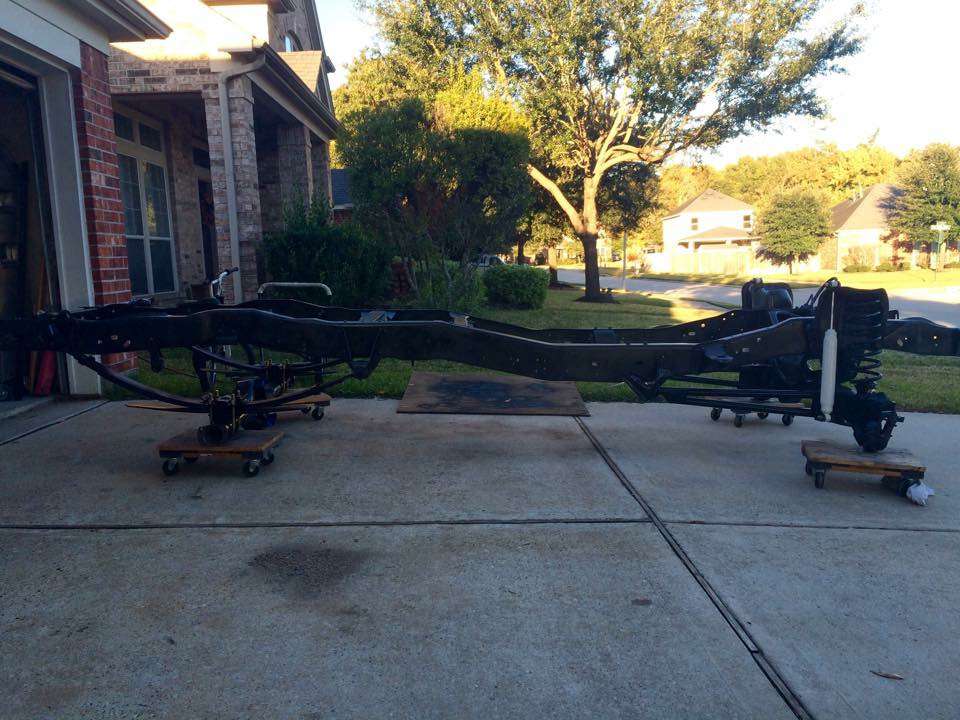

And more...

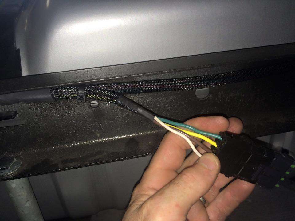

Even more...

Makes me miss my old step side pre runner. Nice work. Did you come up with the steering system?

damon1272 wrote:Makes me miss my old step side pre runner. Nice work. Did you come up with the steering system?
I did. Been thinking about that design for years. And it didn't work. I've already modified that set up. It's kinda ugly, but fixed the drag link rotation.
I also modified the beams by relocating the lower and upper ball joint tabs to accommodate the 2" lift coils. But... The upper ball joint nut hits the coil. So I'll have to rethink that as well. We made our own extended radius arms using the original mounting brackets mounted back by the transmission cross member. Also still have to make changes to the shock mounting.

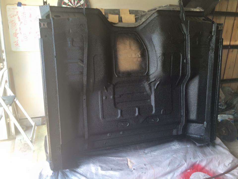

What did you guys end up lining the inside & underside of the cab with? I need to do that to my crew cab one of these years.

Thanks. We used Xtreme Liners. They're local, but I'm sure any of the off the shelf liners will do. Didn't use the ground up rubber that came with the kit, so the finish is bumpy without the grip tape texture.

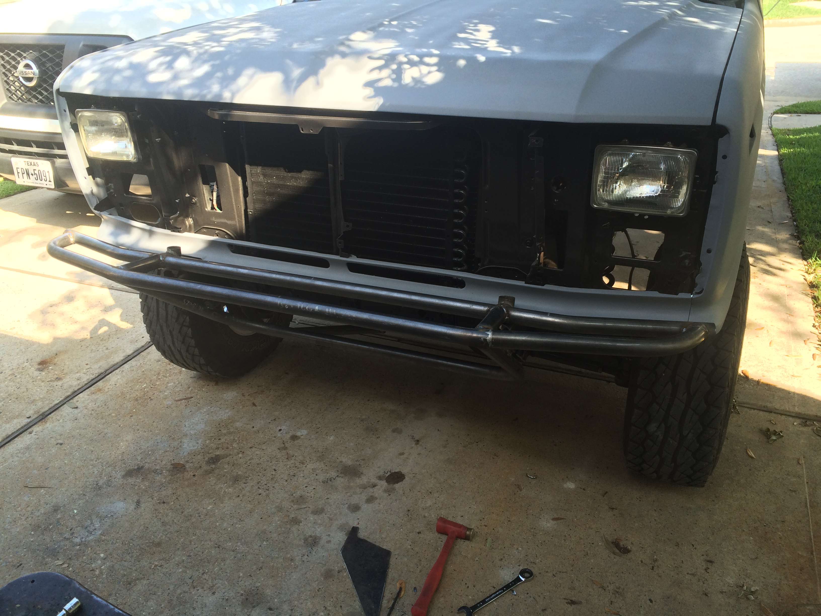

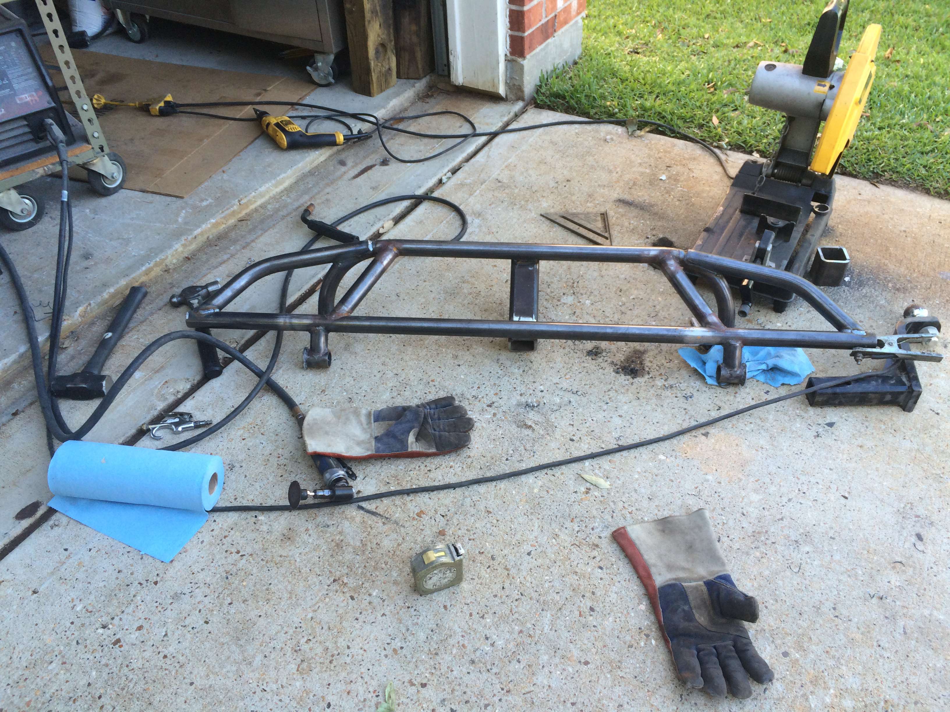

Since the flooding finally stopped, I got a chance to start roughing in the rear bumper. I post a couple pics in a moment.

Rear bumper roughed in.

Roughed in front bumper.

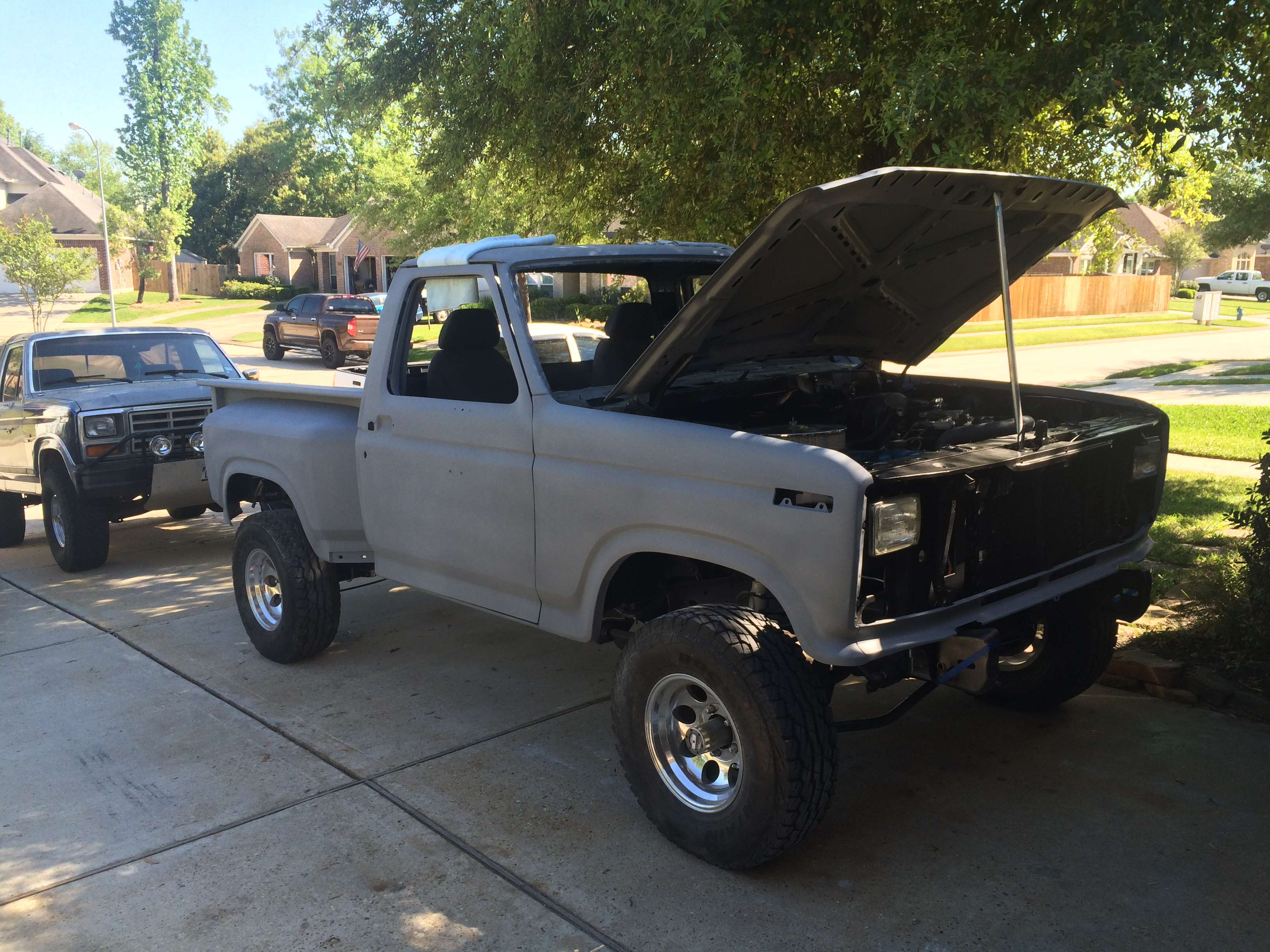

Not much. Been distracted by work, life and low motivation. We set up a makeshift paint booth in the garage to start painting.
So far we've discovered our weaknesses in paint application and are now perfecting sanding smooth poorly applied paint.
Hoping to have everything painted by the end of the month.
