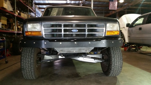

This was what the front bumper looked like when I bought the truck. ^
This is what I ended up building! Way cleaner!↓

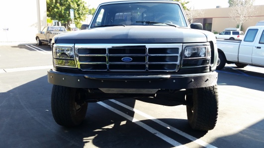

New Headlights and grill!

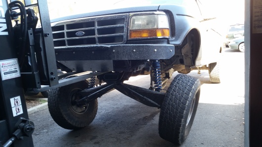

Strapped at 19". Trying to figure out new shock position to get more up travel and less droop. I can move the shock up and make bump 1/4" from frame(which will.get me about 3" more up). Running a 2.5"x12" coilover. Should I go to 14s???

I don't want droop! Haha. More uptravel the better. Which is what I'm working on. 60%up 40%down.

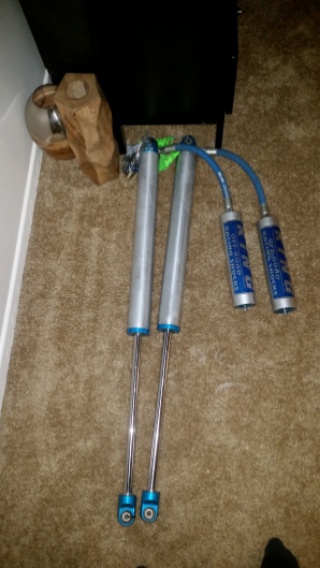

Got these for the rear until I can get my bypasses! Need to sell a bunch of stuff off my truck! Truck bed, tailgate, rear bumper, both fuel tanks, tow hitch...etc. I will post everything in the for sell section.

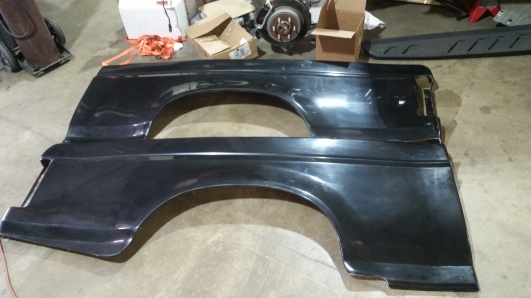

Picked up the final price of the puzzle today. Some Trailer Products bedsides! If my truck bed sells tomorrow my truck is going under the knife this weekend!

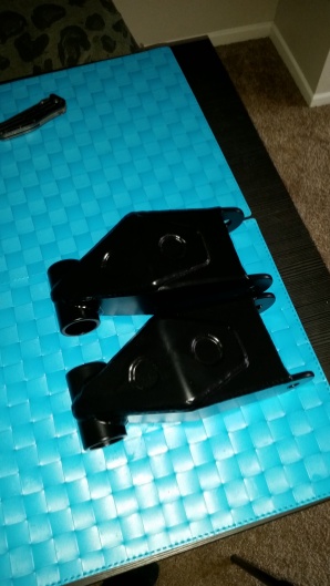

My 8" shackles I built... All hand cut 3/16" chromolly with 1/8" overlay. Powder coated satin black.
keenanduran1
Posts: 559
Location: Dana Point, CA
Re: 1996 F250 Prerunner Project
Post by keenanduran1 »
The shackles look great! Can't wait for this thing to be desert ready

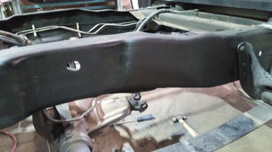

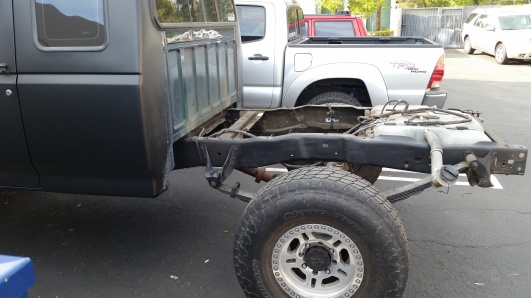

IMG_20160801_174723.jpg[/attachmentRear Frame section cut in half. [attachment=2]IMG_20160801_174817.jpg
24" taken out. Went from 155" wheelbase to 131".
Frame welded back together and plated with 3/16"plate and Rosette welded in spots for extra strength.
I also took the time to fill in all of the unused factory holes in the frame and sanded down. Way cleaner!
