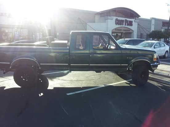

My 94 is going to go through some changes I have owned this truck since new it already has a superlift 4in kit and it has been patched and fixed a few dozen times ha. This truck has been great to me she rides soft now for what I use it for the name Marshmallow has been given to this truck awhile ago cause she is soft and spoungey (wore out)
I am wanting it to be a mellow Baja trail rig that is self contained for camping here is the list
Front susp:
cut and turned beams long radius arms
4.56 gears
12" coil-overs emulsion shock air bump stop
engine cage
Rear susp:
replace springs with super lift or skyjacker 2.5 lift
emulsion shocks air bumps and air bag helper spring
4.56 gears with a locker new axels
Front bumper:
hidden winch with 1 3/4 tube and skid plate
20 in Rigid light bar 4 duallies 2 amber and 2 white
tow hooks
Rear bumper:
13/4 tube with step and dual swing away tire carrier with rotopax gas cans mounted inside
(like on the new camburg Toyota ) added tail lights bottle opener of course and tow hooks
Bed area:
add camper shell 30 gallon fresh water tank front of bed, 12volt water pump outdoor shower mounted to the shell like the toy haulers have
2 sliding 6ft long drawers one side for tools and supplies the other is for camping and cooking gear (must have)the top of the drawers will hold small generator and large cooler roof top tent with changing room. side awning. 6ft table mounted under the tent rigid duallys at all for work lights.
Interior
5m lowrance gps 2 race radios updated stereo head unit and new speakers and sub
should be a fun trail rig and a place to sleep anywhere I would like and cook out with friends

got my camper shell scored $150.00 and has a track system on the top
