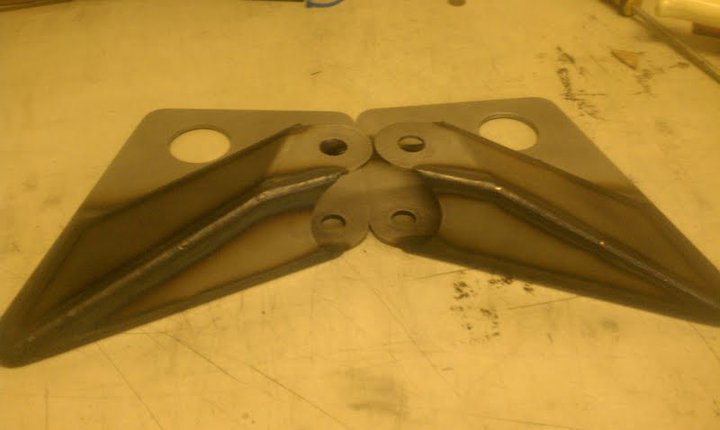

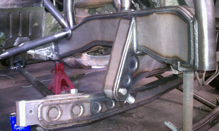

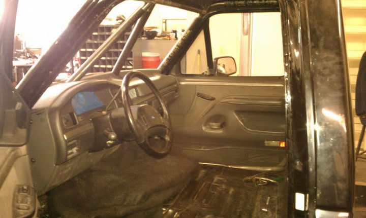

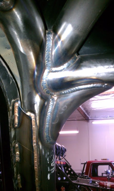

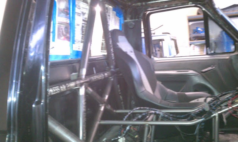

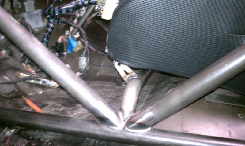

This is my Black Lightning project that I started in 2010, sold in 2011 and now continuing the build for the new owner. The idea is to have a race capable street legal prerunner while keeping the stock look of a lightning.
1993 Lightning
full 4130 cage front to rear
tig welded king pin beams cycling 24" of travel
tig welded TT trailing arm 4 link cycling 32" of travel
tig welded Blitzkrieg full floater housing
4.0 king kong shocks on every corner
Autofab front hubs
twisted stitch ts1 seats
wilwood brakes

sorry for the pics being out of order...
Re: Black Lightning

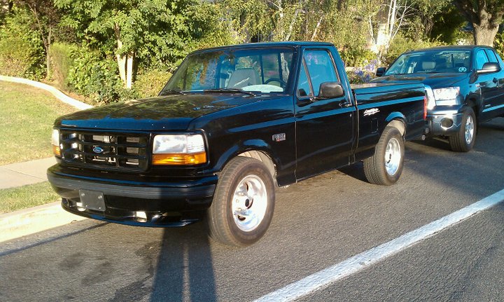

Welcome to the site! Way to make an enterance! Clean fabwork. Judging by the last pic, I would say you successfully kept the stock appearance! :lol:

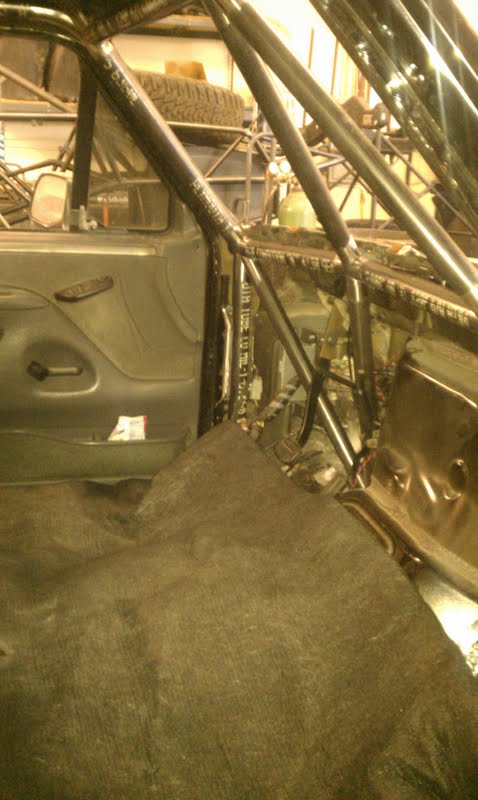

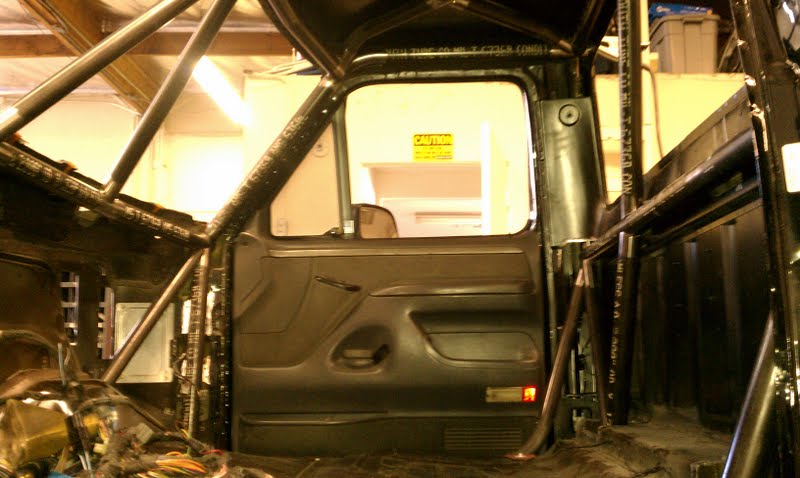

thanks, here is some more
Re: Black Lightning
X2, what he said. Nice truck!

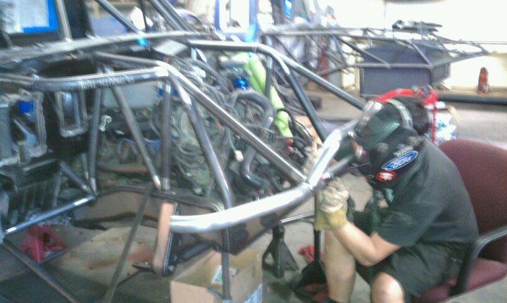

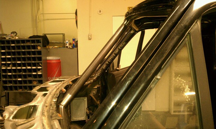

mas...

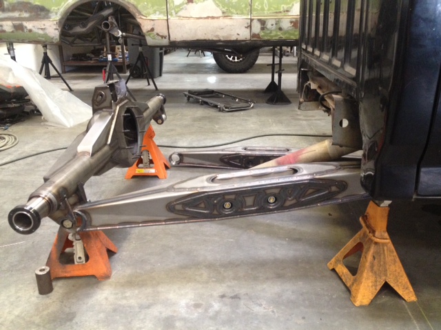

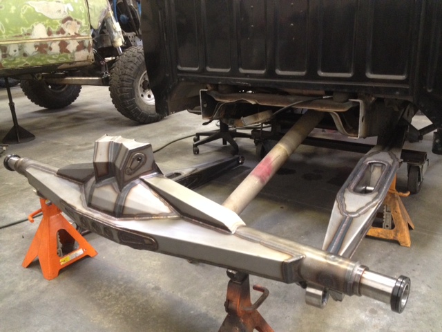

Rear Link arms and Housing, in the progress of designing the rear tube work
Re: Black Lightning
Truck is awesome. Glad to see you here man.

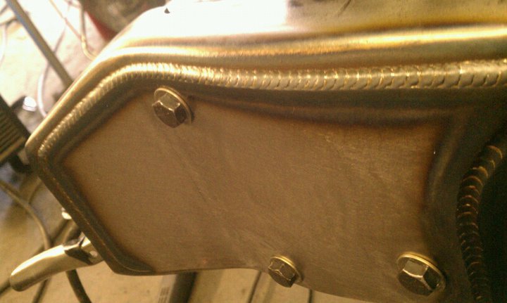

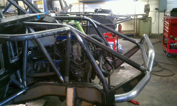

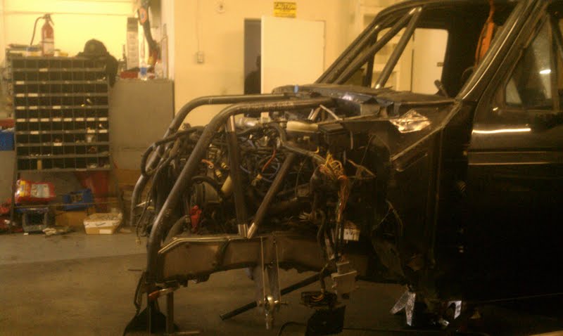

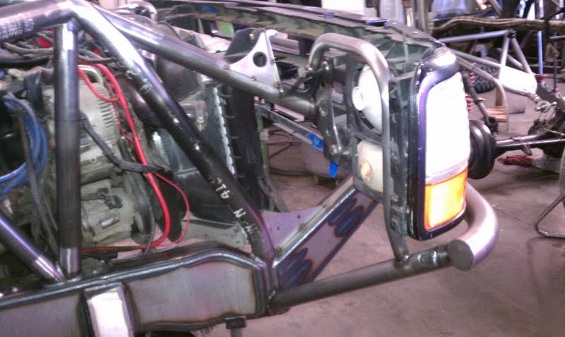

Great work. Beautiful welds. I really like the front end design, including how you cut the frame rails and tied in the front bumper. Well done. Keeping the stock dash for extra cool points. Welcome to the site!

There appears to be something large, 4 door, and mezzenined (is that a word?) in the back ground.... I can't make it out through the body work though...please give more details. Also more pics of anything you are working on!
