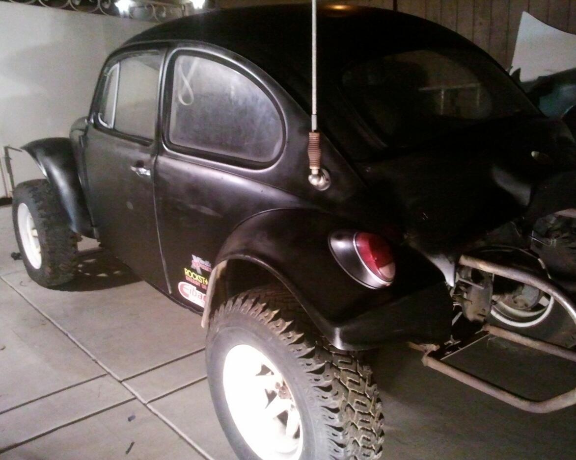

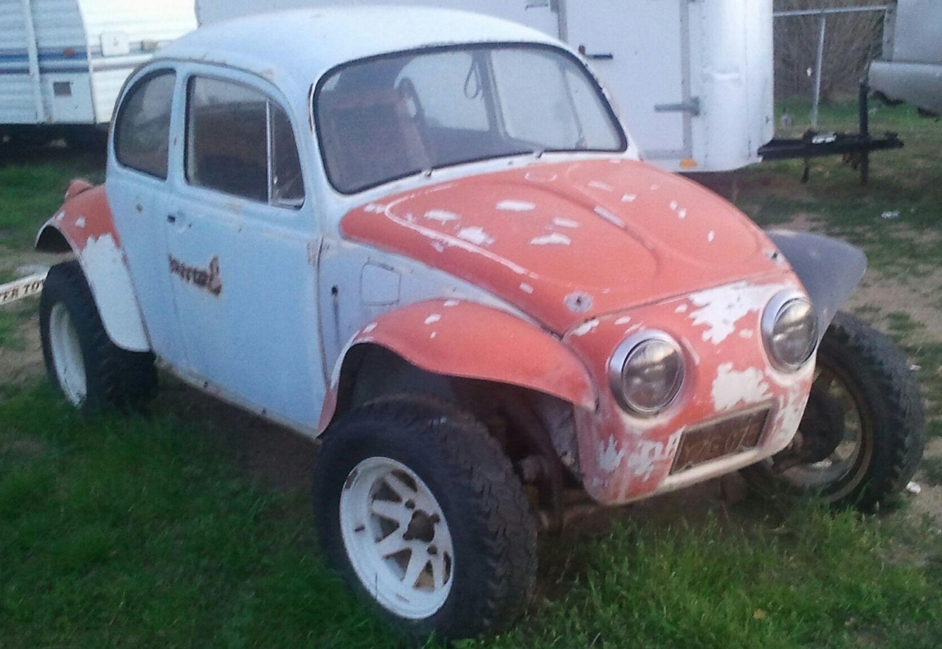

So here's the pile I crap I got for 500$, strangely enough 2 days later a friend called n said he wanted to build a baja bug. So I sold it to him for 700$, not too bad for a clean title black plate 68. So now he's paying me to build it for him so win win. Ill post progress pics as I can just for fun.

A little rattle can action and the dream was sold.

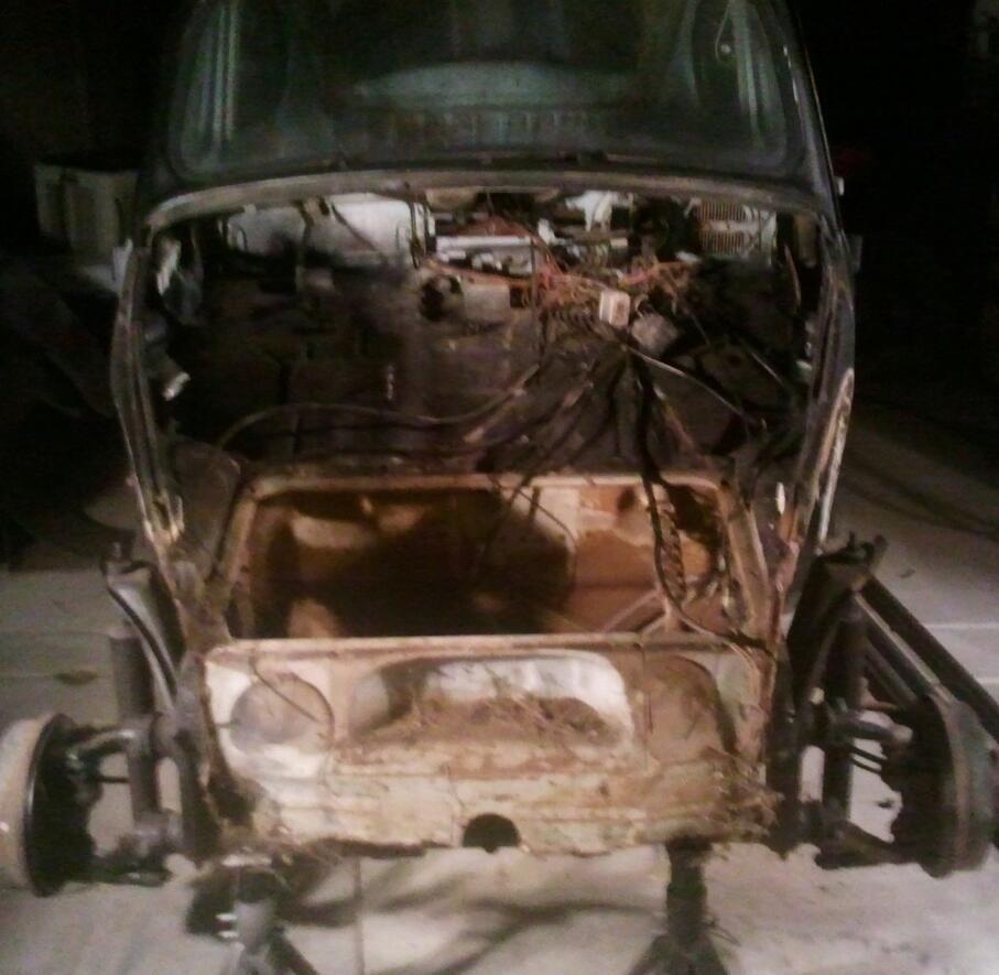

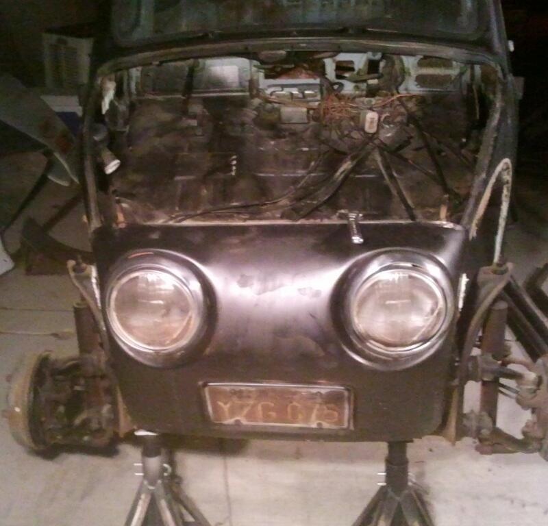

Then disassembly, and some saws all action. As my friend started to gather his parts list.

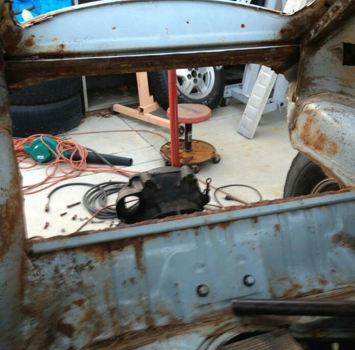

Rear firewall was pretty beat so I cut it out

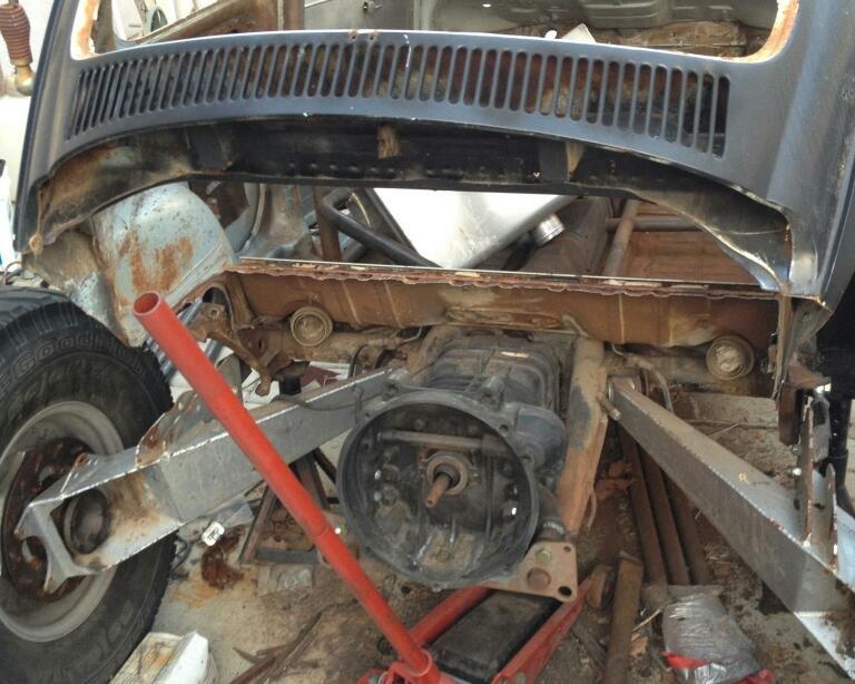

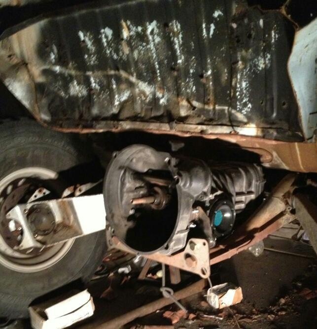

Also swapped transaxels to an 091 bus 6 rib.

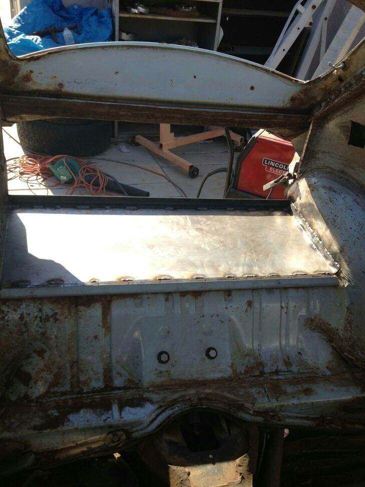

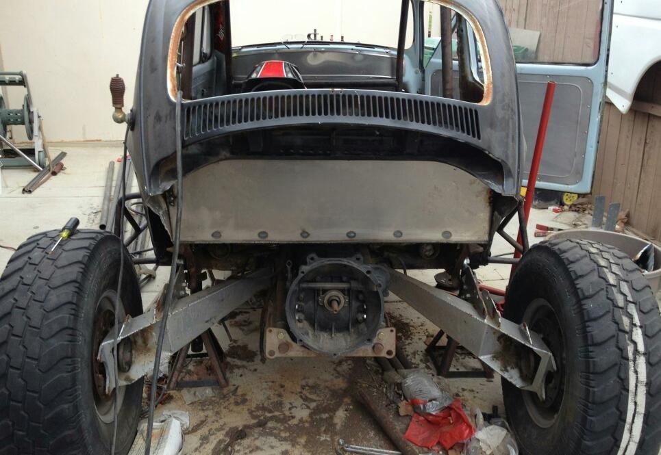

Replaced the rear floor.

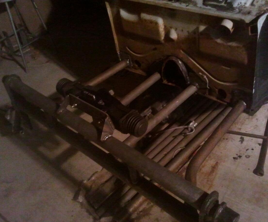

Started tying in the front cage and mounted the beam, stretched the wheelbase 15.5 inches and went 8 inches wider. 3x4 out back and 6 over beam with 3x4 arms.

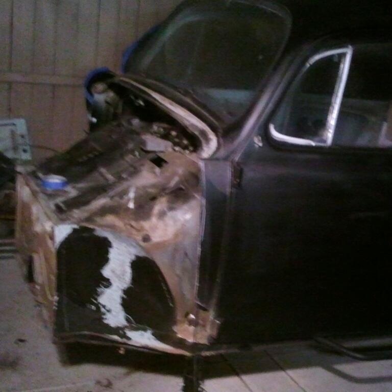

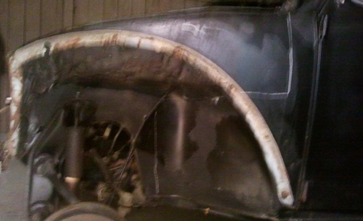

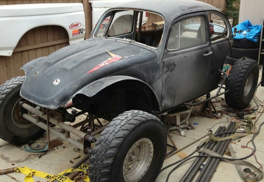

So basically you guys can see why my bronco project is stalled for a little while, as soon as this thing is a roller I can begin tear down on my own. In the pic I shaved the front fenders (rough cut) ill blend everything after I finish the front cage work.
