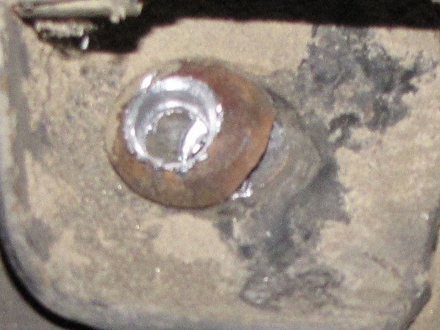

I started by center-punching the rivet heads, then drilled them out starting with 1/8" and working my way up to about 5/16 in a few steps. I don't drill them all the way, though. I only go just passed the frame rail and stop there.
Finally, grab your chisel and give it a few good whacks. The lower one was pretty fast. I counted about 20 swings of the hammer before the head came off. The back of the rivet fell right out. The top one fought me a little more but, admittedly, I did a much worse job of drilling that one... and paid for it.

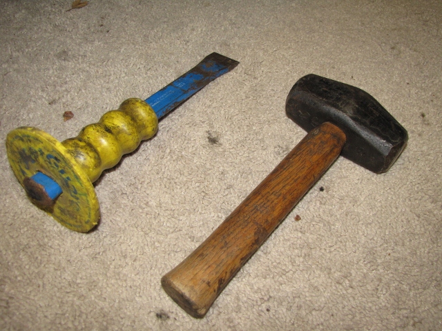

Tools of the trade.

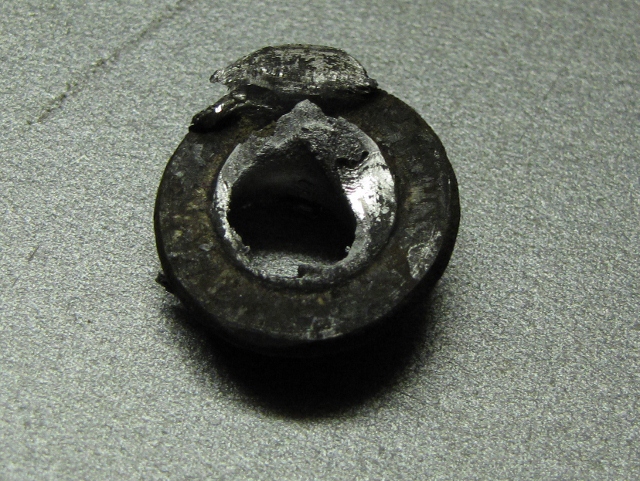

Drilled & cut rivet head.

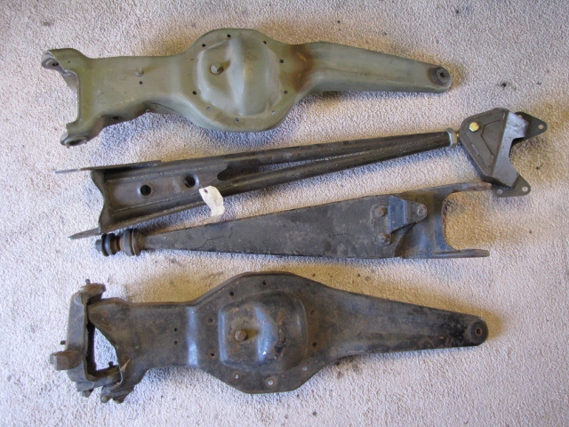

The previous plan... probably.
Tools of the trade.

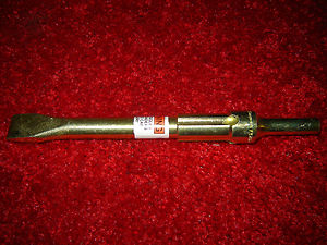

A quick note on air chisel bits.
I've always used a standard air chisel bit. The type that lock in so they won't fly out of the air-chisel but rotate freely. This time I used a non-rotating type... very nice. The standard type work well, the non-rotating type work great! They allow more control and don't come off your target as easily.
