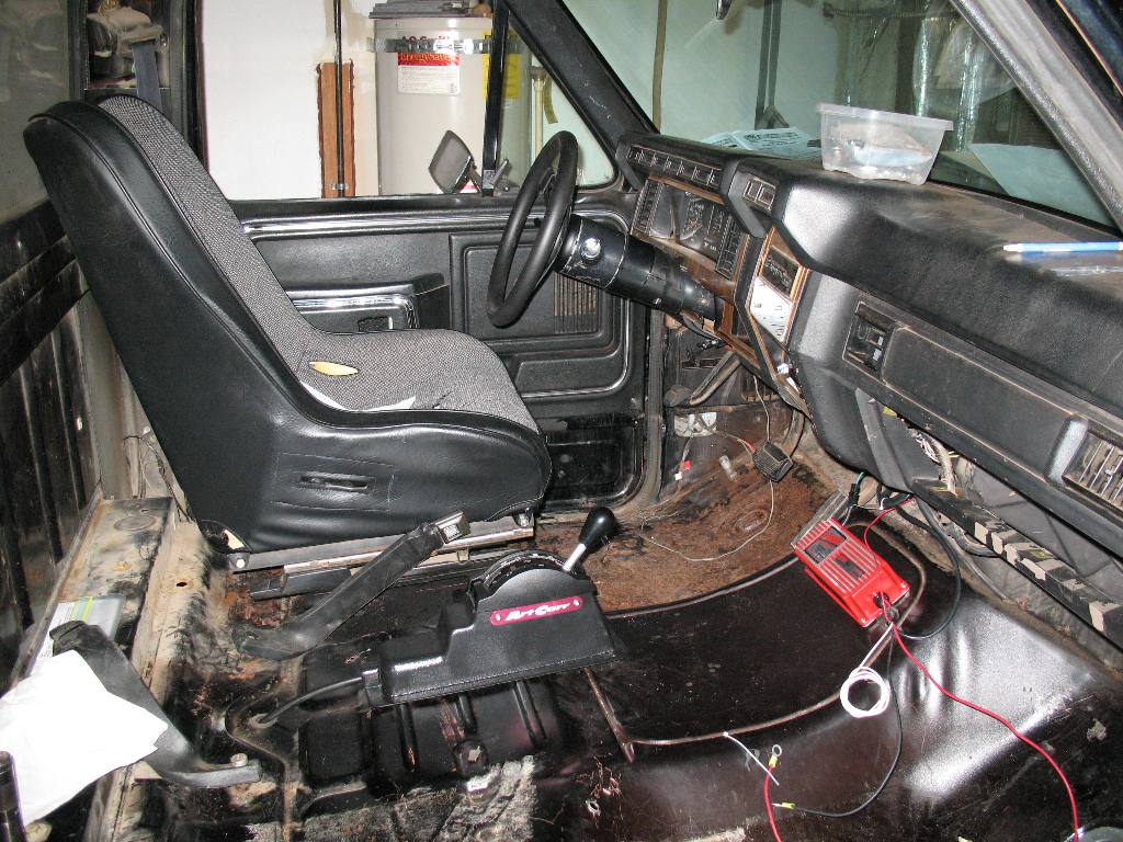

Here it is the beginning of the 1980 Flareside build.
The truck was pretty clean with no rust, slammed with a bad tranny and a 302 out of a 79 LTD. I swapped in a 1974 or so vintage 351W from Galaxy. The heads are stock, Edlebrock Performer intake, Edelbrock 600 dfm carb ,2 1/2" long tube headers.
This was one of those goofy trucks with a 5 x 4 1/2 bolt pattern and a king pin front end. I bought a bent beam set up from Auto Fab changing it to 5 x 5 1/2. It came with a 28 spline 9" which I swapped for an 8.8, 31 spline, 4.56 w/ spool rear end I had from my 83 Bronco.
Rather than try to explain to a local tranny shop what I wanted I bought a C6 with reverse manual from Art Carr. The 351 is in, tranny mounted, MSD distributor and 6A ignition mounted but not wired yet. The shifter mount and cable isn't finished yet. I had set of PRP wide, tall seats that are going in it. I'm pretty sure the back of the seats or my head will knock the back window out at some point.
I bought some 80 to 86 Auto Fab glass here in Portland for $240. I've always like that body style so I wanted to stay with that look. I'm still trying to decide whether to go through the bed with the shocks or stay under the bed. I'm staying with leafs. I've got a nice front bumper from my Bronco that was built by Nichols Fab in Tucson that is going on the front. Any and all opinions are welcome.

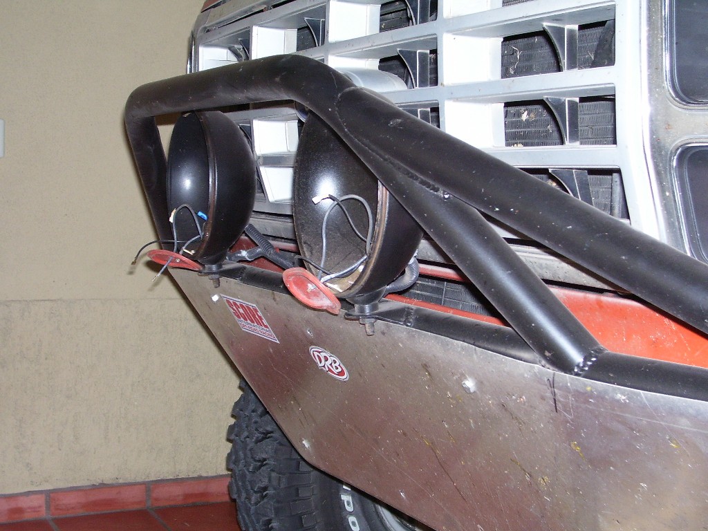

Here is a picture of the front bumper after both Super Oscar lenses fell out during the 2006 1000. Loctite is your friend.

Wow, nice truck, this is going to be a nice build... can't wait to see the progress! Bummer on the super Oscars... nice lights... errr, they were!

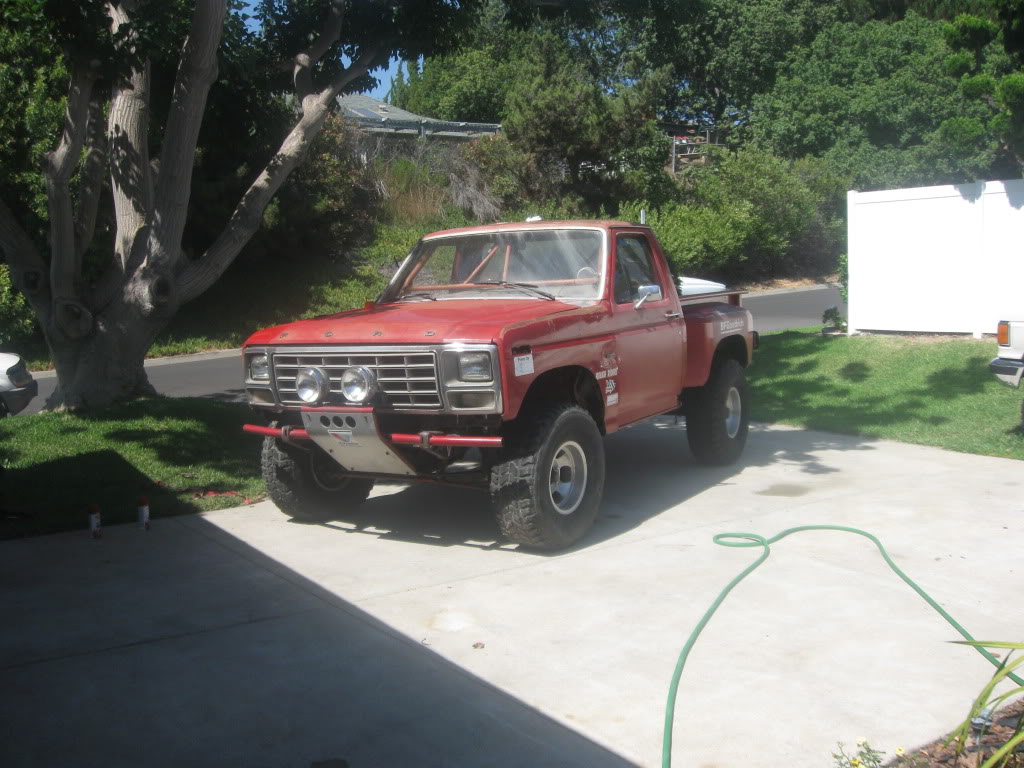

Does anyone have anymore pictures of this truck? I really look the look of it. I don't plan on painting my truck and will probably leave the fiberglass white.

That truck belongs to a kid on DR. He got it for free from a neighbor! He has a "build" type thread on DR. I don't think I saved any pics of it as it was built after '79 and not from '92-'96 so it's useless and ugly in my eyes

By the way is that interior a factory color offered on those early to mid Fords? I've seen that color off and on but I don't recall if that's a factory color.
Big Bastard
- Posts: 27
- Joined: Wed Jul 28, 2010 10:38 pm
- Bronco Info: Current build 1980 F100 Ranger Flareside, AutoFab front and glass, 351W PRP seats, rear end TBA
- Location: Vantucky, WA
Re: The Clapper 8
If you mean by factory "slightly rusty" yes it's 31 yr old factory. I'm pretty sure black interior was offered...if that's what we're talking about. He drives an Alfa and I'm the one being made fun of
