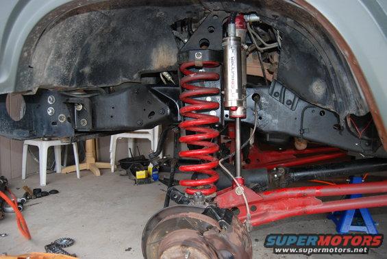

I'm running a 10 inch travel shock behind the spring.
Camburg coil buckets, rancho springs and radius arms.
Other than a bit of a problem with spring bow causing rubbing it works pretty well.
I also use limit straps to keep from over extending the shocks, leaves me at right around 12 inches of travel.
I use the front shock mount to mount the limit strap, and drilled the frame for the upper mount.

that looks like a solid setup.
what size coils are those, 4"?
so, maybe a set of the FOA 2.5 10" ?

Post by navynuke »
yes 4" coils, and F-O-A shocks have worked well for me in the past.
Like anything else, it has its bugs, but most of mine came from the camburg coil buckets and drop brackets, at least from what I can tell.

alright, so your running the 4" coils with a 10" stroke shock, and im running the 6", so i should go with a 12" or 14" stroke shock?
Posts: 4612
Re: Joxracing's Newbie F-150 build, Homemade long travel or bust
Maybe a 12" would be ok but not a 14".
