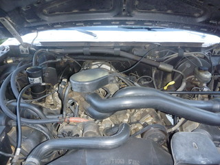

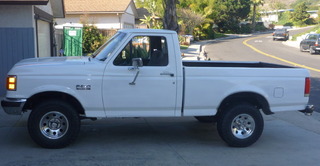

Here's some photos.
- P1010221.jpg (64.92 KiB) Viewed 48841 times
- P1010219.jpg (55.03 KiB) Viewed 48841 times
- P1010217.jpg (55.89 KiB) Viewed 48841 times
- P1010215.jpg (33.45 KiB) Viewed 48841 times

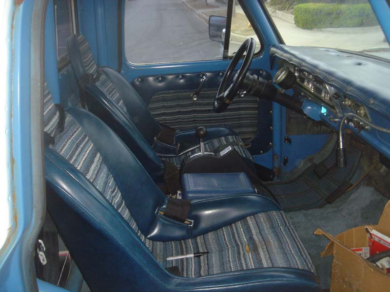

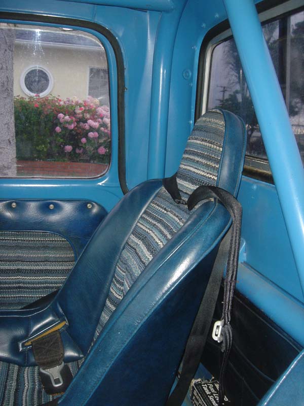

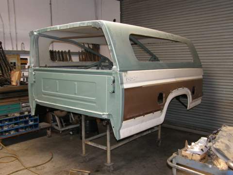

I'd like to throw my couple of cents in here if you wouldn't mind.
I haven't experienced any of your concerns mentioned with a cage. The truck is tighter and quiter. I have no issues with space (relatively speaking). The cab isn't impacted, but care was taken to push the cage tight against the skin and tucked up out of the way. We cut out the metal second skin on the roof and upholstered it with plenty of padding... I actually have more head room and it's very quiet (plus it looks great, it matches my seats!). I've step up the bed for camping, prerunning, chasing, et al. It works well for my purposes.
I don't think you'll capitalize on the full benefits of a cage if you only run the cab to bed connection below the bedline. If you're going to cage it, you really should do it right and bring the cage up through the top. I fit the shell by cutting the front out of the shell to fit around the cage and then flanged the front to the shell. It's a little bit of a pain to put back together, but it works great! All sealed up.
So, if you haven't guessed, I'd recommend the cage if you can afford the up front cost and the time it takes to build it. But, once it's done, you'll be thrilled, especially when you're down south on the second month of your trekking around to all of those hide aways. It really makes a HUGE difference.
If you have any additional questions and/or request any specific pics, just let me know, I'd love to help if I can.
I've use MileMarker hubs since 91.... they are still going strong, have never let me down and always, always work. But, I do understand that Warn is a great way to go too!SC150 wrote: -What brand/model of manual locking hubs should I get?.
Fiberglass properly mounted will not shake or rattle. My glass is just as solid as the original body work... So, it does make sense to me to add the glass for so you won't have to sacrafice travel. It'll pay in the end when you use your truck as you've described. John does make a kit, all the tubing is precut and bent. All you'll have to do is weld it.SC150 wrote: -Front fiberglass or no? I'd like to do a small flare just to make sure I don't have any clearance issues, but what am I looking to pay to have them properly mounted? My last bronco sounded like it was gonna come apart on the freeway. Don't wanna deal with that again. Does autofab make a kit or just provide instructions?
I went through the same decision process and put it off for many years. Jules and I spend quite a bit of time in Baja (camping, prerunning, chasing, etc). But last December the decision was made easy. After running the back side of the SF 250 loop, I noticed that my bed had decided to let go. I had cracks radiating down on both sides of the bed. When I took the shell off, the bed was absolutely junk. The front section had broken apart little by little, the shell was holding it together. Of course the concern for safety and the desire to tighten up the truck and tie the frame and suspension together to work properly were other factors.SC150 wrote: - Cage or no cage? I'm really on the fence about this one. As far as comfort goes, the cage is gonna suck (noise, space, etc), but I'm planning on really using this truck a lot in the desert. I was talked into doing the external B pillar to save cab space, but the problem with that is your not able to fit the shell on and have it be weatherproof (this is an absolute must). I'm thinking of connecting the bed cage and the cab cage below the window and bedline so I can use the shell, but not sure if that's gonna make the cage obsolete in the goal of making the truck be more rigid.

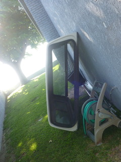

- fitting the shell
- fitting the shell 001.jpg (30.98 KiB) Viewed 48735 times
- Bed cracks
- Bed cracks 006.jpg (15.63 KiB) Viewed 48735 times
- Bed cracks
- Bed cracks 003.jpg (19.85 KiB) Viewed 48735 times

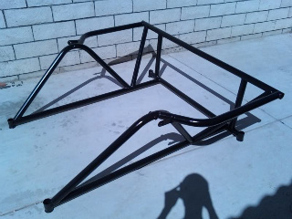

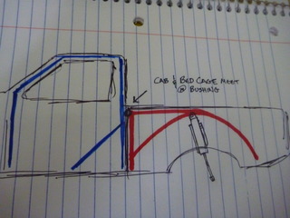

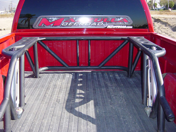

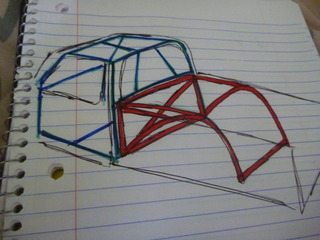

So, here's a few sketches and some pictures for a reference of what I'd like to do as far as the cage and bedcage go. I'm thinking of a bushing connection to tie the two together to cut down on noise. I'm also thinking I'd like to make the bedcage bolt in so if I decide to upgrade to a 4 link down the road I won't have to chop everything out. Let me know what ya think.
- bedcage20painted.jpg (41.98 KiB) Viewed 48675 times
- 049.jpg (79.21 KiB) Viewed 48675 times
- P1010384.jpg (57.47 KiB) Viewed 48675 times
- P1010386.jpg (55.08 KiB) Viewed 48675 times

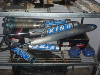

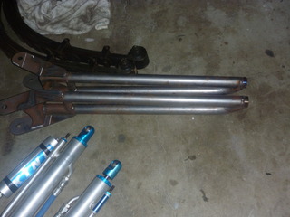

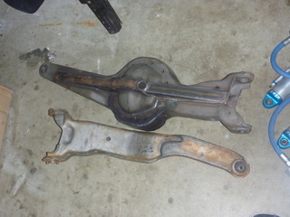

and some pics
This is a custom leaf pack. haha
Ill Keep posting pics as i go.

And this pic makes me think I can get a few more inches of droop out of my springs. It involves me either making a new shackle or a custom hanger though - so I am being a little lazy...mkiefer wrote:
Re: 1990 Ford150 4x4 "Bajamobile"
That is why Geoff makes the hangars from scratch. You know you could trim and reinforce the hangar to allow for more droop? Less work than building a whole new hangar.ChaseTruck754 wrote:And this pic makes me think I can get a few more inches of droop out of my springs. It involves me either making a new shackle or a custom hanger though - so I am being a little lazy...
I'm looking at that as well. Actually I have looked at it a bit already. I may do that, but unfortunately I am picky enough to not like the looks of trimmed stuff. IF I can make it look good I will do it. If not I'll spend more time building one from scratch. Is this a big reason why my stuff is never done - YES. I've said it before and I'll say it again - I am a PICKY bastard when it comes to fab. It sucks as if I didn't care I'd get my stuff running a whole lot sooner, but I just can't get away from some habits...
