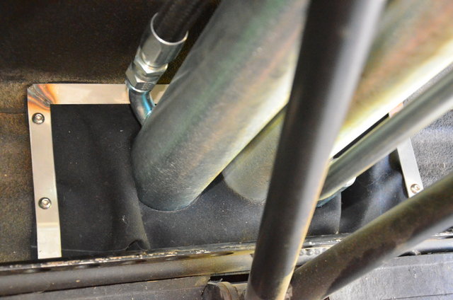

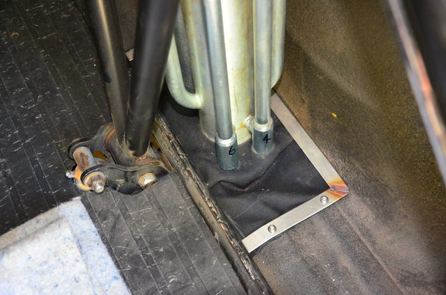

One of those very annoying aspects of punching the shocks through the bed is the hole needed to fit the shocks and to provide enough room for shock movement as it cycles though it's range from bump to droop. Especially since the shocks are next to the wheels, the interior of the bed collects quite a bit of dust as it's spun off the rear wheel and it billows up through the openings. After only a few short miles off road, the rear of the truck has collected a very heavy coating of dust and the dust obviously covers everything packed in the rear... just extremely annoying.
So, I thought I'd seal the hole to keep (most) of the dust out. I made a template to fit the shocks, to include the bypass tubes and brought it to one of the local upholstry shops. The guy at the upholstry shop cut out the holes to match the template and sewed a hem around the holes to contain the stress as the shock moved around and to avoid ripping the material. We used a heavy canvas material, the same used for convertable tops.
I then made a small stainless steel frame to screw the canvas down to the bed to contain it. I had to ensure I have enough fabric folded up within the frame to allow the shocks to move as they cycle.
The first picture is just to illustrate the hole and how big the darn thing is. The second and third are look down views of the seals around the shocks.
The first run was this morning out at Plaster City during my shock tuning... and I must say, it worked absolutely fantastic. I'm used to getting a good heavy layer of dust, just in those couple of hours of testing. When I got home this morning, the back was essentially dust free... looks like it works like a champ!

Awesome Tom! I always hear people complaining about the dust, and this seems like such a relatively simple solution.

Becks_Bronco wrote:Awesome Tom! I always hear people complaining about the dust, and this seems like such a relatively simple solution.
Thanks Will... we will see how it works out in the long run. Of course, I am a little concerned about heat as the shock gets hot, but we talked about the different materials available and what would take the heat the best. When running out at Plaster City yesterday, it didn't seem to bother the canvas at all... and I got the shocks nice and hot... although I didn't bring my IR thermo.

Nice Tom. As always your attention to detail on things like this is just great.BajaF250 wrote:snip...
