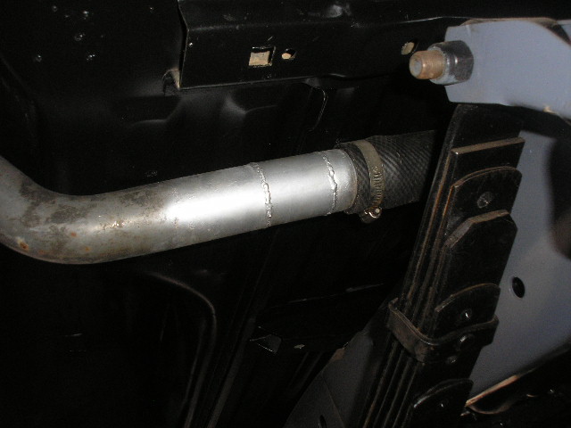

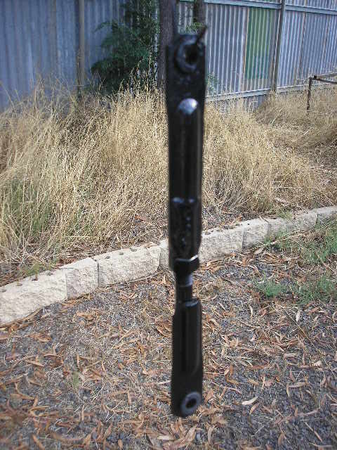

I;m using an AOD mated to a NP 208, so the hi/lo lever connector is either too long or too short. I picked the forward mounting boss and lengthened the connector, making it adjustable for later fine tuning:
I also made a mount for the LPG convertor (propane) to mount on, but after fitting it, I have to reposition the fuel pressure reg mount as it hits the water hose fitting:

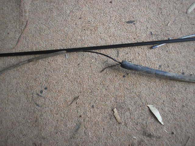

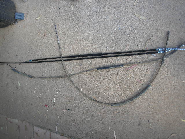

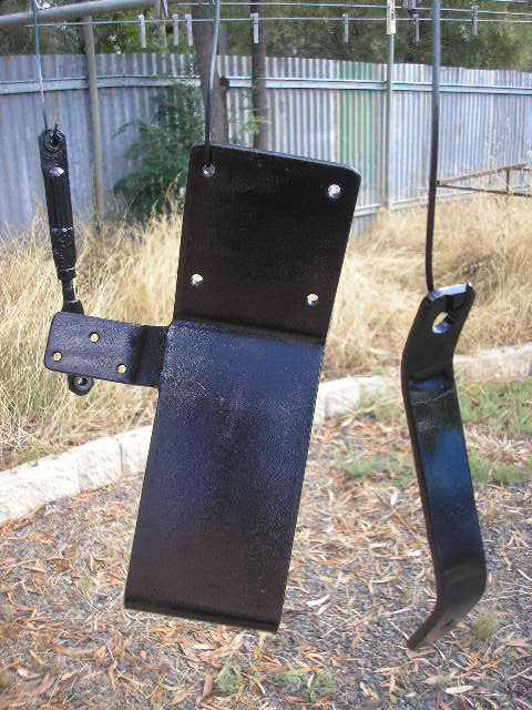

My new Bruin park brake cables also arrived. The long cable is stuffed, the short one is tight, so I replaced both:
This is what happened to the long cable:
Both are fitted, I just have to clean and reinstall all the brake parts and new wheel cylinders, pipes etc and a few other things and the rear end is pretty much done. Unfortunately, the camera batteries died, so I'll have to take more pics tomorrow night. I also made a coil mount bracket, a heater hose support, and I have a Propane filler point under construction to fit into the front fuel filler box. Just waiting for the hoses and fittings to finish off the PS lines/cooler and trans cooler lines, etc.

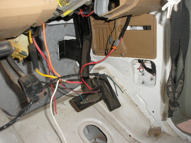

I traced and connected the propane harness to the EFI section of the rear wiring to activate the rear in-tank pump and gasoline lock off valve together when PET (petrol/gasoline) is selected on the C/O switch:
I made an entry plate for the clutch master cyl hole to allow the extra wiring a water tight and neat entry point:

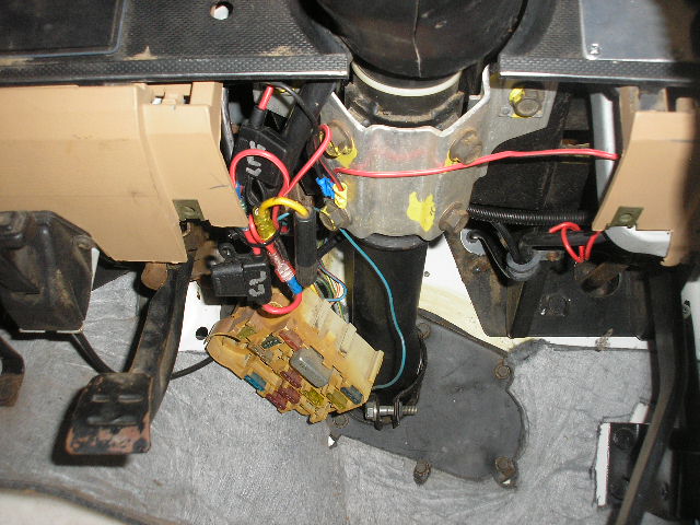

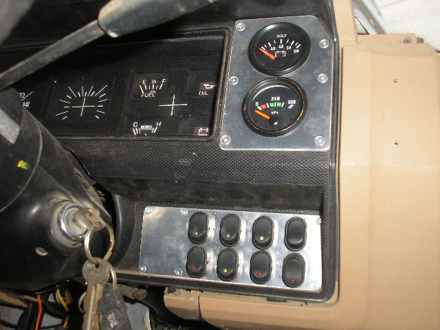

Later, before it got too dark, I was under the dash, making up the connection point for the volt and oil pressure gauge plate and the switch plate:

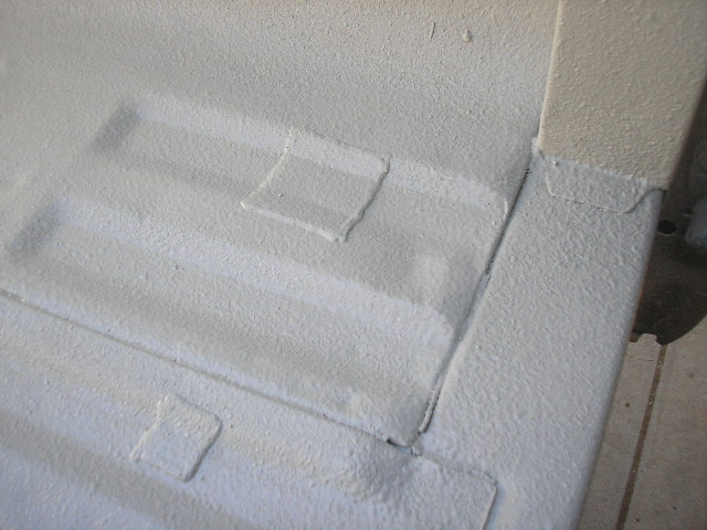

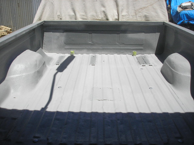

Today, I cleaned up a bit and rolled the baby out into the sunshine, cleaned out the tub and laid on the rest of the poor man's bed-liner (stoneguard). Too bad the colours are different, but it will be painted later:
Nice textured finish:

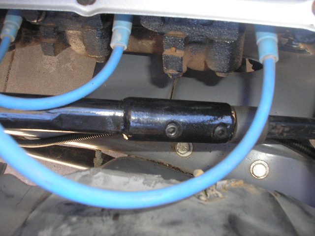

I also re-installed the connector shaft in the steering. I had to do a modification, as the plastic insert for the collapsible section disintegrated and was sloppy. I made a sleeve, which was drilled across, then welded over the oval outer and plug welded to the flat sides. I then drilled carefully through and tapped to M8 for grub screws. The plastic shim I discarded and made some new shims from hi-tensile wrapping strap and it works just fine. I know it wont do for general use, as the frame and body flex will cause issues, but it should get me past rego inspection and then I can save for a new shaft ass'y:

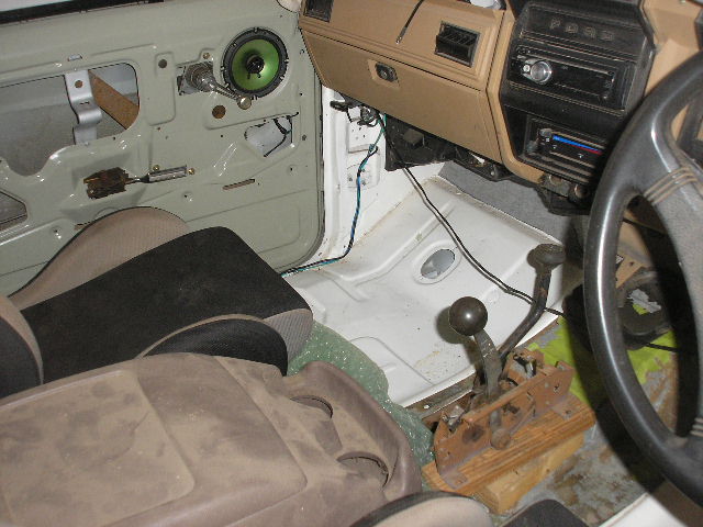

The last week I have been collecting a few bibs and bobs to fill in the work list and spent a good chunk of yesterday and today finishing up the wiring. I ran the co-ax through the interior light hole out to the hole in the roof and installed the base, then threaded the co-ax down the left B pillar along with a spare wire beside the int. light feed.

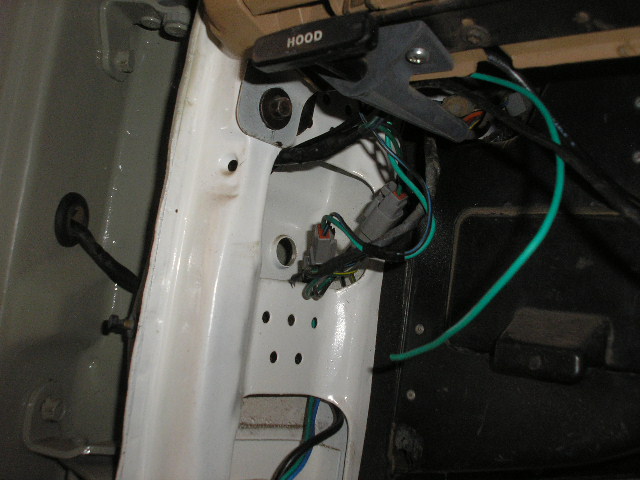

The LH door got wired out, Deutsch plugs for all the connections inside the cab A pillar and for the speaker and CL motor. Once the wires were tied up I installed the int. light and it lit up. I found the door switches a while ago and cleaned them up for install. Now when I open the door(s), the cabin lights up at night. :D :D
The central locking played up, but after removing a couple of loose un-needed terminals from the control box plug, it came good and got connected via the hot wire on the brake light switch at the pedal. Now both doors unlock with the key from outside or inside. Then I attacked the mess under the steering column. I changed a few different wires around, built/soldered up a multi connector and hooked both the new gauge plate, switch panel and Propane change-over switch up to ignition hot side. The change-over switch needs a few wires juggled (my dyslexia confused the colours) to make everything work correctly, but now it all functions as it should. The gauges work and the switch panel will work after I connect 3 more wires tomorrow night.

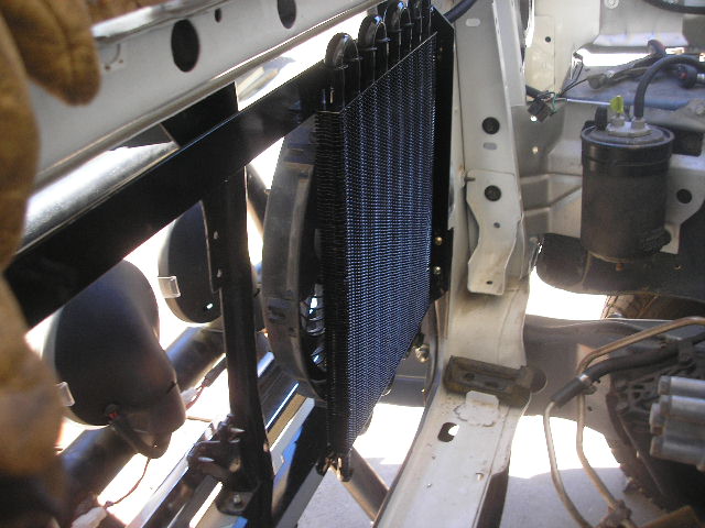

Then, I made a hose bridge on the trans for the cooler (the Ebay company in CA jipped me on my fittings and hose) so they will be delayed (problem now solved) soat least I can run the engine without fluid going everywhere. 6 litres of Mercon later, jumper cables afixed from the Triton and some ether down the carb, and VROOM! away it went, for about 3 seconds. So, a month short of 5 YEARS, it lives again.

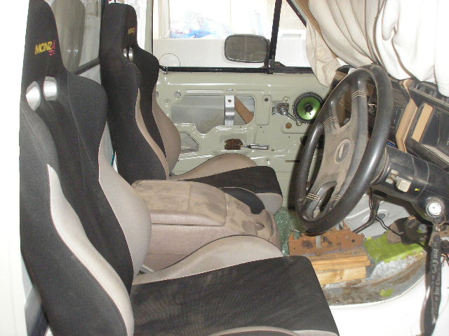

Mocked up the interior/seats etc. to see how it looks.

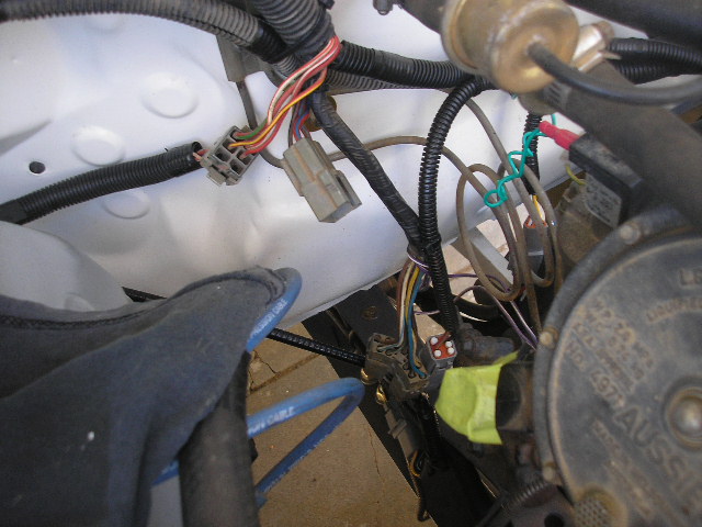

Wiring, etc:
New switch panel and gauge panel (will paint them this week):

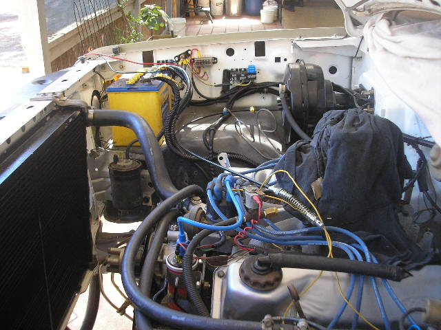

Engine bay wiring almost complete:

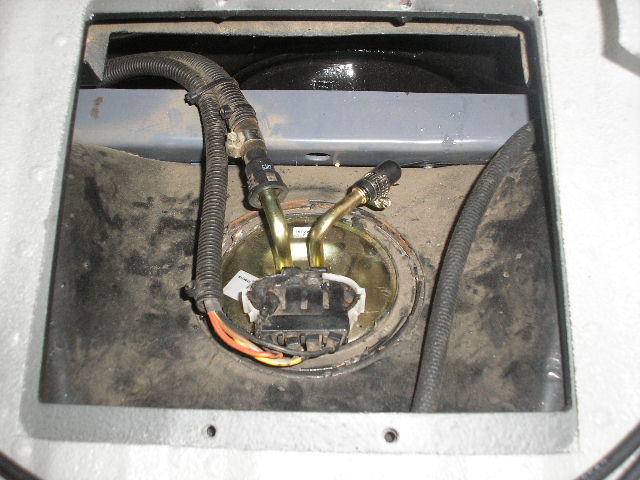

Today at work, I extended the filler tube and installed it. Next was the fuel pump assembly, a little grease to hold the O-ring in place and the locking ring went in easy. I've capped the return nipple temporarily 'cause the sender needs to be replaced with the correct version and poured in 20 litres of unleaded. I jumpered the gasoline lock-off valve to the battery direct and removed the hose just prior to the valve to purge and flush the line. Just as well, because out came mud and a wasp larvae that had been deposited in the regulator outlet fitting, prior to installing the hose. that would have wreaked havoc on the carb jets and passages had it made it's way through. I ran about 2 litres through before re-connecting the hose to the carb lock-off valve and priming up the carb. With the Holley reg on the in-tank EFI primary pump, I'm getting about 3 psi. A couple of pumps on the throttle to fill the accellerator pump and squirt some gas down the throats and I hooked up the jumpers and turned the key. Two turns of the starter and she roared into life, almost stalled, then settled down to a fast idle at around 1100 rpm. A quick twist of the idle screw set it at 950 and it sat and idled nicely with a beautiful lope. It's currently running direct from the sedan manifolds, so I can't run it long unless I want to melt the wiring and fuel line on the LH side rail. I give it 30 - 40 seconds and shut it down, very pleased that it runs on gasoline now and IT LIVES! I'll post pics tomorrow of the filler, etc. Pick up the manifolds at the end of the month. make a Y pipe, etc., driveshafts, brakes, shifter and seat mount(s) and maybe I can drive it mid next month.
WOOHOO! :D :D

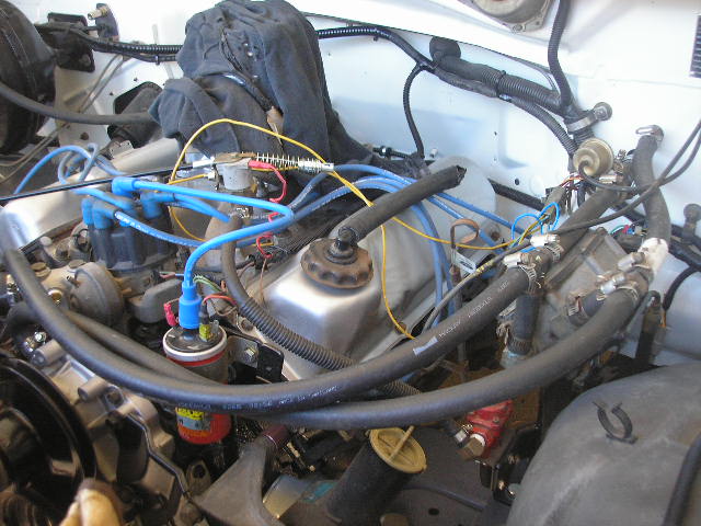

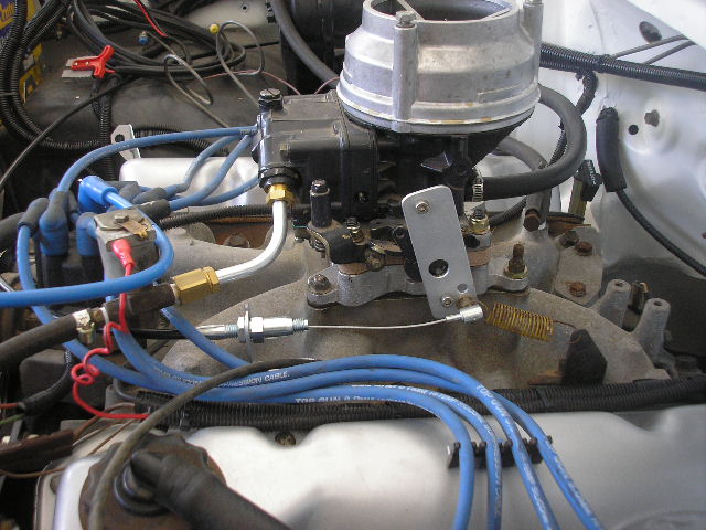

It's definately alive now. Yesterday I grabbed the V belts I needed, a radiator cap, 3/8th fuel hose (for p/s return) and made a throttle cable bracket and a throttle lever adaptor for the carb and last night and today, fitted all the bits. Poured in some hot water, topped up the p/s and did a quick check and fired her up. I ran it for about 10 mins, to warm up and fill the power steering, see if I had any appreciable leaks and to just hear her going. :D :D I can't get enough of those aromas,the scent of raw burnt unleaded, the smell of oil on hot metal, coolant evaporating on hot surfaces and the general smells of a new set-up bedding in. HEAVEN! When I blip the throttle, the body torques over and it sounds glorious, this powerplant will boogey. I'm just waiting for lunch in the oven, then I'll go out and tidy up a few more loose ends. Some pics:

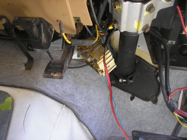

Still need to secure the fuse box, but much tidier now:

Fuel pump installed:
Throttle cable mount and lever in place:

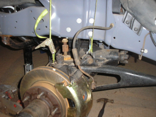

Put it up on stands and cleared the area:
Ratchet "limiter" strap to hold the beam up:

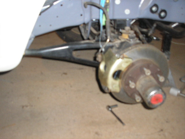

Rh front done (I need to re-clock the hose at the chassis to make sure it clears the tyre on lock):
LH front done:

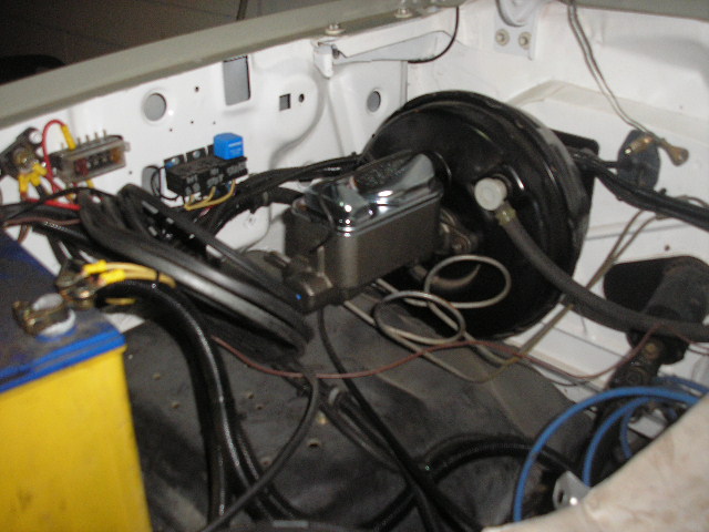

Master cylinder installed:

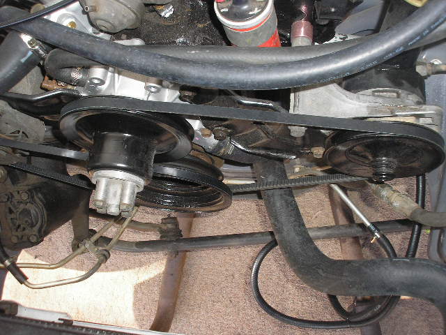

From the weekend: Belts and p/s hose installed:

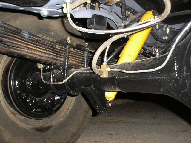

I fitted the rear brake pipes and the DOT teflon hose to the diff. It took a bit to find a spring clip for the hose to chassis, but I scabbed one of a wreck up the back yard. Everything went together ok, and I had to clean out the diff breather hose due to a wasp nest inside. The little fuckers will stick mud and eggs into ANY opening and sometimes they are not apparent. Hence, I have to tape any open pipe or hose during the build to keep the bastards out.
Pipes and breather sorted:
Luckily, I had a bottle of Dot 4 fluid, so I started bleeding the brakes. I used the old m/cyl's cover to make a pressure bleeder and it worked just fine. That and length of timber to hold the brake pedal down in between bleeds made short work.

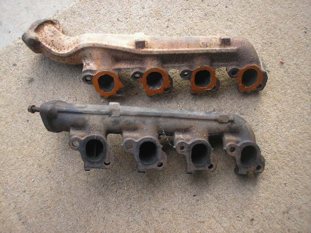

Picked up the manifolds this morning, and a fabbed Y pipe that eventually wont be used. Also got some factory spring blocks and U bolts to try. LONNG day today.
Manifolds and Y piece:
The aus car LH manifold is a little different:
The Y pipe actually uses the Bronco LH manifold and a pass car RH manifold, and would have fittted, but the RH manifold has cracks in it and the cross-over hits on the AOD oil pan, so the correct one had to go on:
The difference of RH car and F150/Bronco manifolds:
