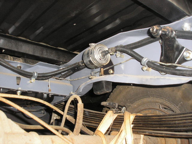

Pics of the fuel system work: Parts pile for cleaning/fit-up: Refitted the front rad support to make cooler mounts, cooling fan mounts, etc.: Oh, I made a flat bet for the Triton, too. It's been on about 2 years now, and I love it. Compact with hide away tie down points, etc.: More updates to follow.

Haven't done a lot on the truck, but I've basically completed the wiring for the truck, the lights, wipers, etc. all work. I just need to lay out, cut & shut and re-solder the engine harness, wrap it and secure it, clean and fit the carb and adaptor, start on the propane system and tie up a shitload of loose ends. Tonight, I've been on a finding mission, trying to locate all the remaining parts so I can continue on while I wait for a heap of items from Ebay and USA, etc.
T/case ready for final clean and fit: Heap of parts laid out ready to be processed: Carb and adaptors: Propane conversion stuff: 9 inch centre and parts: Brakes stuff for front and rear: Trying to focus on getting in at least 2 - 3 hours a night when time/schedule allows. I will have to make a jumper hose for the trans cooler, as I am waiting for fittings and hose from o/s. By next week it will be a go-er (I hope).
