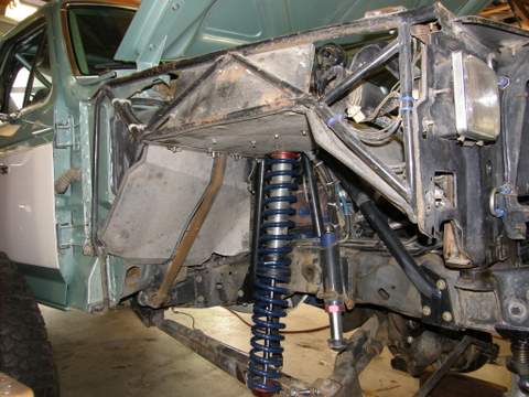

Tony,
This is a shot of the core support structure and wheel wells. I used John's Bronco kit and modified it to fit my truck. I also added additional x-bracing and mounting points for all the "stuff" under the hood. The wheel well panels are stiff enough to use as mounting points as well. The only issue with mounting to the wheel well panels is you have to remove all mounted items before you can pull the panels.
Front core support mount and inner wheel well.
front end refresh 003.jpg (42.24 KiB) Viewed 3076 times
