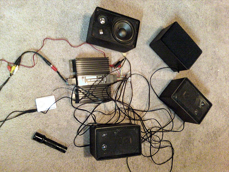

I've got the audio system just about done for the Falcon. My younger brother hooked me up with a slightly modified O.E. amp out of an Explorer with the JBL system. It's now wired for RCA inputs to run off an ipod and even has a subwoofer output and switched 12v output to turn on another amp (for the sub). The speakers and enclosures are leftovers from an old surround-sound system my boss was throwing out. I replaced two of the speakers with a pair I bought years ago for my old Camaro and never used. I was going to replace the others but they sound good enough as-is, so in the end I'll have zero dollars into the "system", which is exactly what I budgeted for it!
I originally wired into the stock radio knob on/off switch to turn the amp on. I also wired it so the radio dial light would turn on when the amp was on. When I was all done the switch took a dump... lame! Sooo, I put a somewhat hidden toggle switch under the dash.
The last thing I need to figure out is how to do FM radio. I'm thinking about a new nano ipod (they have an FM receiver) but I don't know how good the reception would be in the cab.
Falcon Audio.jpg (229.79 KiB) Viewed 1942 times

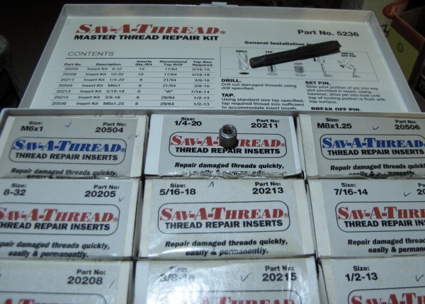

Once again I spent more time thinking about how I didn't want to fix something on this car than I did actually repairing it. I've been putting this off since I replaced the valve seals and found this boogered up bolt-hole in the head.
I've had this insert kit for several years now and finally had something to use it on. It took a total of about 25 minutes from start to finish including clean-up... cool little kit. I might have to throw it in the Bronco for long trips.
The lock is not yet installed in this picture.
VC Thread Repair.jpg (224.17 KiB) Viewed 1942 times
Save-A-thread Kit.jpg (101.36 KiB) Viewed 1942 times

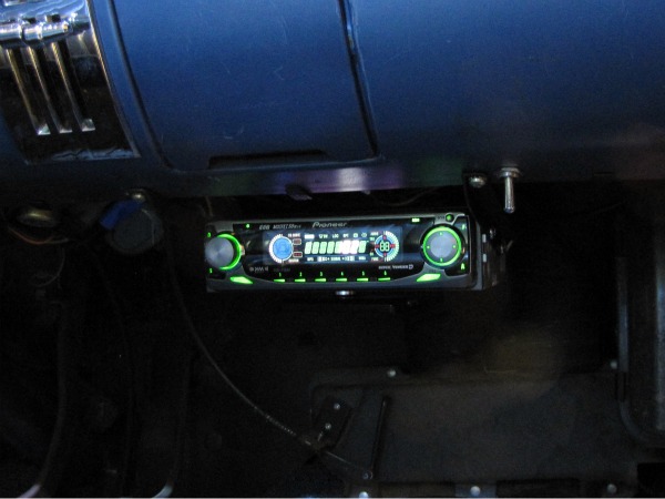

The audio system in the Falcon has been upgraded dramatically. I was able to salvage the Pioneer deck with remote (score!) and an aftermarket power antenna from a car that was headed to the wrecking yard.
The deck install is done. I was able to mount it under that dash where I can reach it but put it far enough back (with the rear of the radio angled up) that you can't see it from the outside. And, it actually sounds pretty damn good! Especially considering I have zero dollars invested so far. I need to order an iPod adapter for the deck ($15) and I'm considering an $18 6.5" subwoofer (Amazon) to mount in the rear of the car. The left rear panel in the cargo area is missing so I already have to make one. Maybe I'll just put a speaker hole in the panel while I'm at it.
I still need to mount the antenna but that's going to require removing the fender and a bit more motivation.
I also want to install an overhead video monitor for the kids. We're hoping to drive the car to the Billetproof show in Antioch next year, so some additional entertainment would be nice to have. It's gonna be tough to come across one of those for free, though.
Under Dash Radio1.jpg (64.94 KiB) Viewed 1896 times

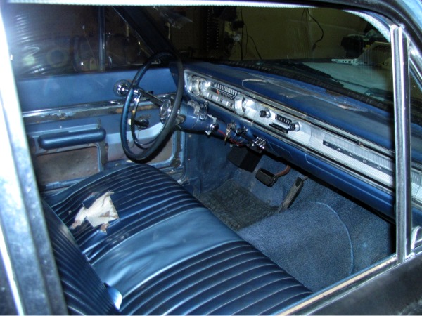

The passenger side of the front bench hasn't locked since I've owned the car. With a passenger in the front seat, it would move fore and aft at every stop and go. I pulled the bench tonight and as with most repairs on this, it was a piece of cake and required no parts. All I had to do was relocate the return spring for the latch and adjust the crossover cable for the release. I bolted it back in and it works perfectly.
The seat cushion will definitely need parts, though. Most of the "S" shaped springs under the driver are broken. A prior owner attempted a patch but did a terrible job of it. I might be headed to SLO tomorrow, so I might stop by an upholstery shop to see about parts and get an estimate to put a patch in the torn vinyl.
This is what 46 years worth of ass will do to a seat.

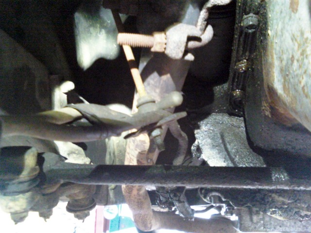

Oh man, you have no idea! Whoever did all the "Patches" on this car was a genius at improvised repairs. Some of the stuff is hilarious. The funny thing is how little work it took to remove the patch work and mount stuff as intended.
One of my favorites is the water spigot handle, all-thread rod and I don't remember what else to hold the trans cooler lines. It mounts to the strut support at the top of the engine bay and extends down to the cooler lines... a thing of beauty! That one is still there and holding up well.
Re: 65 Ford Falcon Squire Wagon
My favorite example of repair genius on this car is hands down this water spigot handle and rod that attaches to the strut brace. I haven't gotten around to replacing the trans cooler lines, but I like this piece so much that I think I'll reuse it when I do.

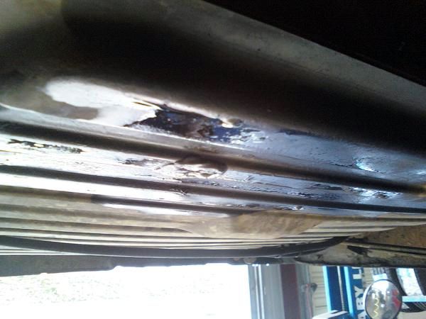

In other news, the gas tank is leaking. It had a patch on the bottom when I bought it. I didn't like it but it was sealing so I left it alone... time to fix it. Fortunately, the tank is super easy to remove. Of course this didn't happen until the tank was completely topped off.
Leaky Leak.jpg (41.64 KiB) Viewed 1758 times

SteveG wrote:In other news, the gas tank is leaking. It had a patch on the bottom when I bought it. I didn't like it but it was sealing so I left it alone... time to fix it. Fortunately, the tank is super easy to remove. Of course this didn't happen until the tank was completely topped off.
I bought a replacement tank for our '59 from rockauto.com for less than $200. I've welded and brazed tanks before but I think I'd build a new one if a replacement isn't available.
