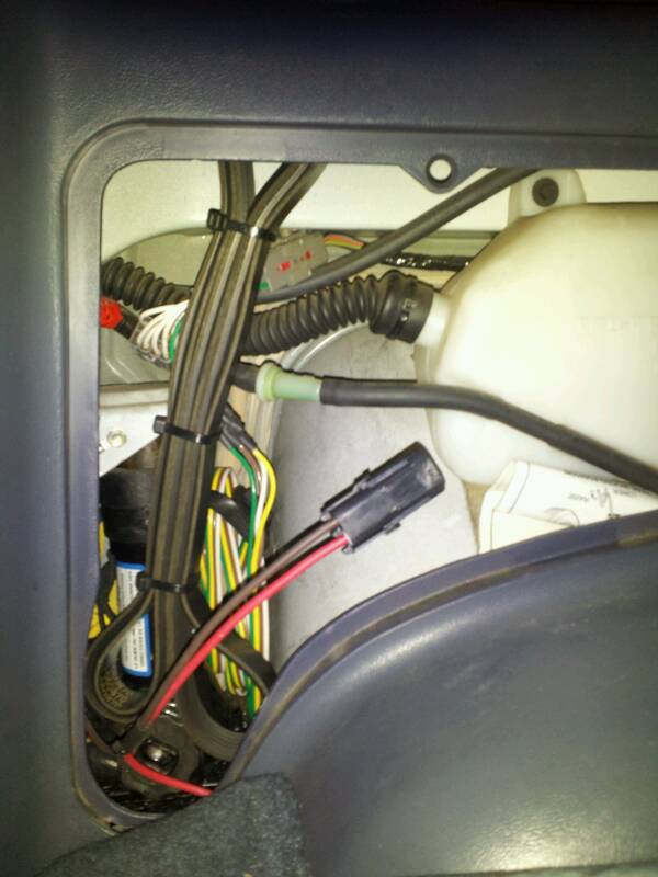

I'm on the hunt for a 12v fridge... gotta wait to find it at the right price or it just isn't going to happen. In the meantime, I ran a heavy gauge power circuit to the cargo area. I don't want to run it through a cigar lighter, so once I get the fridge I'll build a connector to attach to this one at the back of the car and make a short cord to plug into the fridge.
Weatherpack fuse holders under the hood. The plan was to build a small bracket to hold these but I have a potential trip coming up next weekend so tidiness will have to wait.

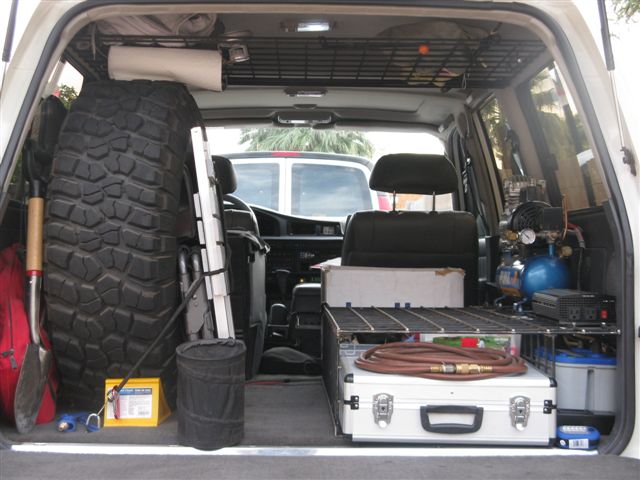

Another option is to make the shelf out of something like this...
cargo 80 a.JPG (61.87 KiB) Viewed 1352 times
Or I was thinking out of that wire shelving stuff you can cut to length.... but I think the net would be better when loading to the ceiling. The wire shelving might get in the way....

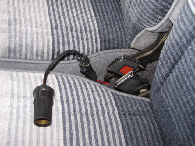

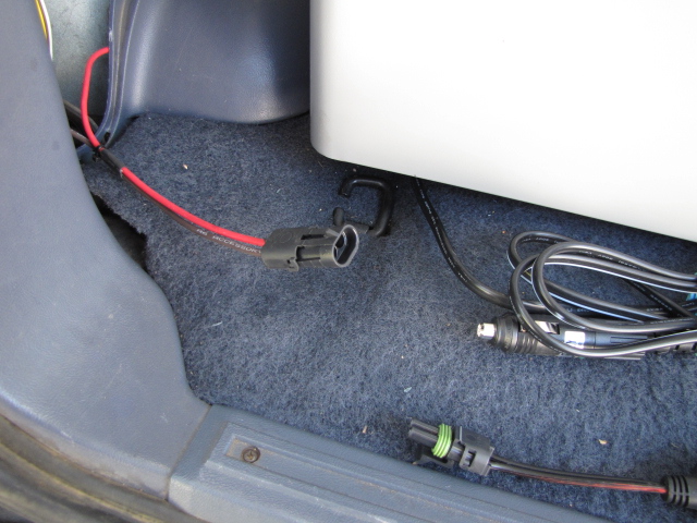

You can never have too many 12v outlets.... I added a high-amp outlet in the front of the center console a while back and finished up a couple more. One between the rear seats and another in the cargo area to run my latest acquisition. I made both with Weatherpack connectors so I could use them for other things without fear of them coming apart.
Between the rear seats:
Cargo area:
This will do for now but I plan to make a short cord to go from this to my new accessory.
