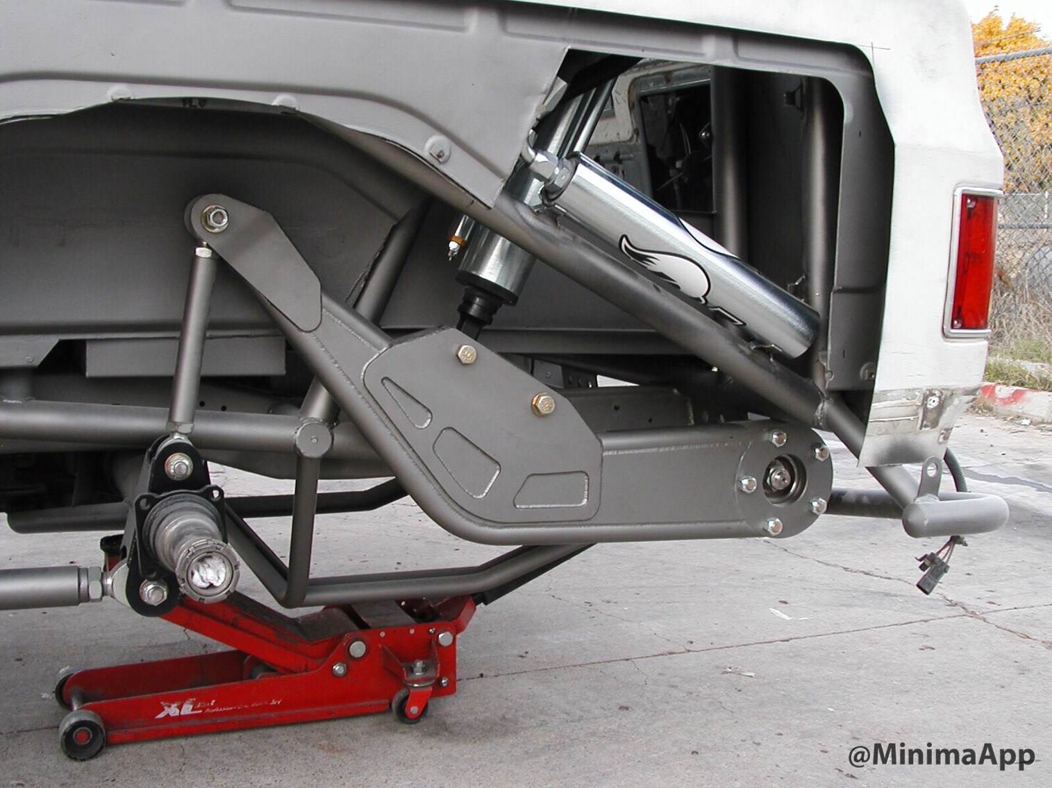

Maybe a mezzy rear? The packaging would be perfect to maintain the rear seating. I've got some sample pics if you want me to post them up, or I can start a mezzy thread.
Re: The Flyin Filarski's TTB Jeep XJ
Lets see'em!

Sorry man. I just saw your reply, here's a few mezzies:
I'll grab you some pics of this guys ride I'm building knuckles for when I get time. He has a mezzy rear too.
I have been knocking around doing this rear suspension on my Bronco to ditch the leaf springs and keep my Mastercraft bench seat in back.
