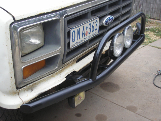

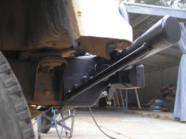

Bumper fab continued tonight after work..... added the end braces:
a quick coat of flat black until I finish the skid plate and mounts:
Well, it sure aint YikesFab or Patriot Fabworks, but it will do the job. Hopefully I will fit the other pair of lights and wire them all up on the weekend:

Looking good Rod!

Badass front bumper, Might be stealing that mount idea...

I can cut you out a pair and mail them to you. Just tell me the tube size you will use and I can throw in some of those gussets too. :D
Thanks for that offer!
Might take you up on that, but i have full use of a plasma cam here in the metals shop next door, so i'll probably just go with that. ;)
I need to figure out how to mount to the goofy '92 frames first!

Joxracing wrote:I need to figure out how to mount to the goofy '92 frames first!
http://www.autofab.com/front%20bumper%20kit.htm
Re: Rod's 84 BabyBajaF100
I cut mine back just over 10 inches. Then double walled the frame horn.
