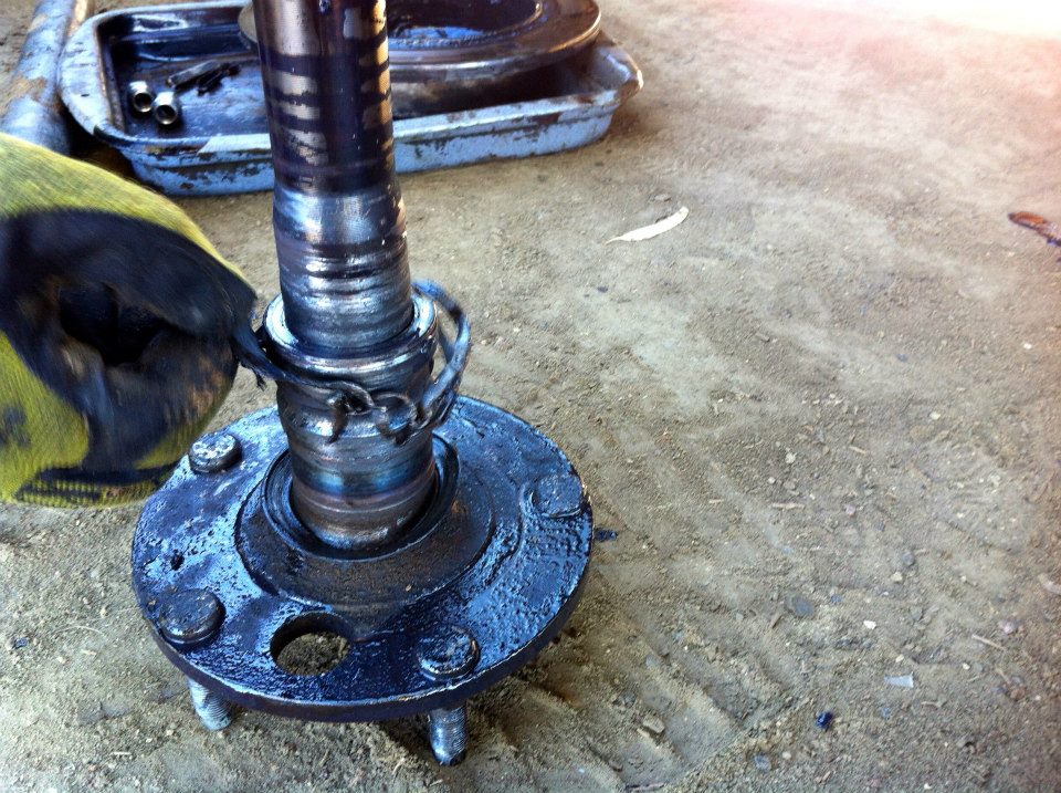

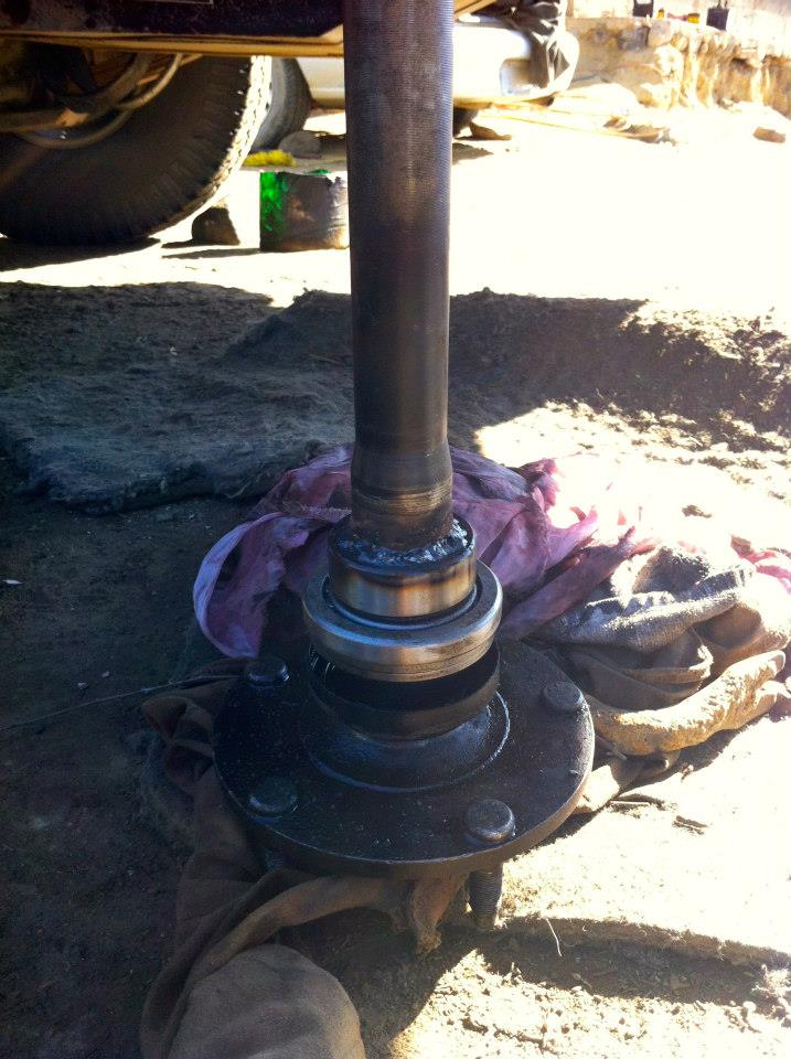

So, plans changed big time on the truck. I realized that in real-life I'm actually broke, so I had to scrap the massive makeover. BUT, on a positive note, I think my rear end woes are hopefully over.
I went down for three weeks for the 1000 and ended up going all the way to Cabo and back. My bearings decided to go out on the way home just south of El Rosario in the middle of the night. Super super sketchy. I spent the whole next day with a very inebriated Mexican mechanic trying to figure out how to get home. The bearings had milled out where they're supposed to get pressed on, and we couldn't find a cartridge that was the right size. So, after very very long day the mechanic decided to creatively engineer a solution... he welded the bearing straight to the axle. This, obviously was a patch to get back to the states and also rendered my axle worthless for further use.
As it turns out, the axles that have been in my truck (I bought the whole read end used) are actually intended for drag racing. The bearing that I've been using were also intended for the same. Problem is, drag racers go straight. The bearings I was using didn't have enough side load tolerance, which is apparently why I kept going through em.
So, as it stands, I've got my truck coming home soon with some new parts. I kept the housing. It's still straight as an arrow and it's tough. I went with Moser 35 spline axles though. Got a spool and a new seat of gears in there too. I also ordered up a spare set of bearings to keep with me at all times. Now that I have spares I'm sure I'll probably never have another problem with them again : /

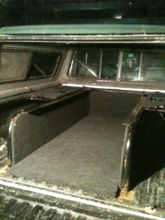

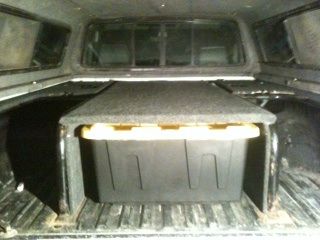

The fiberglass and widened front are on the back burner for a while along with the cage. If I pull the trigger on anything next, it will be the walk thru and an engine rebuild. Just excited to get her back down to Mex in the meantime. I attached some photos of the latest (and hopefully last) bearing incident as well as the boxed out and carpeted bed I made.

Unfortunately this is the way it goes. Call it "cheap" insurance.SC150 wrote:Now that I have spares I'm sure I'll probably never have another problem with them again : /
