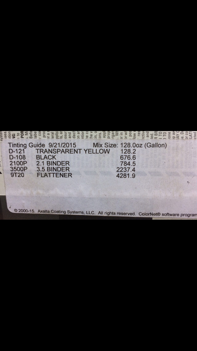

What did you do/ use on the frame to clean it up before paint? And what did you use to paint it?

Sorry, missed your last post. What kind of paint did you use?

The application is roll on and the reason is that spraying is a stupid hard to get in the cracks and tight areas. Use a foam roller and dab with a brush and it flows out really nicely. Of course the overspray is zero especially when the body stays on the chassis. My 96 bronco turned out super nice and the body bolts never were moved.
I wire wheeled it, then scrubbed it with Purple Death Cleaner/dishwashing soap, the lacquer thinner wiped down-- just sandblast it and forget it

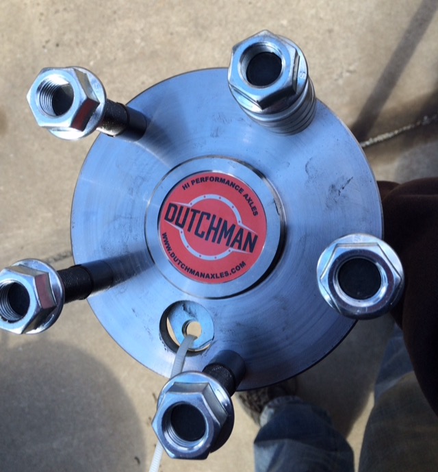

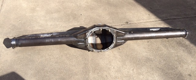

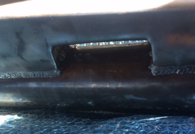

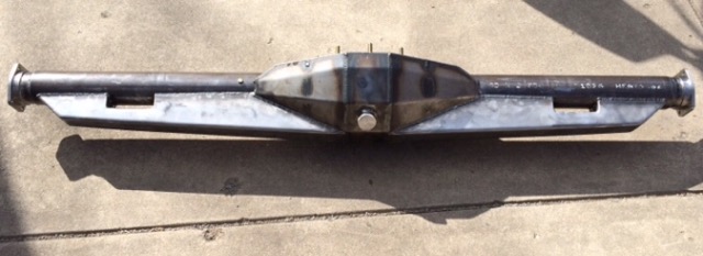

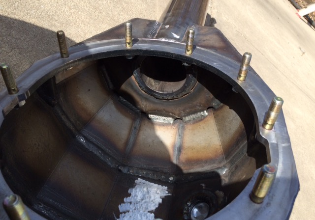

Got some width today! 73.5" to be exact
. So stoked!!
- image.jpeg (43.85 KiB) Viewed 2774 times
- image.jpeg (63.96 KiB) Viewed 2774 times
- image.jpeg (76.41 KiB) Viewed 2774 times
- image.jpeg (55.38 KiB) Viewed 2774 times
- image.jpeg (101.89 KiB) Viewed 2774 times
- image.jpeg (67.01 KiB) Viewed 2774 times

When/where did you lick up the fabbed housing?
- Posts: 2338
- Bronco Info: Bronco List:
- Location: Phoenix, AZ
Re: 95 F150 - Project Marilyn
It's a complete Dutchman unit.

nice housing set up...

I just looked it up 895 housing with axles is the standard set up. That is a outstanding deal.

It was about $1850 shipped -- that was housing, the longer than the norm axles, perches, the extra wide back brace, 3.5" x 3/8" wall main tube, 5/8" studs, and making the openings in the back brace. Currie would run me right at about $2100 shipped. Personally the Currie back brace is just too narrow on the ones I have seen.

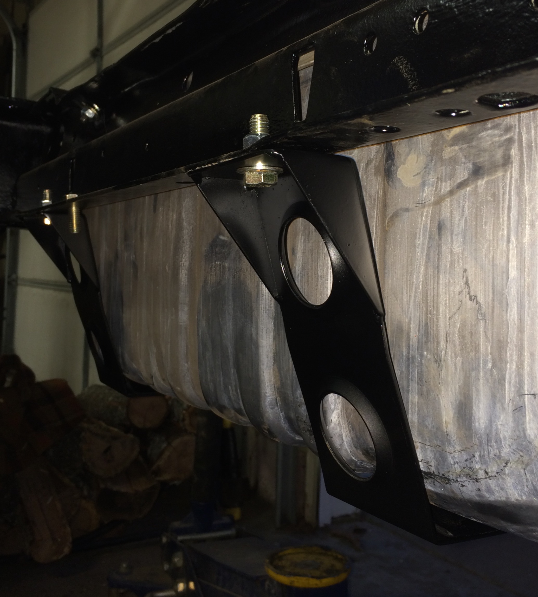

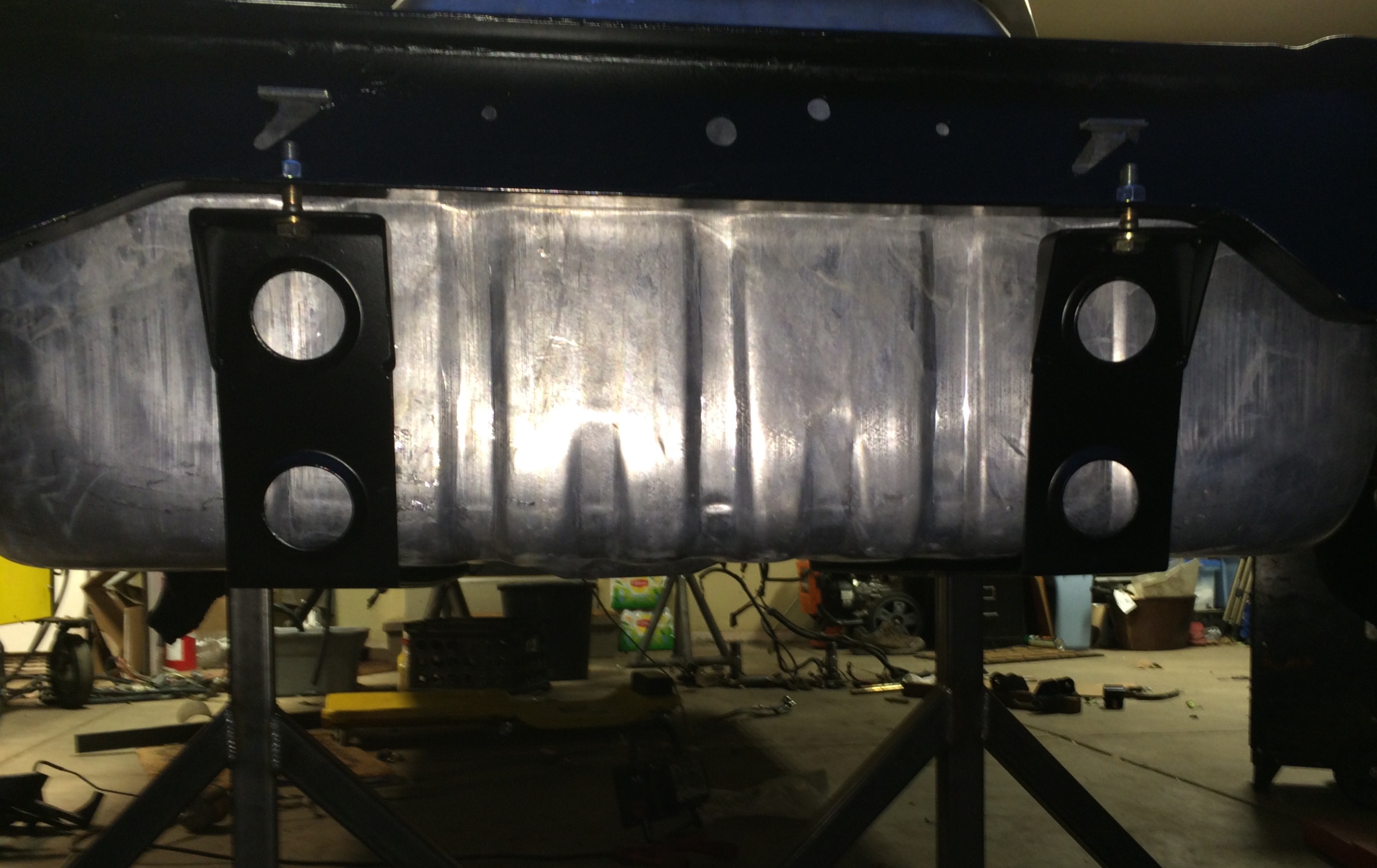

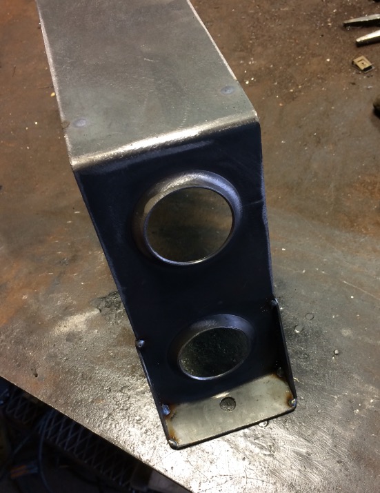

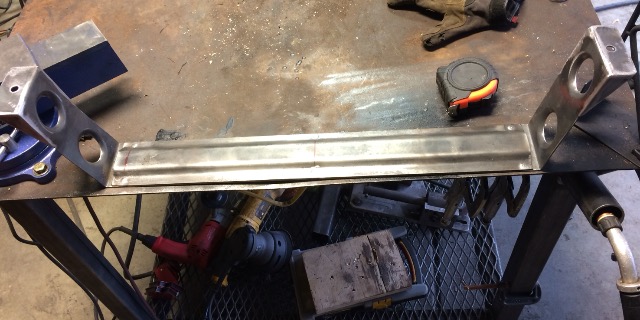

Finished up the 38 gallon gas tank mounting straps. I just wanted to fab up something simple combining the factory parts materials. More importantly its something that looks race inspired
- image.jpeg (75.98 KiB) Viewed 2700 times
- image.jpeg (107.7 KiB) Viewed 2700 times
- image.jpeg (642.47 KiB) Viewed 2700 times
- image.jpeg (809.91 KiB) Viewed 2700 times
- image.jpeg (683.71 KiB) Viewed 2700 times
Nicely done - you've achieved it. How did you do the "bead" on the bottom of the strap that goes under the tank. Assuming that was bead rolled? Or is that a second piece of material tacked on top of the main strap & done in a brake?VintageIronFab wrote:Finished up the 38 gallon gas tank mounting straps. I just wanted to fab up something simple combining the factory parts materials. More importantly its something that looks race inspired

That's the beauty of it-- the F150 has a 3.25" strap on it that bolts to the frame to hold the tank in place, that piece has the ridge in it to engage the ridge in the tank. I just cut the ends off it to fit into my straps, then I added some 1/4" weatherstripping for insulation. Tacked the factory piece in place. If I wanted a skidplate could easily go in there too but I was being kinda cheap and this ain't no crawler
