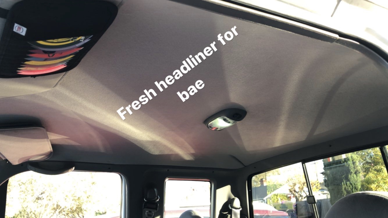

Cleaned up the interior a little, new headliner, done light out of an older Taurus (bolts right in), and an OHSHIT handle out of an obs Chevy. I know, I know, sacrilegious haha.
