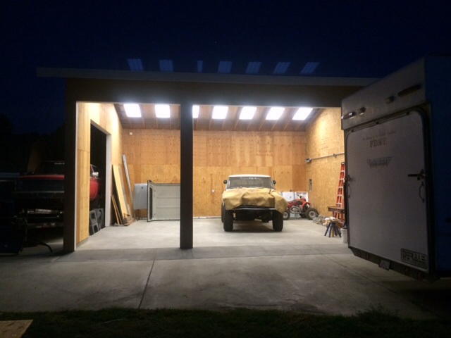

Trucks bee n sitting a little due to some other project neglect. The kid wanted a new bumper for his blazer so he stole a weekend from the Vieja. I did get the fender braces in and I'm waiting for John from Autofab to send me the inner fender pieces before I mount them. Was going with the Zeus tabs, but now that I decided to run inner fenders, no need for them to come off. Hated the 3 washers making the support look all distorted, so I went with some plates to keep it clean.
I also got some lights in the new work area.

Hard to believe there's any shadow in that garage with all those lights. That's what I need to invest in... Better lighting. The drop light and 3 single flourecent tubes isn't cutting it. Progress is looking great!

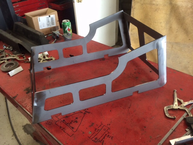

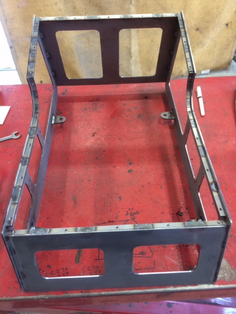

I have been working on the Nova trying to go to the TCI / Steve's Nova site event, but the bumpers didn't come back from chrome.
Sooo, I decided to spend the day on the old girl. Put all the pieces for the console together.
The wife got me the Art Carr shifter for my birthday, so I had to figure out how I wanted to install it. Of course, when giving up the center seat, I had to decide what else to add. This is where I'm at.
Shifter on upper Left, GPS on upper right, 5 or 6 toggle switches & horn button underneath the GPS.
1 or 2 race radios on the lower section ( our channel & weatherman) cup holders, battery shut off and possibly small storage compartment in the very back.
What am I missing? What do you guys wish was right next to you when chasing?
Besides hooter girl and alcohol! Race related needs.
I will be cutting out the shifter and GPS panel tomorrow at work, but the bottom panel is wide open. Area is about 14"x14".
Here are the photos

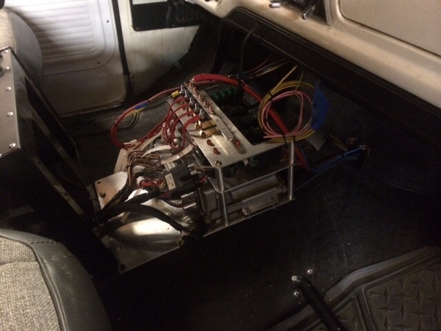

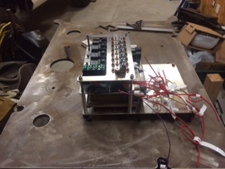

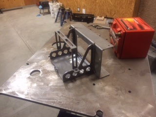

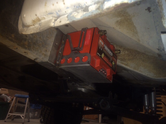

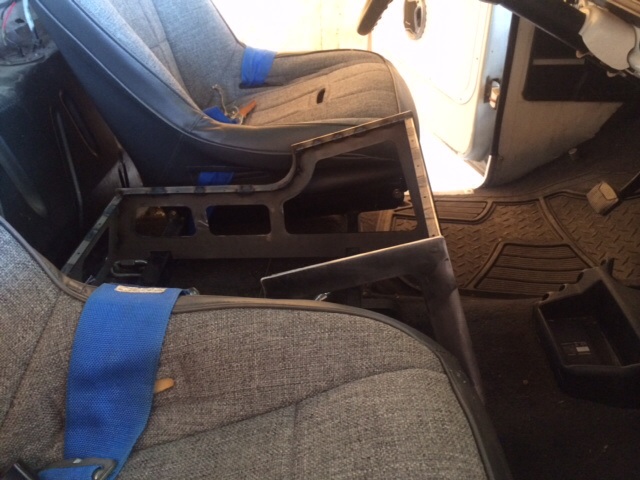

Back at it again! Finally made the decision to put the electrical in the cab. Put together an electrical console which will be mounted on the tunnel. Once everything is in and wired, I will make a console to contain it all. With removeable panels of course for access. Also found a place for the battery. Was really having an issue with putting it in the bed, and just ran out of room up front.

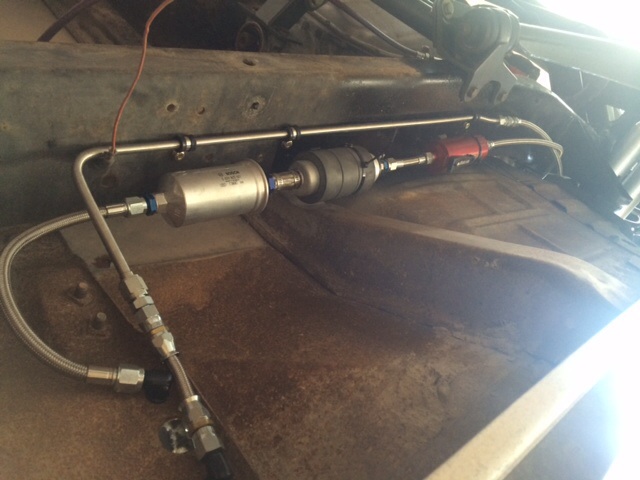

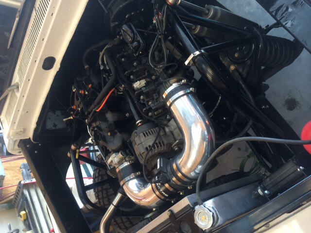

Finally squeezed out a little more time for my project. Got the return line plumbed to the stock tank, as well as getting all the filters and pump mounted and plumbed. Zip ties are only temporary. Was having some difficulty deciding how to get a cable around the intake over to the throttle body. Decided to make a plate for the top of the manifold and just go over the top.
Looks like she's back on the "to do" list again. Exhaust is next. Got some ideas, but it's gonna be packed in tight.

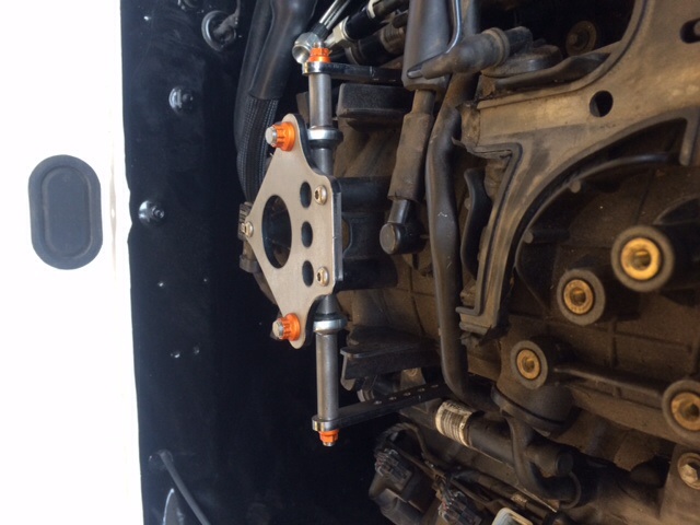

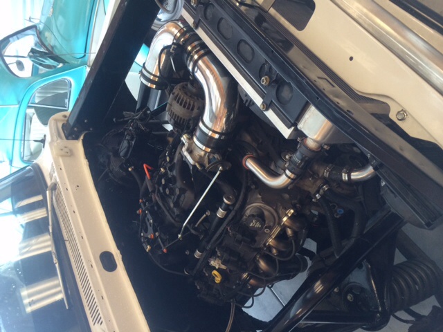

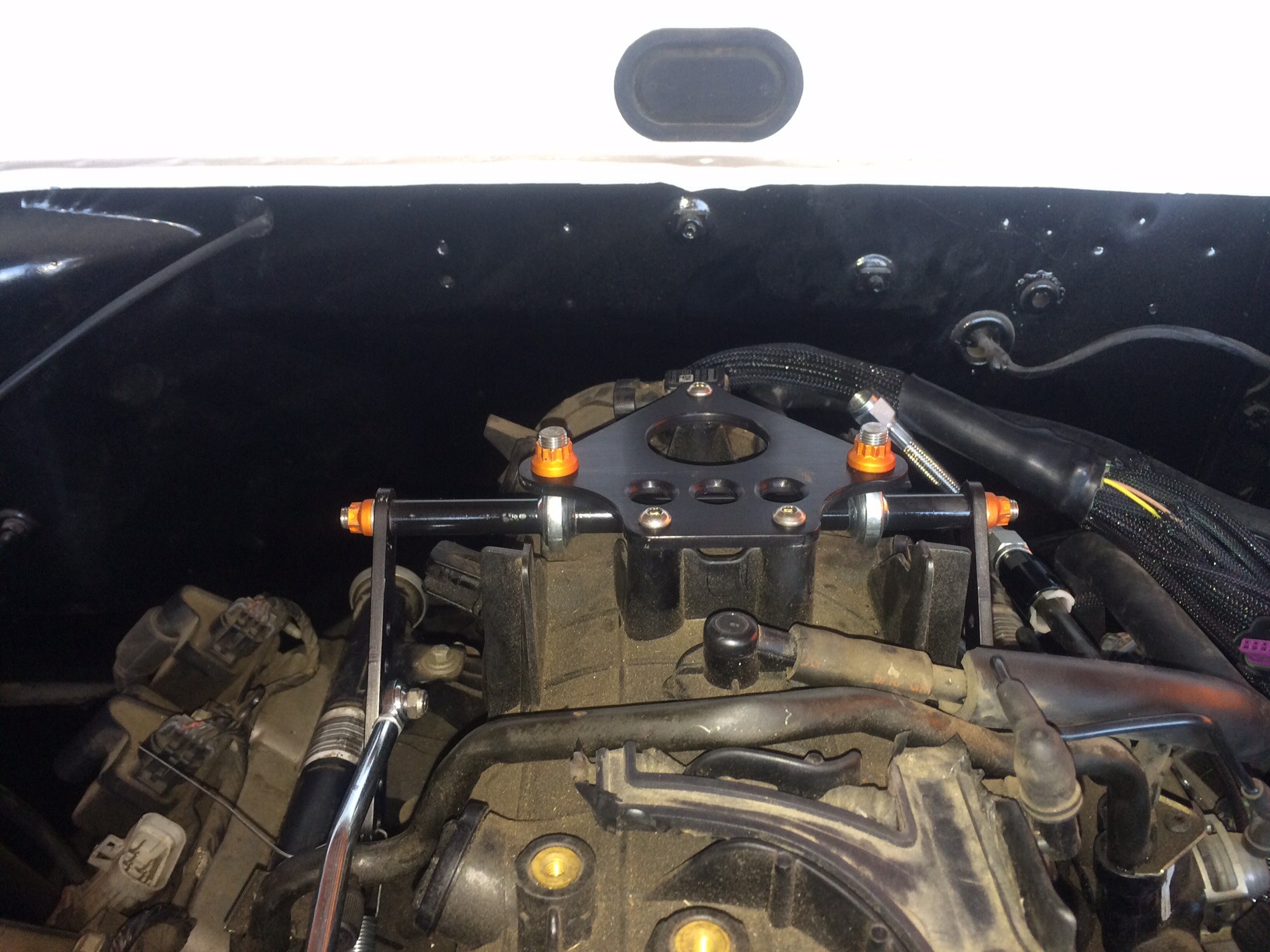

I wasn't liking the steel one, so I cut a new one out of aluminum and had it anodized black. I like it much better.
If someone has an LQ9 or truck LS that needs the steel parts, they're all yours. Just need heims & shaft.
Hoping to start the exhaust this weekend. Gonna cram some 3" tubing where it doesn't want to go.
Hope I measured correctly!

Re: The Vieja
What size general's and methods are you running in the first pic with the fiberglass fenders?
Very similar to what I'm looking to do with my truck.
Bootleg1
- Posts: 52
- Joined: Fri Aug 24, 2012 7:50 pm
- Bronco Info: No Bronco. Looking for one when I fell into a Blazer. Also have 68 F100 prerunner.
Re: The Vieja
15x8 wheels with 35" generals.
