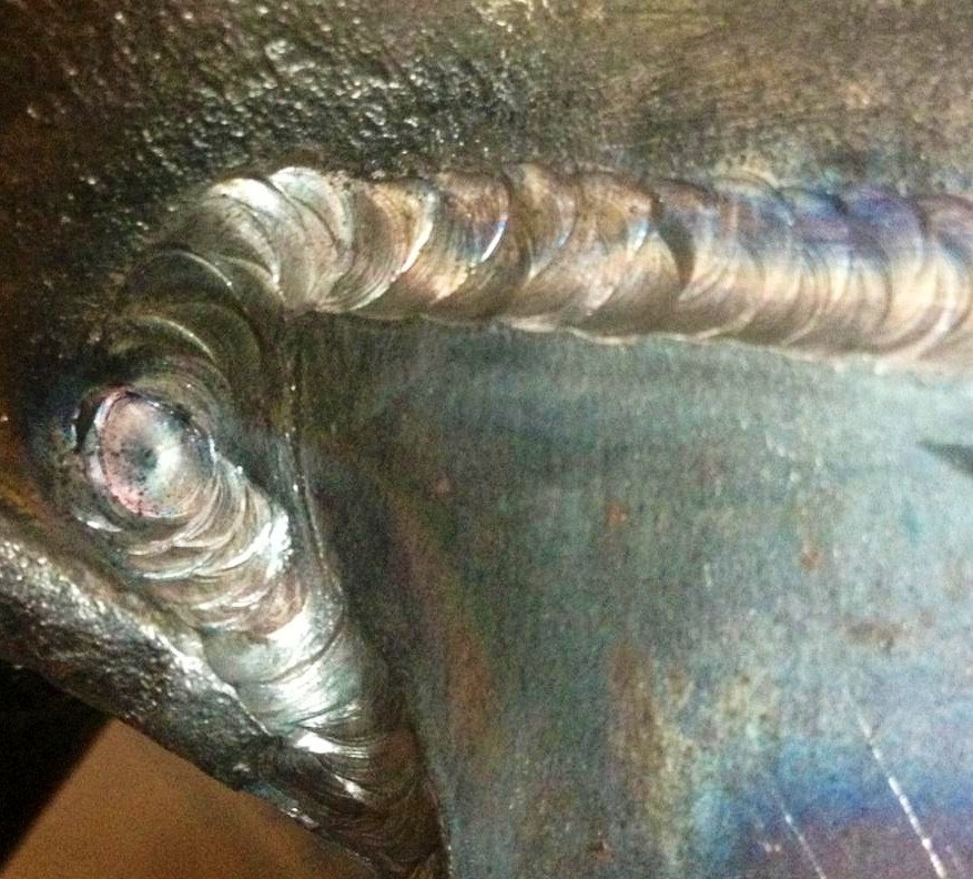

Here's a close up of a section of weld on the arms.
Re: Rmc's baja bug project.
Underside of the arm, I put a lot of heat into it for better or worse.

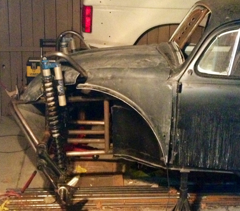

What travel shock is that?
A 12x2.0 lol too long that's all I know, but at droop I'm at 11 inches exposed, I need to tweek the arms and beam to get the last inch.

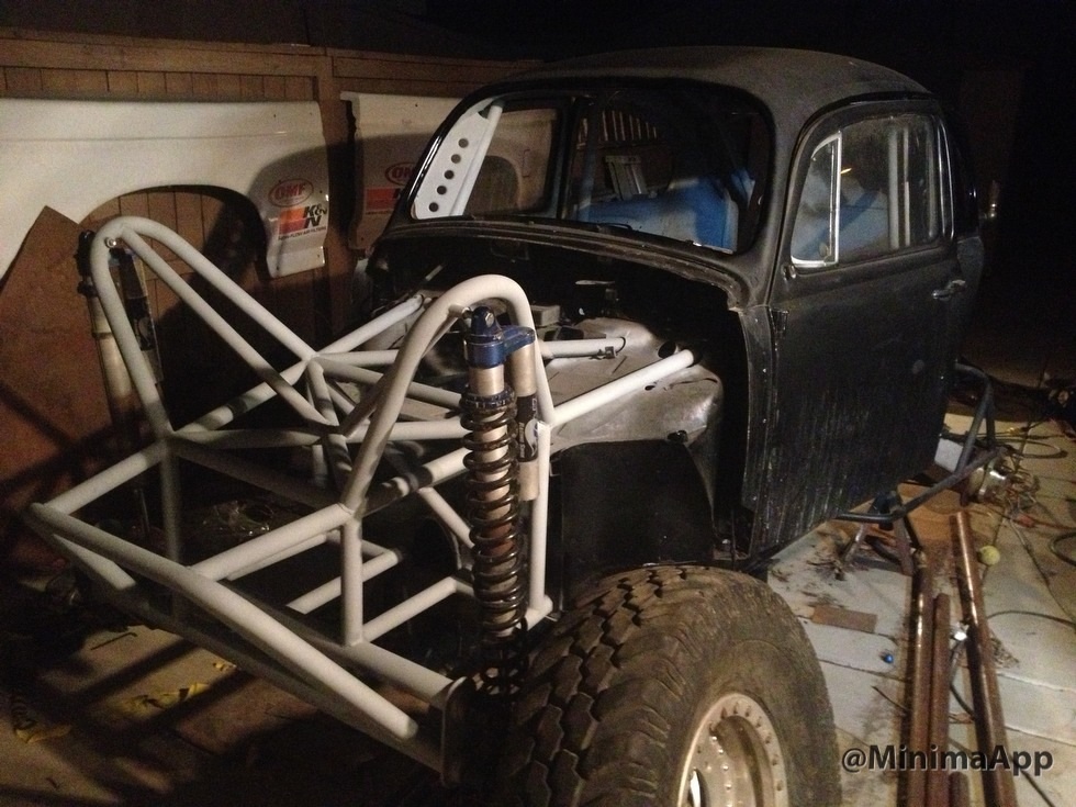

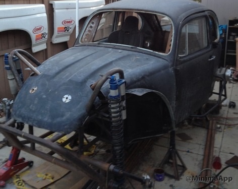

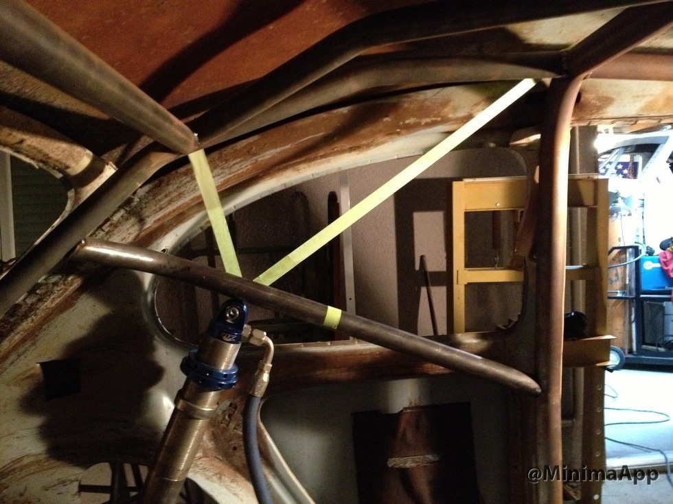

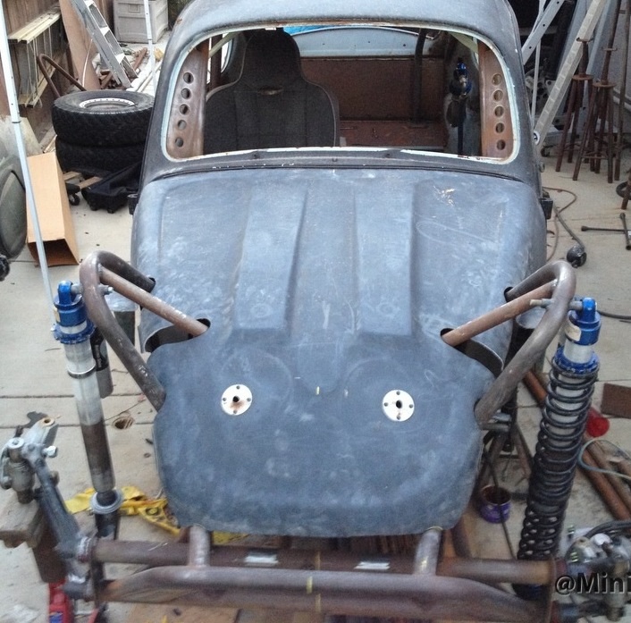

Update: got a bunch of cutting and grinding work done today, I had to cut off the old coil over mount on the trailing arms. They're were intended to use with a 1.250 shock eye and these are 1.500. Tied more of the front hoops in and got the hood to fit over the added bars.

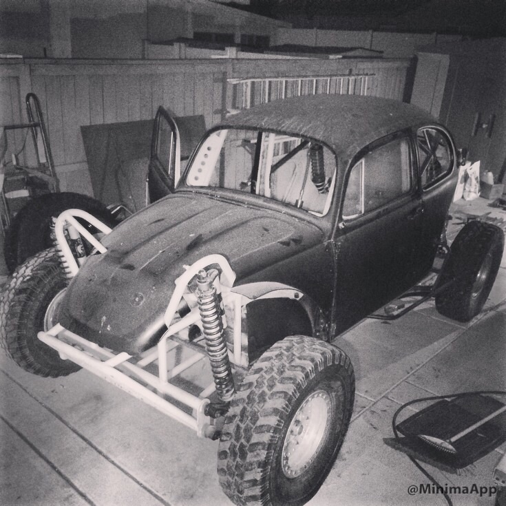

Getting pretty close, at least with the first phase.

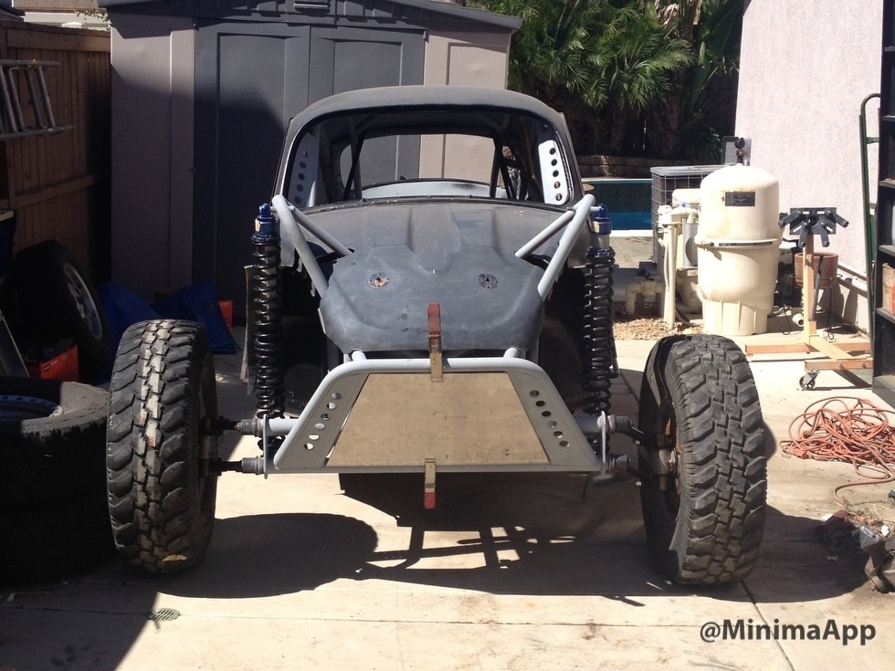

Had to move this thing back today so I made the front a roller, I just slapped it together to make room to pull the bronco in to get the rear suspension and a spare tire carrier done before the trip. It's going to look mean though( bug)

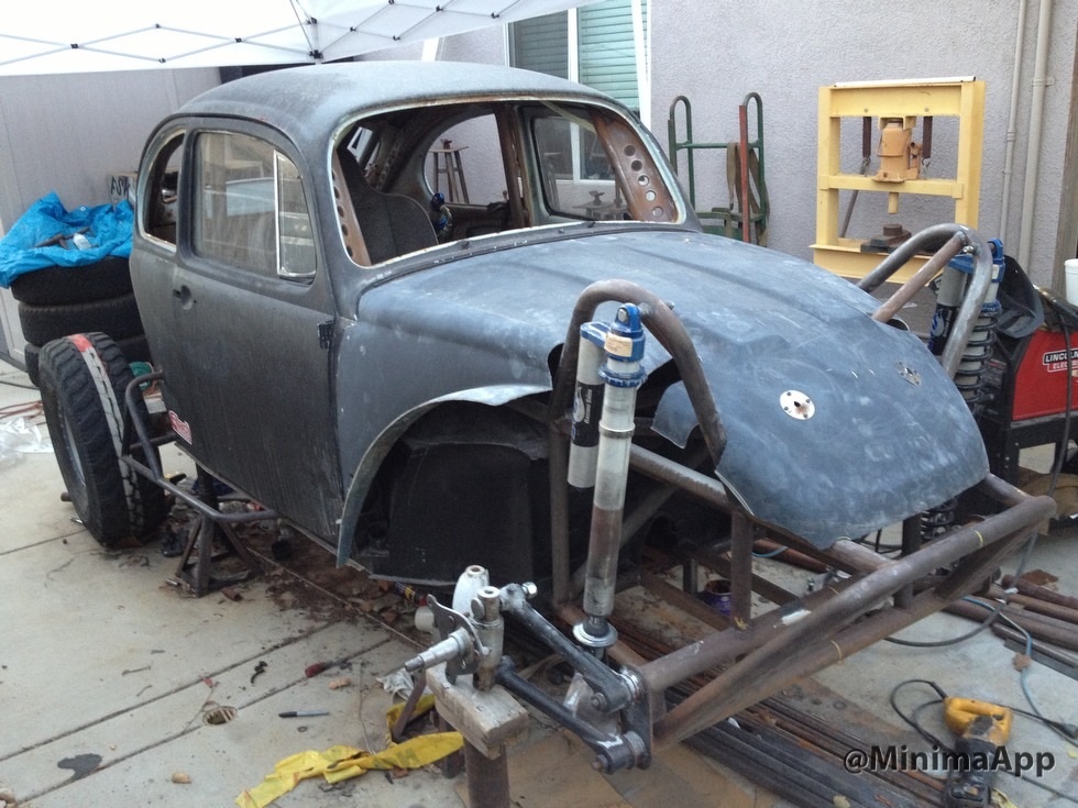

So finally I got back to this thing. Looks like the owner is going to tow it home Saturday amazingly. So here's as far as I'm willing to take it till he decides if he wants to finish it . I'm way way past sick n tired of storing this thing. See what had happened was lol he fell in love. We all know where his priorities went then. So since then he's been all over the world, diamond ring and bought a house and planned a wedding. Good for him I say but even better for me cause he has his own garage to store his shit. Some pics before it goes :cry: :lol:
