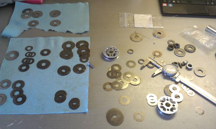

Shock parts are all cleaned up. I need a couple reservoir hoses, to decide on valving, the shock assembly.
Re: The 8 Year Project
Steve how in the hell did you get so many shock parts?
It just looks like a lot. It's only 4 shocks worth.

Today, I'm pretending to know how to valve shocks.

I like to pretend I know how to work on shocks from time to time too. ;)
Rear shocks are done. I'll get some hoses made for the fronts tomorrow and finish those up. Hopefully start testing next week.
