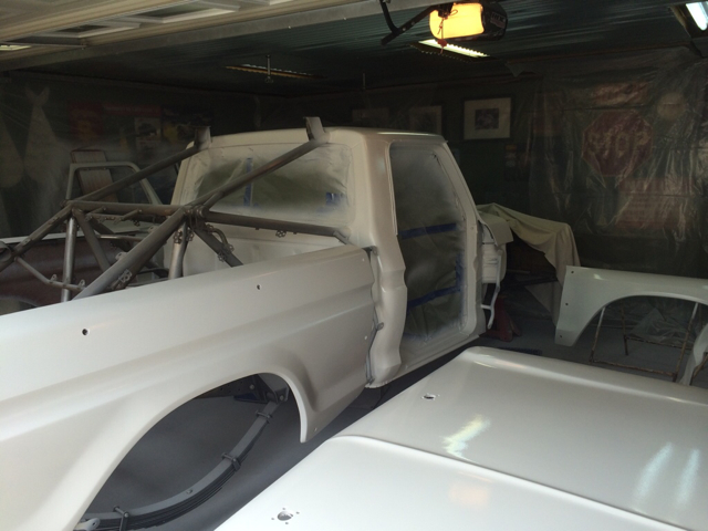

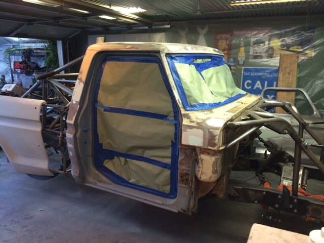

That's just prep and primer, already an improvement.

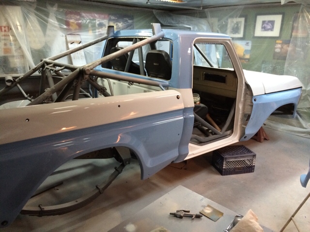

White paint! But I wasn't done.

Trust me, it ain't perfect, but it's perfect for what it's for. Everything is clean and will be much nicer to work on. The cold is a stock Ford truck color, Glacier blue. Now I need to paint the tube work (black) so it can go back together. I've got a pile of parts waiting to go. Soon!

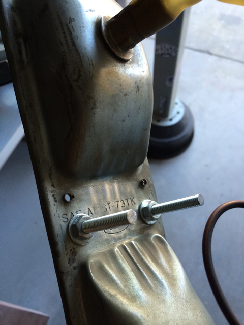

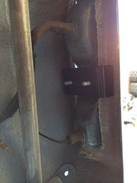

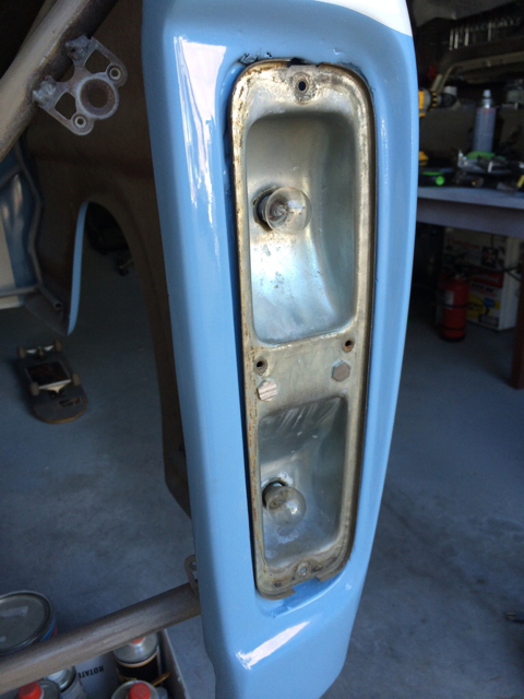

Mounted my tail lights. These aren't Autofab bedsides, I imagine that Johns panels might fit better. These are some knock offs of unknown origin that I bought from some carpet bagger I met on the inter web.
I ran the heads of some bolts through the band saw so they would fit under the lens. Bolted them into the stock housing, then bent some 2" flat stock. Basically like a gauge mounts. Just need to get some new lenses and gaskets. I think I'll double up on the ones that go between the housing and the bed just to fatten it up.
