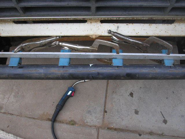

Started on my front bumper today. After going as far as I could on the cars I am fixing, I started fabbing.
After removing the stock bumper, I bolted on the mounting plates:
Flame cut these at work to my own templates:
positioned the main tube and set the level:
tacked on the light tabs:
note the sophisticated alignment tools :D

So far, I have about an hour into putting the bumper together. I cut out and made up all the brackets, tabs and bent the tube during lunchtime breaks and after work, when I had time. A few more gussets and braces will strengthen it up. The underneath braces and skidplate will come later.
