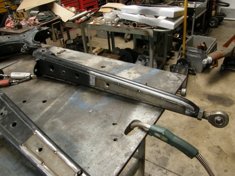

I've been working on the radius arms all week (just a couple of hours after work in the evenings... Below is an "in work" pic of the radius arms. I've actually finished welding the all up... I just have to lay down a coat of paint.
- front end repair, rock hit 004.JPG (134.86 KiB) Viewed 3848 times

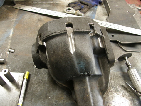

I was able to work my front diff housing... the tool sharpening guy got the mill bit cut to size and delivered to the shop late yesterday afternoon... great timing. So, I got to work on the mill today and cut the clearances for the bushing stock inserts. So, I got the diff case all clearanced and the bushing stock cut, faced and fit to the diff casing. They are all tacked in. I hope to get them TIG'd up tomorrow... well, at least started.
- milling the clearances
- front end repair, rock hit 013.JPG (138.62 KiB) Viewed 3842 times
- diff case clearanced
- front end repair, rock hit 017.JPG (125.64 KiB) Viewed 3842 times
- bushing stock inserts
- front end repair, rock hit 018.JPG (119.33 KiB) Viewed 3842 times
- inside view
- front end repair, rock hit 021.JPG (125.58 KiB) Viewed 3842 times
