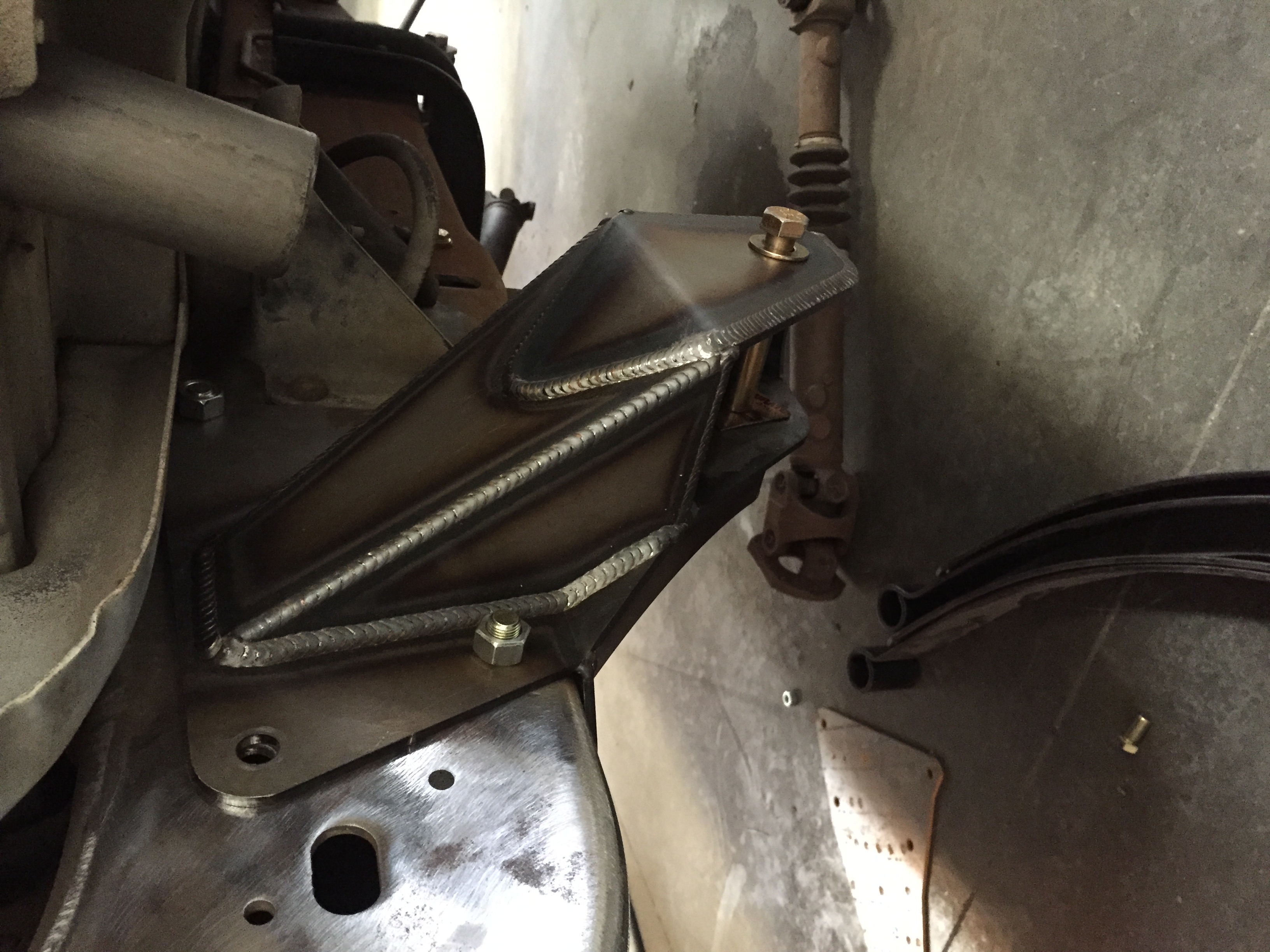

Might be a good idea to start a thread on the Richer 64 kit...
White 1994 F-150 Sleeper Build
nubreed71 wrote:Might be a good idea to start a thread on the Richer 64 kit...
I 2nd this..
I had to piece mine together, using parts from Giant, KelFab , and Deaver..
If Richers front hanger mount is built better then Giants, I'd like to upgrade ..

I saw that pic this morning. Nice upgrade for us non caged guys

Sorry to jam up your thread with all of this 64' talk Taylor, we'll cut you a good deal when you are ready to pull the trigger on spring under! 8-)
For any one that is interested in our spring under kit please pm me. it is the same pack as the giant kit which means our brackets will work as a upgrade for anybody looking for a heavier duty part. We will also potentially be prototyping a 3" spring under pack for the guys that load their broncos like pack mules. The spring under kit is a night and day difference over the spring over. We are able to safely notch the frame 3 inches for more up travel while maintaining a low ride height. The added arch and preload allows the wheels to fall into whoops more efficiently and prevents packing.

Haha, don't sweat it Cho! Looks killer...love the extra up travel too. I have a feeling that when we do the axle swap, I'll probably just do this at the same time. As long as you can keep the shocks under the bed ;-)
