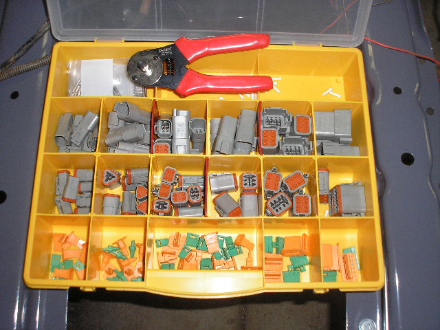

Hey Rod - how much was that kit? Got a seller name?AussieRod wrote:Deutsch plug kit from Grover Beach Ebay dealer:

He sells under the Ebay name "vehicleharnessco", his name is Joe and his phone #s are 805 259 8887 or 541 330 8800. Joe will make a kit any way you want, just tell him what you are after, he can tailor it to suit your needs..... really nice guy to deal with.ChaseTruck754 wrote:Hey Rod - how much was that kit? Got a seller name?AussieRod wrote:Deutsch plug kit from Grover Beach Ebay dealer:

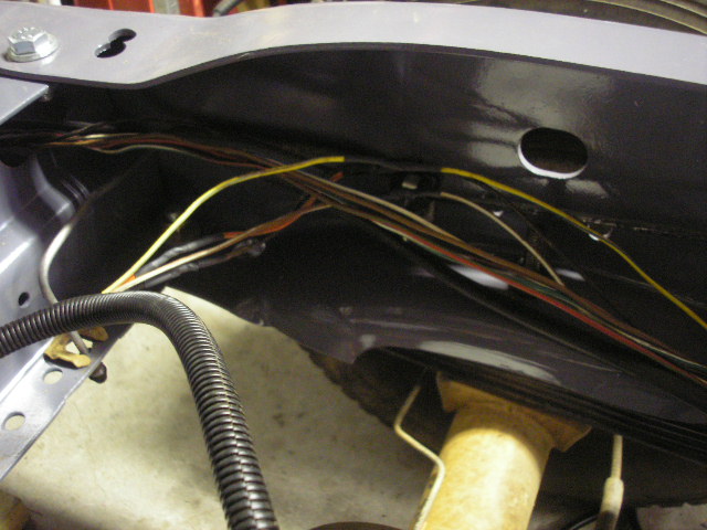

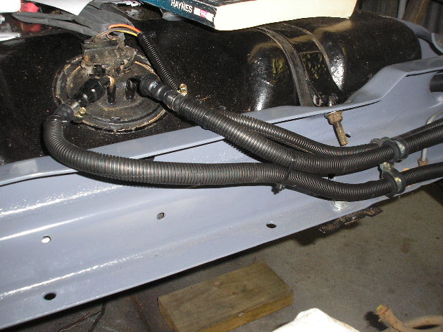

Shortened up the feul tank wires, soldered and shrink wrapped: Wrapped up in "convoluted conduit" as its called here: The other 2 pics are too blurry to see, so I'll take new ones tomorrow night. Should have the hi pressure pump mounted this weekend, along with the fuel filter and ready to start fuel plumbing. I need to lengthen some wires for the pump, and tidy up a couple of loose ends, then I can wrap the harness and P clip it up. Once thats done, I will finish my cab trolley and start Phase 2, the cab.

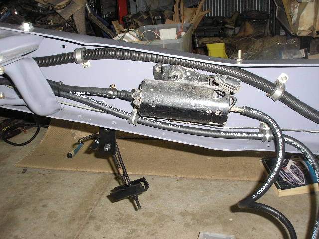

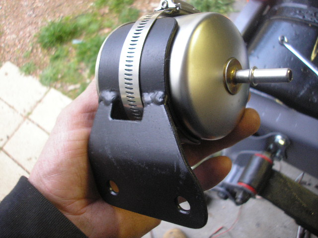

Nothing happened yesterday like I planned, so in the end I gave it a miss. Tonight, though, I made up for it. Stopped off at the auto parts store and bought a roll of EFI hose (got sick of waiting for the "cheap" deal) and the proper hose clips, then after chores, got stuck in. I made this little fuel filter holder at work in about 30 mins, mounting above the axle inside the frame: Plumbed in the the tank pump lines:

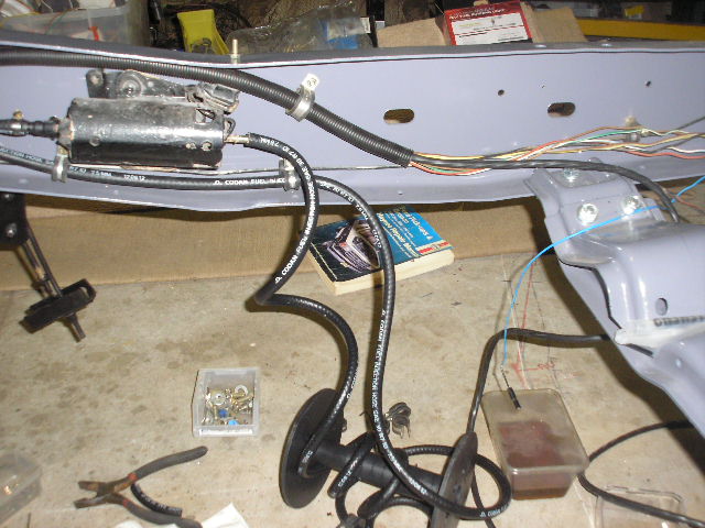

Mas plumbing:
How it looks with the stand-offs..... nice and neat:
Fuel pump mocked up (yes, its still dirty, I will clean and paint it once all the plumbing/wiring is done):

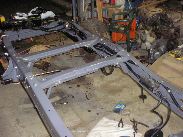

Bigger picture: Most of it done, just a few more feet and I can say its ready for the cab: The pump wires need to be extended to the pump, some other stuff needs a little tidy up, and a couple of Deutsch connectors need to go on, and its going aside until after the moor swap in the Falcon, then the cab will get attacked. The days are getting longer again, and the weather, well, it IS Victoria after all, will hopefully settle down soon. One day the other stuff will arrive and I can start seeing some real progress.
