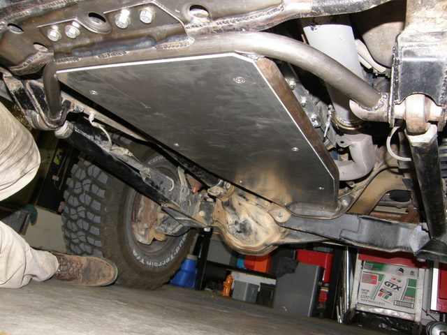

Since I swapped out my Ford stock stamped steel tranny oil pan for a new, billet Al Moroso, I wanted to protect it from flying rocks and the assorted off road hazards. Along with that, I have never gotten around to tying the radius arm brackets together to keep them from deforming and stressing the frame. So, I spent the weekend building and integrating a chromoly cross member into the transmission cross member and then extending some tubes forward as a base structure for a skid plate that covers the transmission pan and the engine oil pan. As you see, I boxed the transmission cross member to distribute the load evenly. Eventually, I'll bring it back to catch the transfer case to protect it too.
As you can see, I need to get under there and clean up the running gear a bit... but it'll have to wait until after the Mex 1000 and the Baja 500 coming up. Simply not enough time! I still have to mount and plumb a new frame mounted fuel filter to replace the stock one. I'm going to be on a much more frequent and rigid fuel filter replacement schedule to help avoid those fuel delivery problems I just got over. Changing a fuel filter every few months seems like pretty good insurance, especially when running as much Pemex as I do.

That looks really nice Tom!! Something similar is on my list of next to do's, I really like how that protects everything underneath.

Thanks Tony! I've got to drop it all and get it cleaned up and powder coated... it'll look much more presentable!

Damn, Tom. I love it! A friend of mine did something similar on his Ranger and I always wanted to steal the idea. Great work!

Thanks Steve, I just can't believe it took me this long to get it done! I'm just a slacker!
