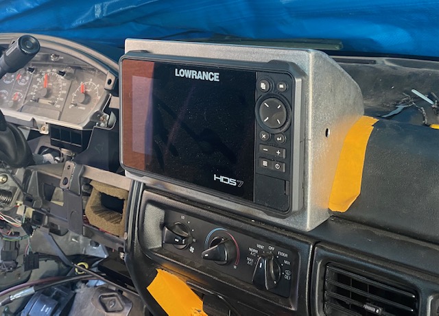

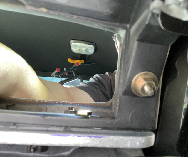

So here is the final pre-upholstered look of the GPS dash mount:
Posts: 2338
Re: 95 F150 - Project Marilyn
Posts: 2338

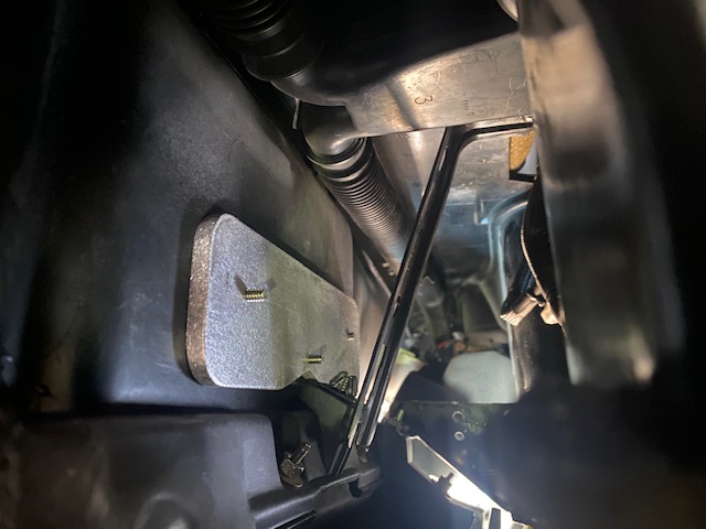

I like to take 1/4" aluminum that's tapped to act like a big rigid "washer" of sorts. I epoxied the aluminum to the back of the dash so that it just adds to the stability- to me a simple washer just makes pull thru way to easy.
Good work Matt, I'm with you on the washer's on the Bronco/ F150 dash. They fall apart so easy as it is when it comes to off road conditions over time, a plate is what I would do also. On my 1972 Bronco Dash, I am looking forward to using more aluminum and getting some time to play with my Tig welder. I am putting the GPS under the stock style 72 Dash, to keep it looking Old School as possible, maybe some way to hide it in the center console when not needed.

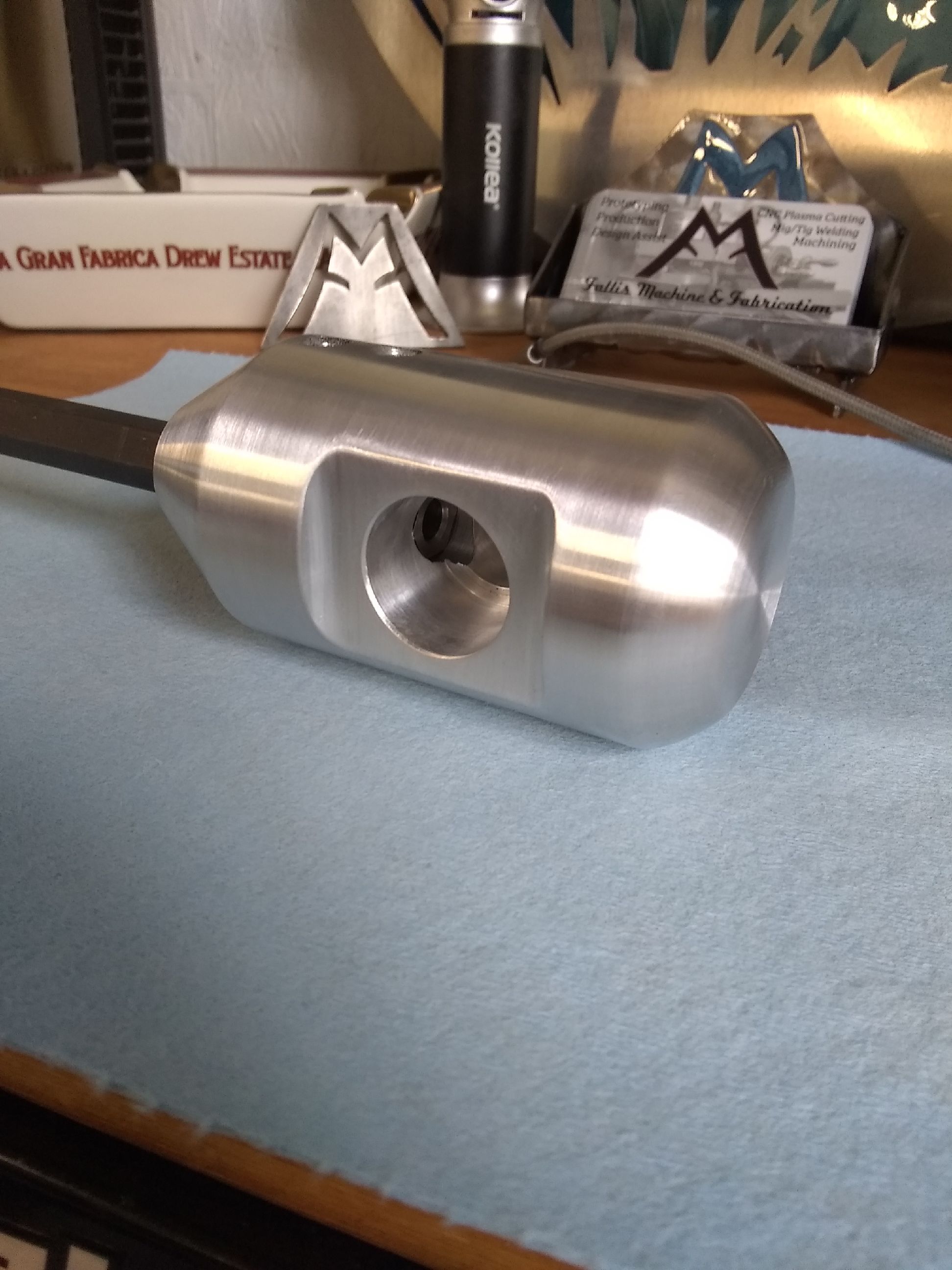

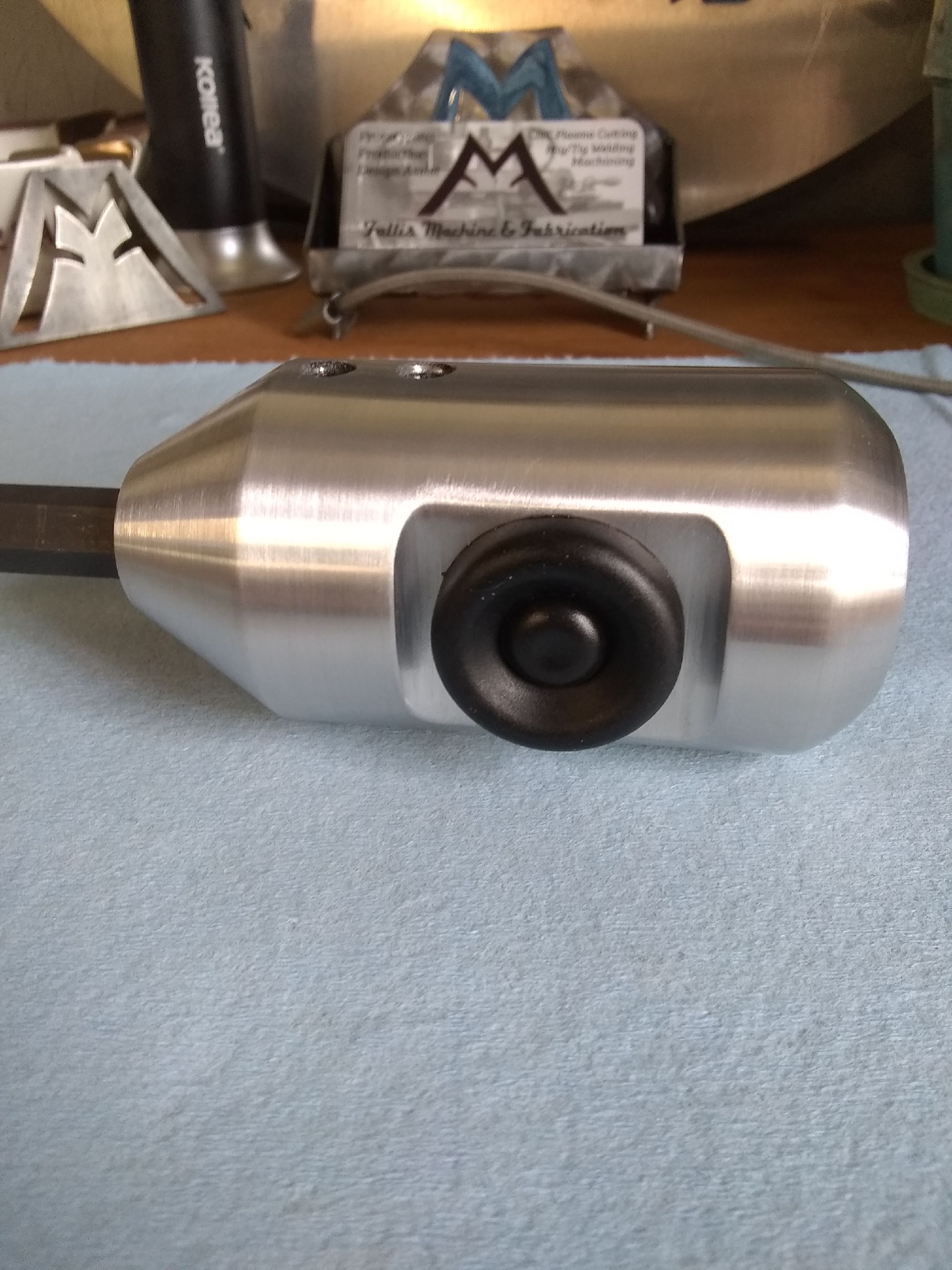

First version of the console shifter knob with integrated OD button. The factory style button was used because they are readily available and they look like a factory piece. Once the knob is sanded, blasted and powdercoated I think it brings the kit almost whole. This I believe is the first of its kind. Version 2.0 is in the works to fine turn the design further to my liking Trying to bring the winter's shifter into the FSB/OBS world in the best and easiest way possible as a kit.

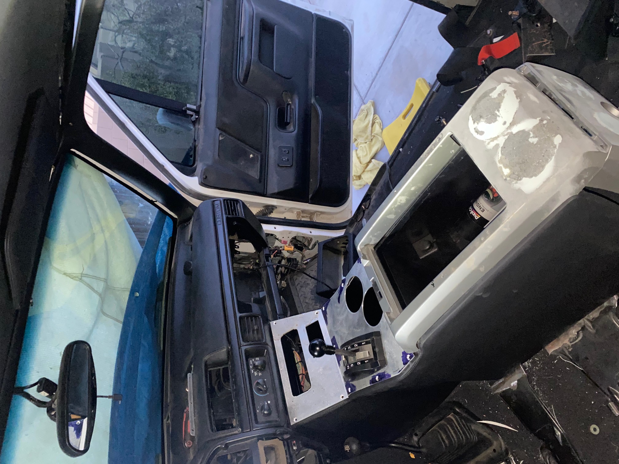

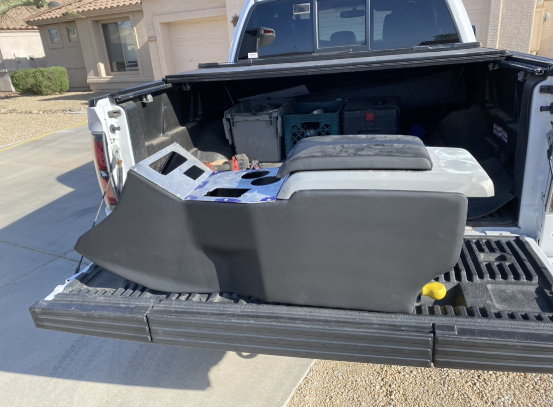

Here's the console...

Post by toddz69 »
Have you fished the wires down the hole yet to test everything out?
