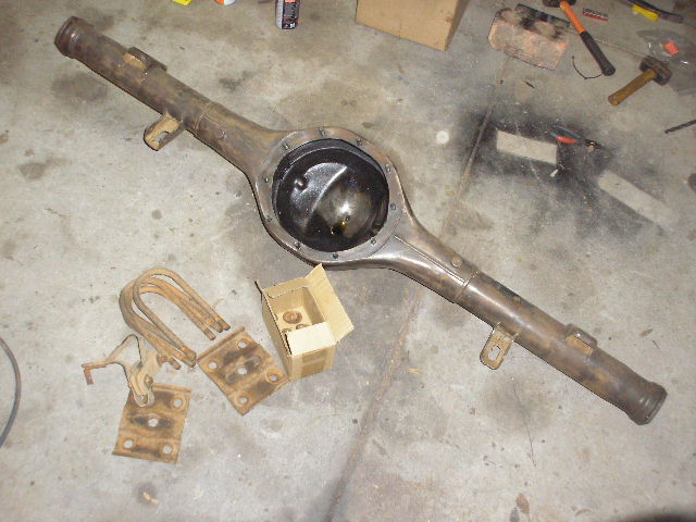

Diff housing ready for pressure cleaning, U bolts, spring plates, etc going to wire buffing at work:

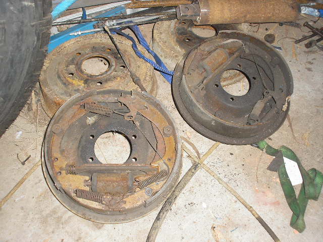

brakes in line for clean up next:

Can you convert the 9" to disc? I know they have some goofy rules you are stuck living with. It's not a hard swap, and worth while in my opinion, if for no other reason than you will never have to deal with drum brake again!

ESHALLBETTER wrote:Can you convert the 9" to disc? I know they have some goofy rules you are stuck living with. It's not a hard swap, and worth while in my opinion, if for no other reason than you will never have to deal with drum brake again!
I hear ya :D Nothing I'd like better. After the roadworthy inspection, I will look at a disc conversion when I re-gear the truck. Unless it is a factory set-up, I will need engineer's approval. There isn't any way around that here, unfortunately.

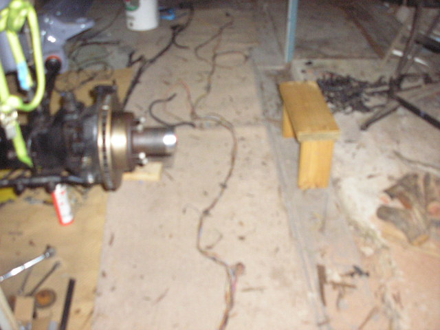

Apart from finishing floating floor tonight, nothing to report. However, I finally got some axle and bearing pics today:

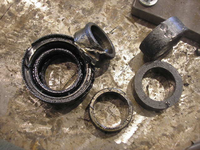

The seals were stuffed and leaking, so new bearings were a must. I drill the collars and split them with a cold chisel and hammer, grind the inner races almost through and do the same:
New bearings:

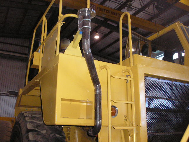

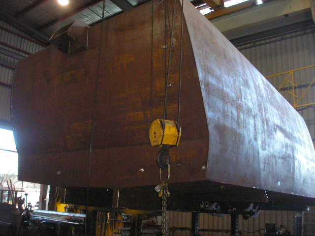

Figure some of you might be intrested in what I do during the day, edited for more detail;
Water transfer pipe for front spray bar and remote control monitor on CAT 773B ex dump truck (to be fitted with custom built water tank):
Pipe and mounting for Akron remote controlled monitor, same truck:
water tank under construction for 773B:
773F with water tank fitted for pivot pin/bushing fit-up and tacking. The tank will be removed to weld the pivot bushing in and pipework underneath (my job):
I'm doing the water pump feed, transfer pipework, spray bars and pump mounts, fitting up and routing hydraulic hoses and fittings and all the ancillary work on these. Lots of fiddly little bits and pieces.

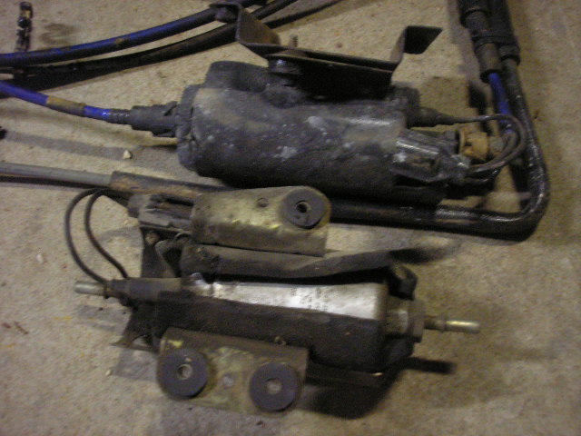

Scored well today, drove 300km each way and picked up a good rear 19 gal tank, with LP pump/sender still installed, the HP pump, all the lines and 2 way valve/filter, upper and lower straps AND, the complete rear harness! Picked all that up for the princly sum of $70. :D Tomorrow, I will post pics, and pull the pump so I can take the tank out for a thorough clean out, then a re-paint ready to fit. Only need the X member to fit it now, but I will prop it up in its correct position and start fitting fuel pipes, and make a start on the wiring harness. The 2 way valve wont be fitted, I will install a factory style canister inline filter in its place and make a joiner for the return hose. Hope to have the 9" assembled by the weekend and have it rolling some time shortly after that :D Pics tomorrow.

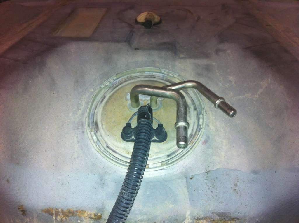

Promised pics of fuel tank, etc:
The bottom pump is my spare I already had:
Tank sender/pump:

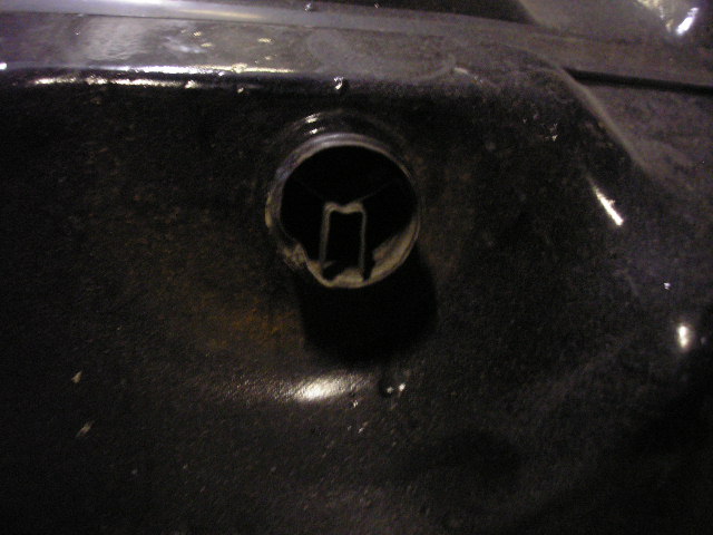

Tank inlet with vent pipe support:

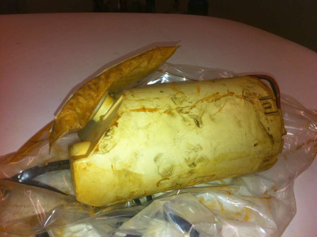

So, I broke my pump ring tool trying to remove the locking ring.... thats down the back yard somewhere. A hammer and drift got it moving without damaging anything, pulled the sender/pump and found this:
Just as well I ALWAYS check the sender and or pump whenever I buy a tank, as I get about 1 good one out of 5. Can anyone tell me if the 90 - 96 HP pump/sender will fit in its place? I'd much prefer a single in-tank pump over running 2 seperate pumps (just means I have to carry 2 pumps instead of 1 spare). After emptying 2 gallons of stale, stinking gas out of the tank ready for cleaning, I decided to attack the harness, stripping off the miles of insulation tape:

The newer pump is too big to fit through the hole. You are better off buying a Walbro 255lph hi psi pump, it will replace your low pressure pump.
http://www.autoperformanceengineering.c ... specs.html
Posts: 2811
Re: Rod's 84 BabyBajaF100
Sorry, Philo, but now I am confused. Correct me if I'm wrong, but 80 - 85 fuel tanks (front or rear) have a 2" sender hole, and 86 - 96 EFI tanks have a 3 5/8" sender hole. How can the 3 5/8" 90 - 96 pump/sender ass'y NOT fit the same hole as the 3 5/8" 86 - 89 tank? Or is this something to do with the position of the pump inside the tank? I have been researching this for days, and I cant see what would stop me from using the later hi-pressure pump in the earlier (lo-pressure pump style) tank with the same size sender hole. :? :? I am not doubting your knowledge or expertese here, but I cant see for the life of me why this cant be done. Educate me.
Your photo looked like the smaller style to me.
I still wouldn't bother with changing the hanger and fuel pump to the newer style, I'd just get a replacement pump that offers higher pressure and LPH. The earlier style pumps are small enough that you could stuff two in there and have a built in backup.
Posts: 2811
philofab wrote:Your photo looked like the smaller style to me.
Its definately a 3 5/8" hole in the tank, I measured it tonight after I pulled the sender and pump out. I was just going to either buy a whole new 90 - 96 pump/sender unit, or do as you suggested, fit a 190 or 255 in place of the lo-pressure punp in there now. I dont have to do it tomorrow, so I will think it over for a few days. Thanks for your input, either way, Philo, its always appreciated. :D
I don't know if you planning on using your stock gauge but the senders use different ohm scales.
Posts: 2811
Ah! Perhaps thats what the main difference is, not so much the pump. Hmmmm, need to reconsider that. Thanks for that insight. :)
