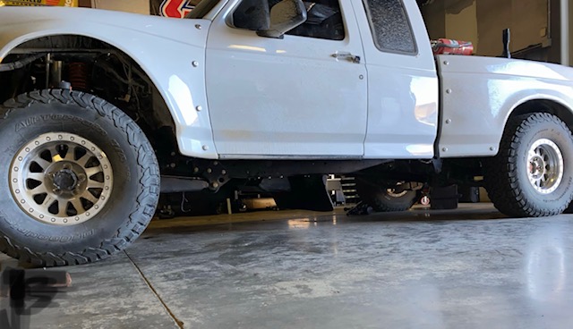

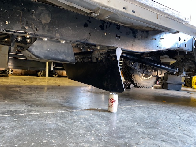

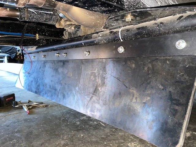

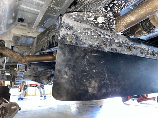

Finished up my “rock-skirt” finally and I checked with Geiser Bro’s. about the actual material to use. I think it turned out pretty cool and should function like it’s intended. The pic with a soda can is a visual for height off the ground.

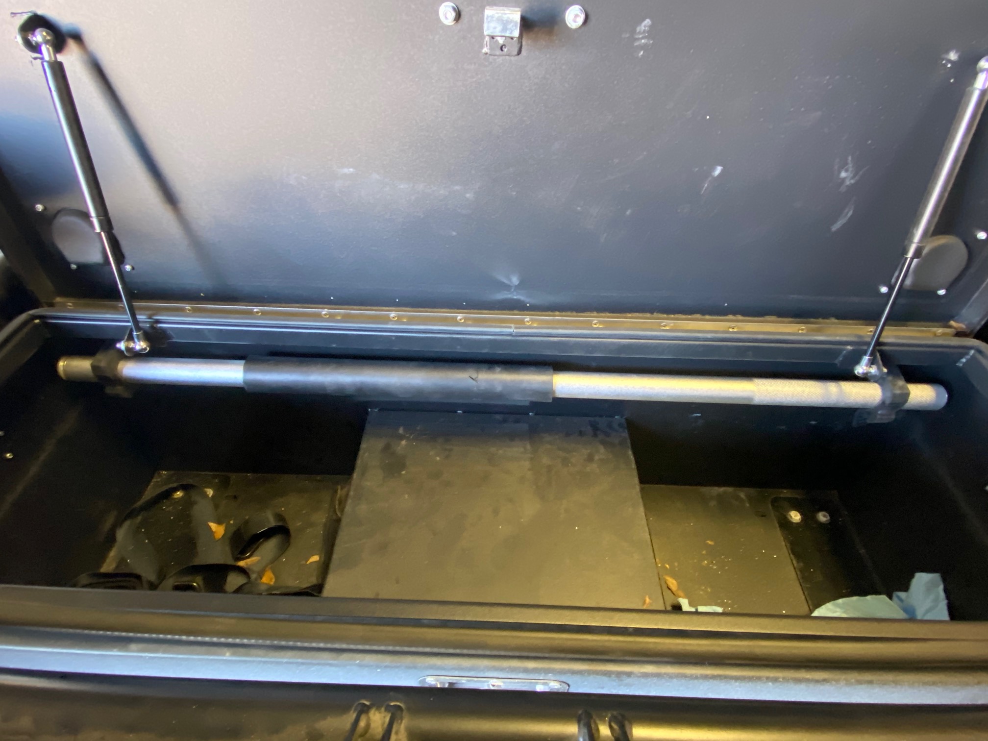

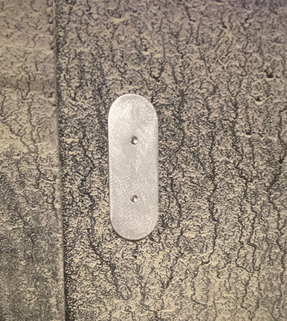

Re: 95 F150 - Project Marilyn

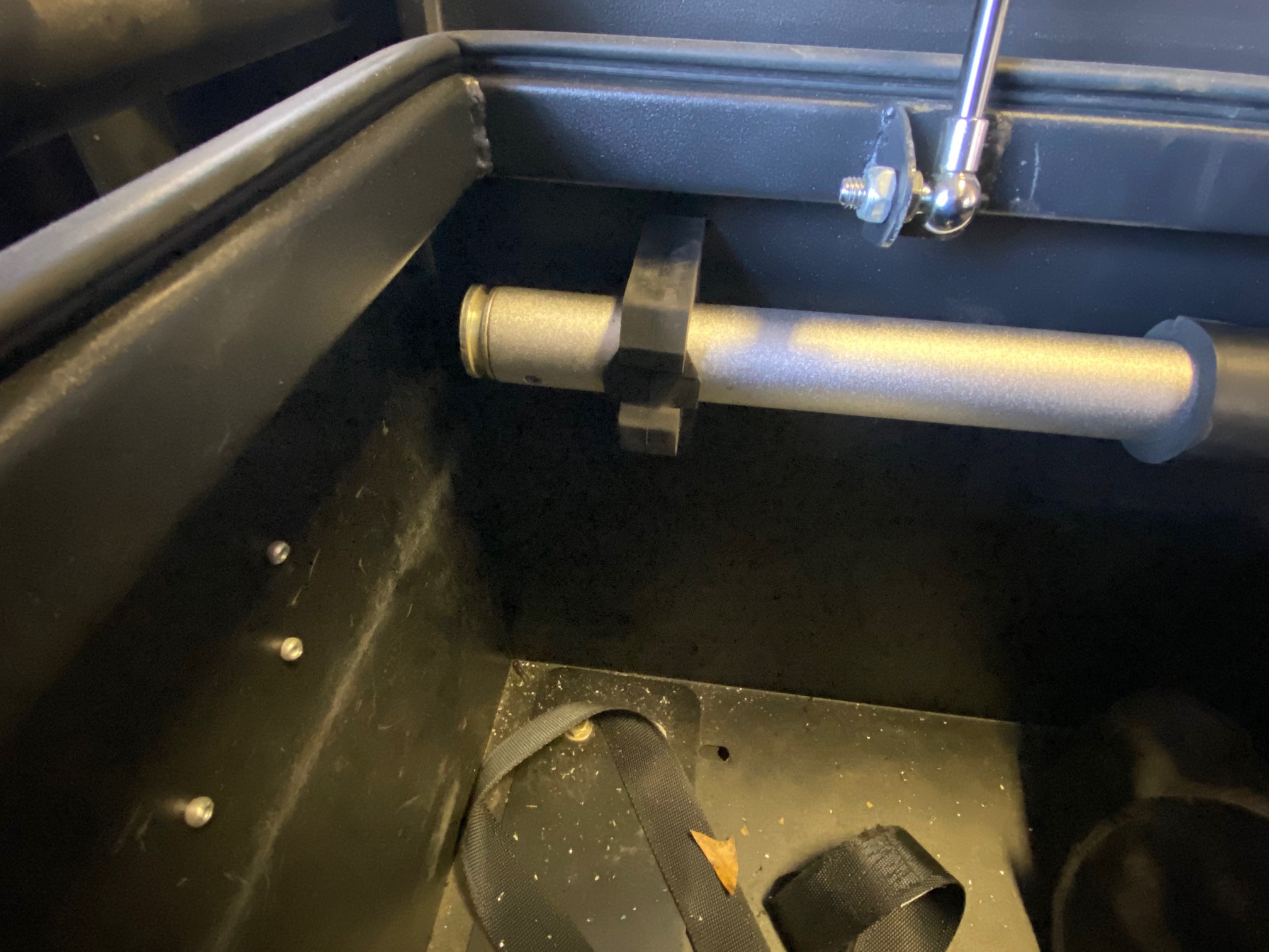

Ordered up a couple Quickfist mounts for the jack handle. Cut about two inches off the length so fitting inside the bed box is super easy; no reason to mount in the bed to have it easily stolen. Welded the handle together as well for a more solid action when using the jack. Funny how long all these tiny projects take 60-90 minutes at a time and if you don’t do all these little details you’re left with a truck that just isn’t something you can put your trust in.

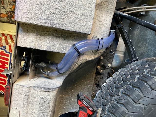

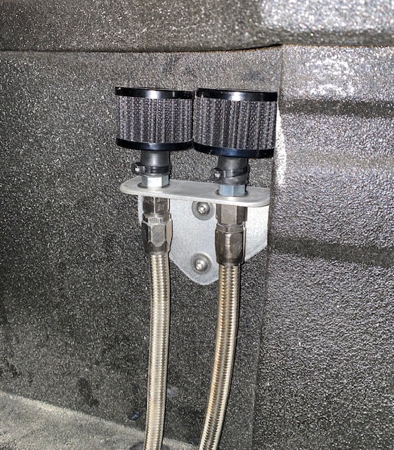

Finally got the gas tank routing done how I want it and put a line to vent the rear end/gas tank. The clear stuff will either last a long time or be a total bust. I’ve got tons of older -6an ss hose and fittings - wouldn’t trust the hose for fuel pressure anymore but with zero pressure hopefully it works as a vent. I added some anti abrasion sleeving to help keep the ss from tearing up anything.

What material did you end up using on the skirt. I might have my guy do something similar while he finishing up my truck.VintageIronFab wrote: ↑Fri Feb 14, 2020 8:49 amFinished up my “rock-skirt” finally and I checked with Geiser Bro’s. about the actual material to use. I think it turned out pretty cool and should function like it’s intended. The pic with a soda can is a visual for height off the ground.
¯\_(ツ)_/¯
- Posts: 2338
- Bronco Info: Bronco List:
- Location: Phoenix, AZ
Per Geiser Bros. - conveyer belt material- if those guys say use that material you can’t argue about it! I think the really long strip of material on the back acting like a really long washer is going to work really well.

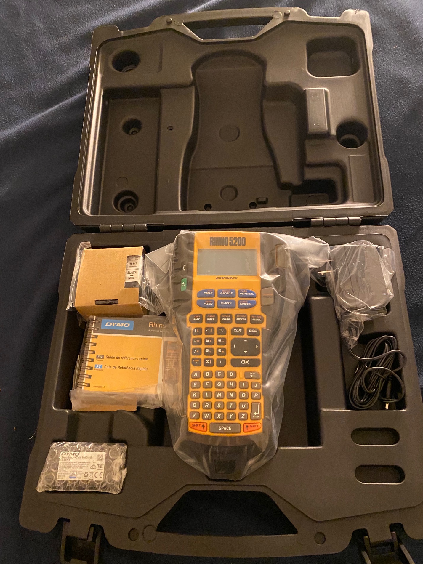

Picked up a tool to take the quality game up a touch...

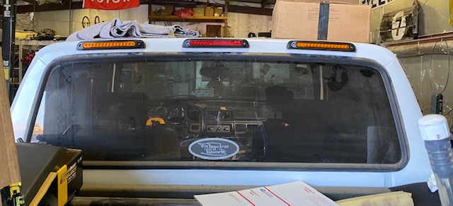

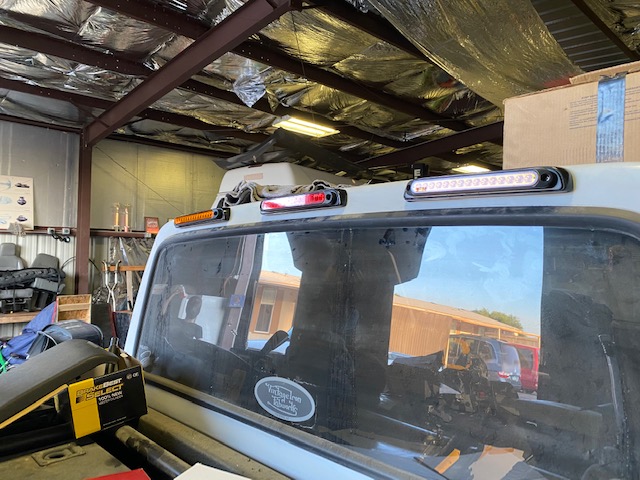

Waiting on Charlie at Power Steering Solutions to work his magic on my steering box, pump and ram— I’m working on small projects for SEMint 100+ prep. The dust lights and third brake light configuration is finalized. There are some expensive alternatives that are nice but I’m personally just not a fan so here’s my method.

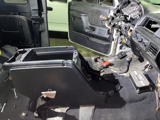

My weekend project. Trying to successfully meld a factory 13 Raptor console to an aluminum skin that transitions to the dash and mates up and matches the dash contour exactly. So why like half way - I’m going to make the side pieces then weld the 2 together. It’s all getting wrapped in a thin padding and vinyl that matches the seats. It’s either going to turn out awesome or awful!!
