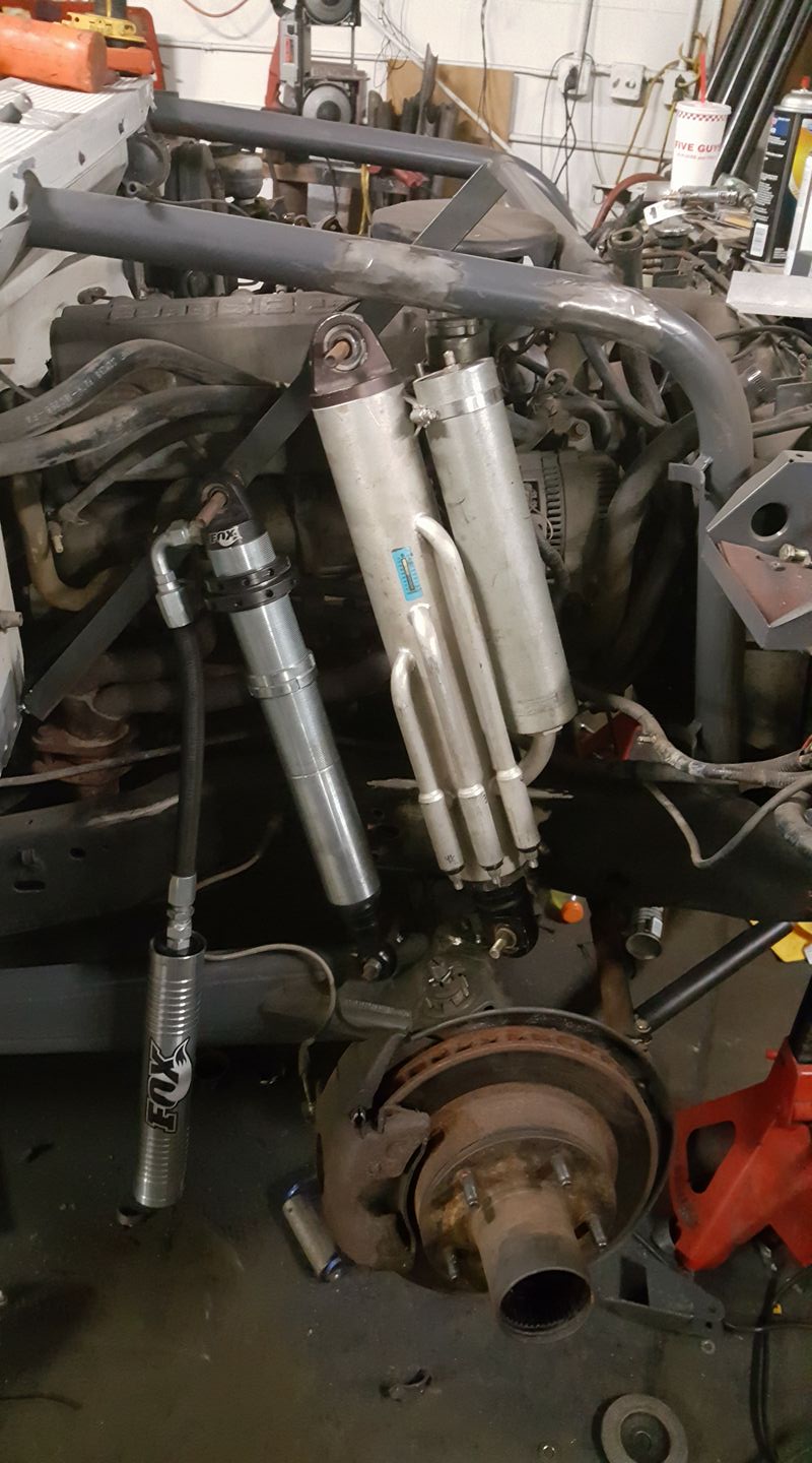

The next piece of the puzzle has been picked up thanks to the boys over at Richer Racing we will now be able to package our big shocks on the shop truck. Also naturally had to get one for the bronco too.

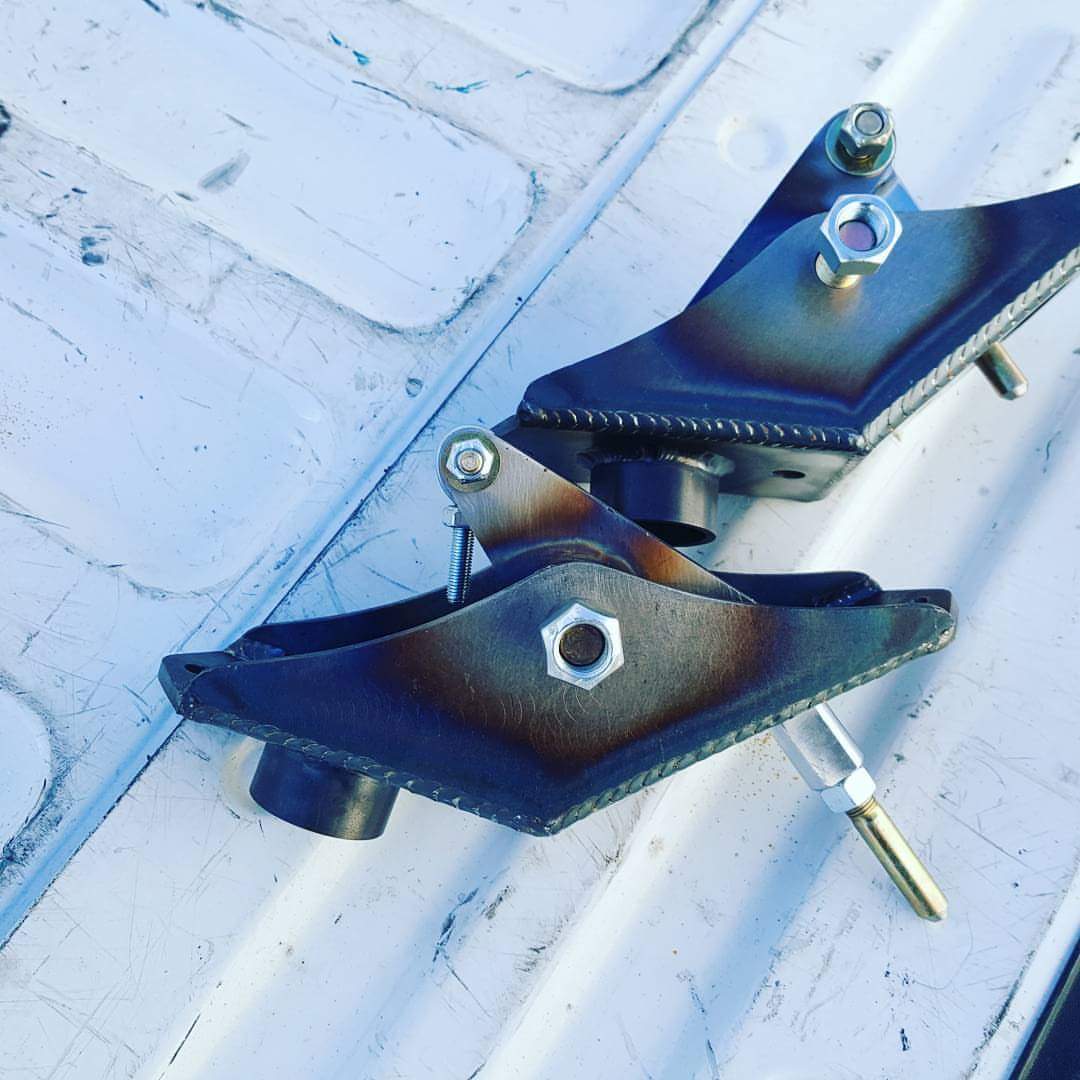

Offset m/c bracket?
hollandermotorsports
Posts: 969
Re: Hollander's TTB F-150
VintageIronFab wrote:Offset m/c bracket?
it turns it back towards the fire wall for shock clearance.

Here is some Shock mock up.
