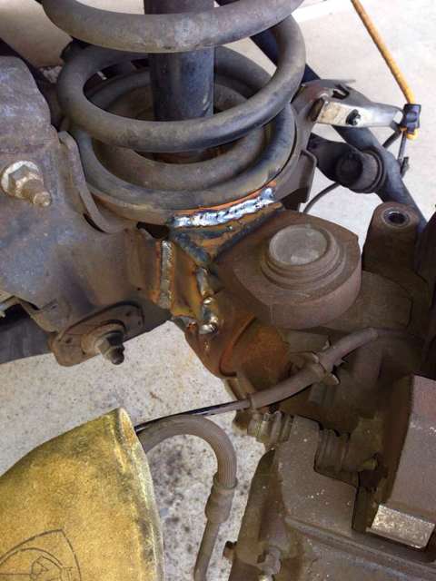

Plating on my truss and knuckle

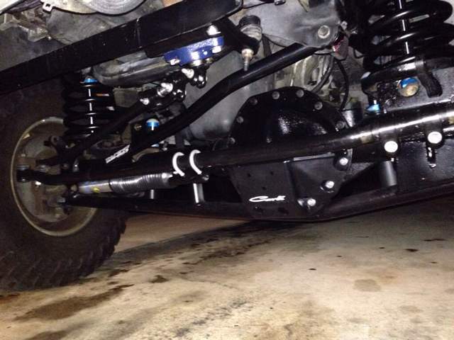

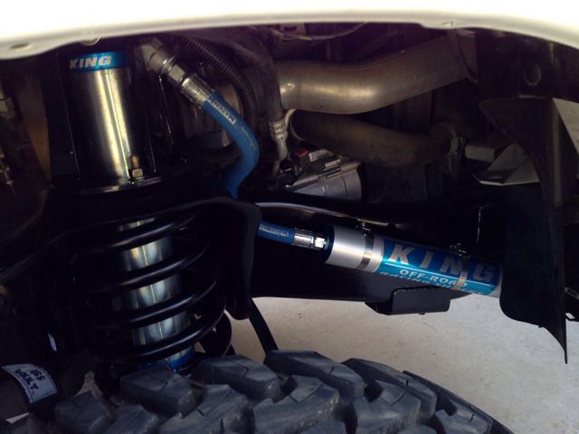

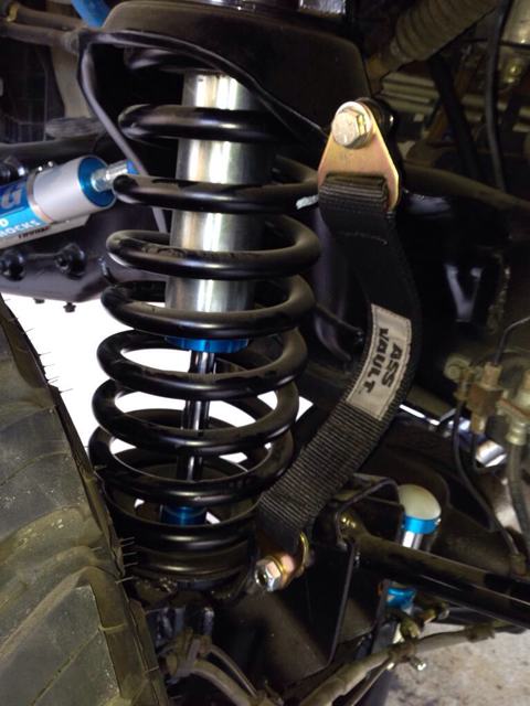

It feels so much better by doing these mods. I swapped all the steering parts over with the Mopar 2008.5 and later upgraded parts(huge drag link and reconfigured pitman to drag link connection to get rid of bump steer). Also added the box support with sector shaft adapter with a carrier bearing.
The feedback on rough roads is great and feels very steady even though the sway bar is gone! Street/highway manners are predictable and it still looks sleeperish.
As soon as my rear bypasses arrive(any day now) I will swap my stock leafs out for some Deaver LT beasts with Carli shackles that I have staged up and install the Kings out back. Then it's time to cruise the mall.

Also, did you truss the rear axle at all? I was talking to Bailey (Rigid Light wrapped truck) and he said he destroyed two front housings and one rear before they where all trussed. Any photos of your filter setup installed? Seems like the way to go with the chances of getting dirty fuel in Mexico or even here in the states.

Philo, I didn't truss the 11.5.... We will see how it and the upper shock mount holds up.

3.0s or 2.5 Bob?
