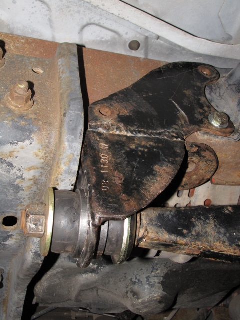

Nice, Philo. No interesting updates. I'm going to correct the wheelbase (matching left and right) by offsetting the radius arm pivots. The left side will stay where it is and the rear will come back .375" which should put it where I need to be. I need to have the rings for the pivot bushing part of the radius arm brackets machined to my specs. I hope to have that done next week. Once that's done, the front will move into final assembly.

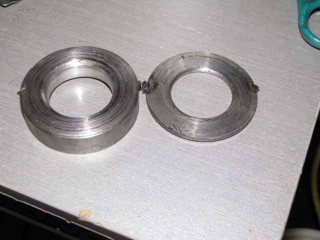

I know all of you are way smarter than this, but damn it do I hate it when I have a plan, execute it (or mostly execute it) then realize I'm REALLY over-thinking it, doing it all wrong and just making the task MUCH harder than it has to be.
So to correct wheelbase (matching the two sides), I had these radius arm bushing pivots made for the right side (short beam).
These would sandwich the pivot bracket plate and allow me to move the right side radius arm pivot back without having to cut the bracket apart and re-work it (which was going to be tough because it's a pretty tight fit against the trans cross member. I thought it was genius until I got it tacked together and figured out my measurements weren't quite dead-on. Crap. Now I gotta have more parts cut. And since I'm paying someone to do this, it sucks even more!

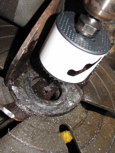

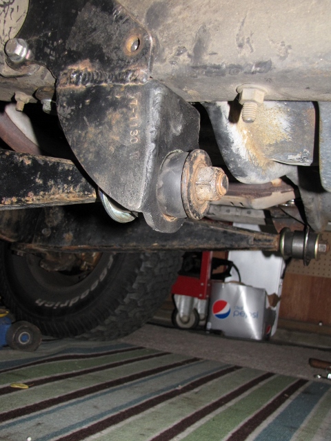

The solution: Why the hell didn't I do this in the first place!? The left side used a one-piece... ring? Sleeve? whatever you want to call it. I welded it to the front face of the bracket plate, the rear half of the bushing is recessed into the plate... works great. Simple, simple simple.
So, here it is. Hole saw the bracket to the O.D. of the sleeve, use a sleeve just like the right side, put it all together, adjust the wheelbase as needed, weld in place and be done!

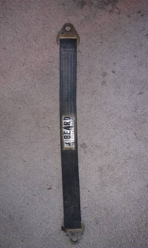

We stopped at a yard sale yesterday on the way home & I scored 4 limit straps. Best of all, they just happen to fit the front just about perfect with no drilling or modifications. Hopefully they can work in the rear as well.
