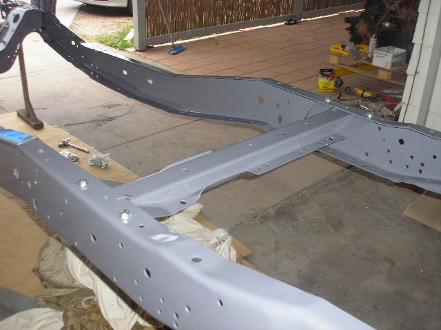

Had a day off crook, vomiting most of the night, so after getting a few things done once I felt better around lunchtime, I went and bought some bolts, washers and Nyloks: :
Then, started re-assmbly:

Thats as far as I got tonight, had enough and needed a rest. Most of the bolts are firm tight, but tomorrow night I will break out the touque wrench and start torquing them to the proper tension. I have to swap some of the bolts at work, as I need 3 different lengths and could only get the middle one I wanted. I know I will need more as I go along, but 50 will get me by to get a lot bolted together. Atleast it is taking shape again, it's not a pile of painted pieces, it is now looking like a truck frame again! Might get to start the cab soon, after all the lines, cables and wiring are installed, along with the suspension and rear axle. :D :D Stay tuned. ;)

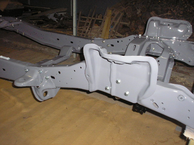

Changed most of my bolts at work today, so I got more stuff fitted up. Gunna leave the torquing for tomorrow, my shoulder ain't playing the game tonight. But, progress was made until I ran out of washers and Nyloks again :oops:
Temporary beam pivot fitted with factory hardware and HT bolts:
More pics of the assembly progress:

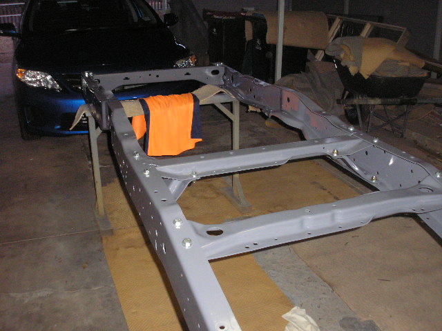

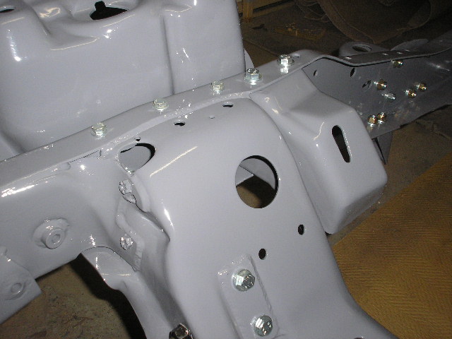

Even though I have welded the X member laps to the frame, and I removed the rivets there, I fitted new hi-tensile bolts to make sure there would be no flex in the welded area. I was surprised how much they pulled up before they went tight:
Somehow, either I screwed up or Summit put the wrong part # on the website, but I ended up with the Energy Suspension 3" poly bush rear kit, instead of the 2.5" kit. I will research the correct width tonight, and just cut the tubes and bushes down to the correct width at work in the morning, and repair the spring hangers ready for paint and fitting. Then I will start painting/preping the radius arms and beams for thier fit-up. Once the TTB is all in, I will attack the rear springs and then tackle the diff re-assembly and get her on 4 wheels again. Then, or in the meantime, I will start fitting all the brake pipes, canister pipes and fuel lines, modified wiring harness, etc. Progress at last :D :D

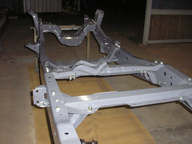

Got more washers and Nyloks this morning, and after some domestic work, started finishing off the frame parts re-install. Then I broke out the torque wrench and buttoned up all the bolts, 45 lbs/ft on the 3/8" UNF hi-tensiles and 65 lbs/ft on the M12 HT's. Now I can pick up the right rear corner of the frame and up she goes, no flex. :D Then, I started laying out the TTB and hardware to start the TTB install. I wanted to make sure I have ALL the bolts, washers, etc BEFORE I start, so there is no holdups:

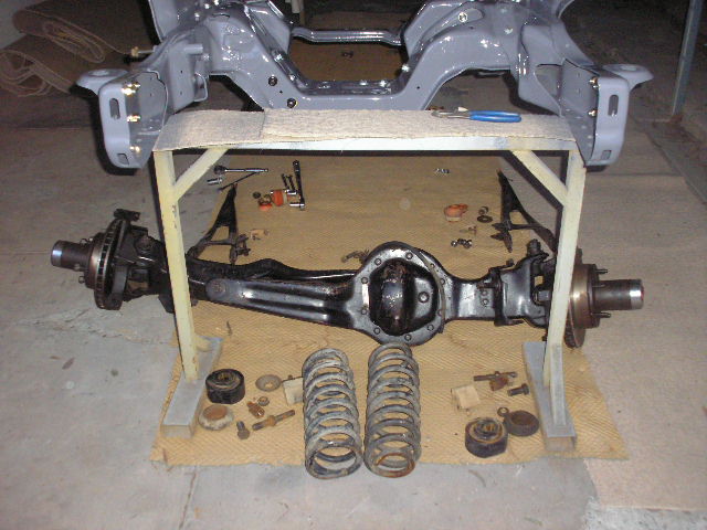

Got the TTB fitted in today, I was lucky my brother visited, and we manhandled it in. I made sure to time the intermediate shaft correctly on assembly so it wont wear/break/vibrate in 4WD. Gunna start on the rear spring hangers tomorrow at work and get them done so I can start on the back end.
Out with 2WD:
In with 4WD TTB:
I have some work to do on the floating floor in the house this week, so I will concentrate my work recoing the spring hangers first during the day (my breaks) and do some work in the house at night for a few days to help protect my ears from the squawking. :roll: I'll keep the updates coming as they happen. :D
