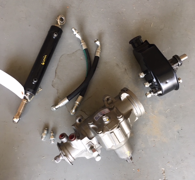

She’s getting a couple spruced and juiced upgrades in the steering dept! The Saginaw box out of the E350 is nice but it was too hard to steer! Not going with a ram or hydro boost at the moment but I’ve got everything ready when I do!! I’d LOVE to see a 90* hydroboost bracket for the firewall of our trucks- I think that would be killer! Awesome braking power and more room for activities in the engine bay!!

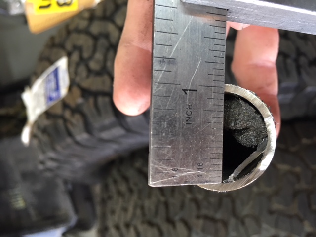

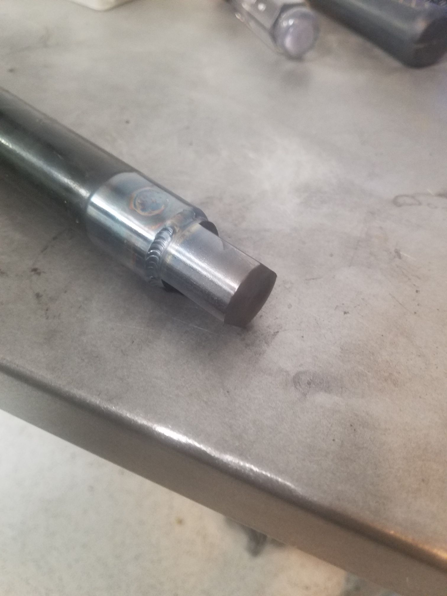

This is how I’ve decided to put new u-joints on my steering shaft. First a little back story- I bought a non Borgeson shaft and it was really loose. So I got to looking the factory shaft and made a couple conclusions—is very nicely made, probably not possible to duplicate in the aftermarket and really should not need replaced. The joints and the “rubber rag joint” are a completely different story. A typical 3/4”DD to 3/4”DD works perfect at the upper joint under the dash. The joint at the steering box is another story. You simply cut back about 1” from the back of the ragjoint. Then a little piece of 2” round stock is turned down to fit 1” inside the factory shaft then the 1” round stock is milled to make a DD configuration. Thing fits perfect and you retain all the really nice factory Ford engineering that went into the original. This method is a slightly more work than buying a new shaft but I think this is a bit better.

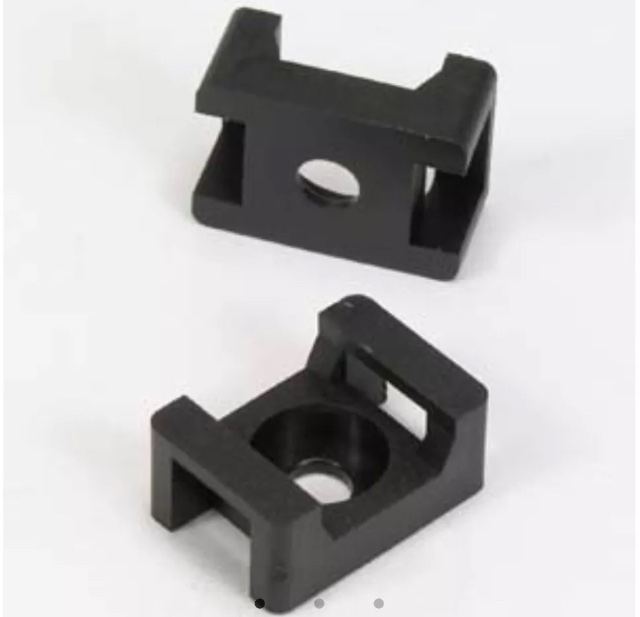

These little cable tie mounts as they are called are nice to use to mount a wire loom, hoses or any lines that aren’t really hot or weigh a lot — just a #8 fastener if your choosing!

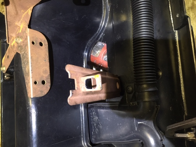

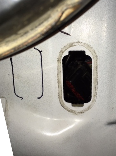

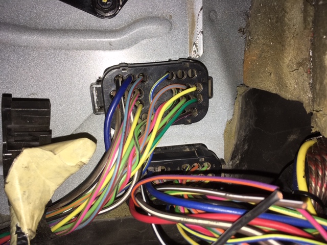

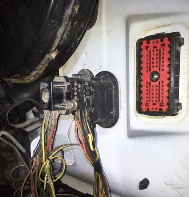

Pass thru-
So on these old OBS trucks/Broncos there is no “pass-thru” for wires to easily and cleanly go thru and the area to do it is even harder to find! Well I think I’ve possibly found about the only spot. It’s literally right next to a factory position and is accessible to add wires as needed from both sides.

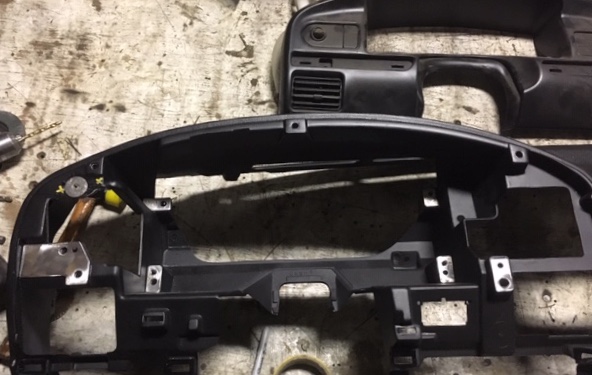

Broken dash fixes-
I like most of you have broke-ass dash pieces all over. So my fix is to fab up any tab that has broken or cracked out of 18ga steel,apply epoxy and pop-rivet when clearance permits to create a bigger bonded washer to hopefully spread the load. I also modified the dash so that the dash cover can easily be removed without a nightmare due to about 3 screws that came in from the backside. It’s a fair amount of work but I think it’s going to be worth the effort and hassle.

VintageIronFab wrote:This is how I’ve decided to put new u-joints on my steering shaft. First a little back story- I bought a non Borgeson shaft and it was really loose. So I got to looking the factory shaft and made a couple conclusions—is very nicely made, probably not possible to duplicate in the aftermarket and really should not need replaced. The joints and the “rubber rag joint” are a completely different story. A typical 3/4”DD to 3/4”DD works perfect at the upper joint under the dash. The joint at the steering box is another story. You simply cut back about 1” from the back of the ragjoint. Then a little piece of 2” round stock is turned down to fit 1” inside the factory shaft then the 1” round stock is milled to make a DD configuration. Thing fits perfect and you retain all the really nice factory Ford engineering that went into the original. This method is a slightly more work than buying a new shaft but I think this is a bit better.
Wanna build me one of these? I’ve been looking at the Borgeson shaft, but I like he idea of keeping a majority of the factory parts and just tightening up all the wobble.

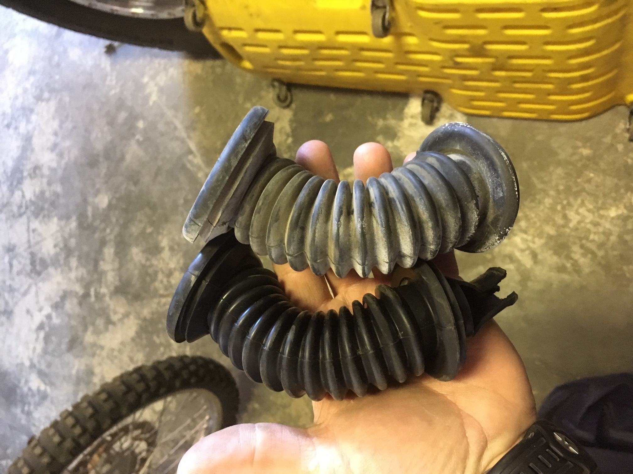

Very trival I know but i can’t explain how paint on these boots that go between the body and door genuinely piss me off- these were cleaned once before. Gawd I hate shitty painters! Got a replacement and with some dish soap and a brush the replacement turned out nice! The boot btw is dry.

Glad you like it :-) Hopefully I’m almost done with the never really being driven part lol! Btw when old rubber is cleaned with a heavy bristle brush with soap and water it just looks new again— then you like soak it in a bag with like Mothers runner restore sauce-kinda like a marinade - you’ll be blown away how the parts return back to a former glory! Much cheaper but more importantly the parts actually fit!
