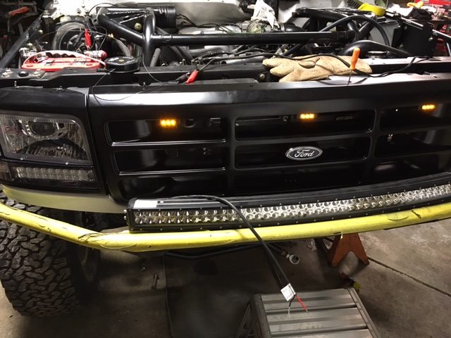

Re: 95 F150 - Project Marilyn

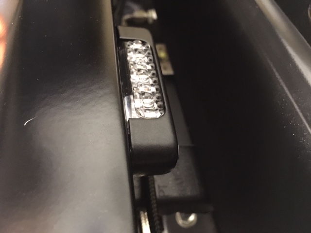

My raptor inspired grill lights--
- IMG_0814.JPG (129.88 KiB) Viewed 2540 times
- IMG_0819.JPG (63.64 KiB) Viewed 2540 times
I have been wanting to do this. Link for the lights?
- Posts: 2338
- Bronco Info: Bronco List:
- Location: Phoenix, AZ
I bought them local at a place that sells every light known to man --they are like wayyyyy overpriced lol but I still sprung for them. I think they were like $16 each with the light and the little metal surround- mine are black but they are normally chrome. The little surround is pretty clever and mounts pretty easy. I guess hit me up and I can get you a set.

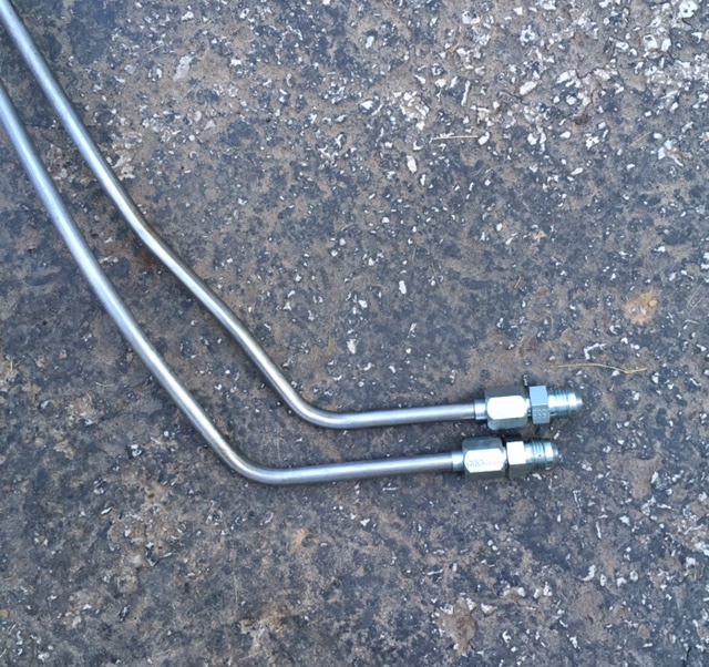

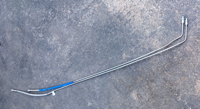

If you ever decide to change your type of injection, add an adjustable fuel pressure regulator, are pulling an engine and mangle a fuel line or maybe burn one up-- one easy and fairly cheap fix is to remove the lines around the fuel pump forward to the engine; cut them at the flex line/hardline area; slide on a tube nut then tube sleeve; then single 37* flare the 5/16" line (on my 95 F150 BOTH lines are this size) then finally add a male/male -5AN/-6AN fitting. After that you just connect to the engine in the configuration you need. Some would ask why not go all the way -6AN. Well it depends whether you need that much fuel volume, and it allows you to retain a factory stainless steel line, fuel filter and fuel pump connection at the tank.

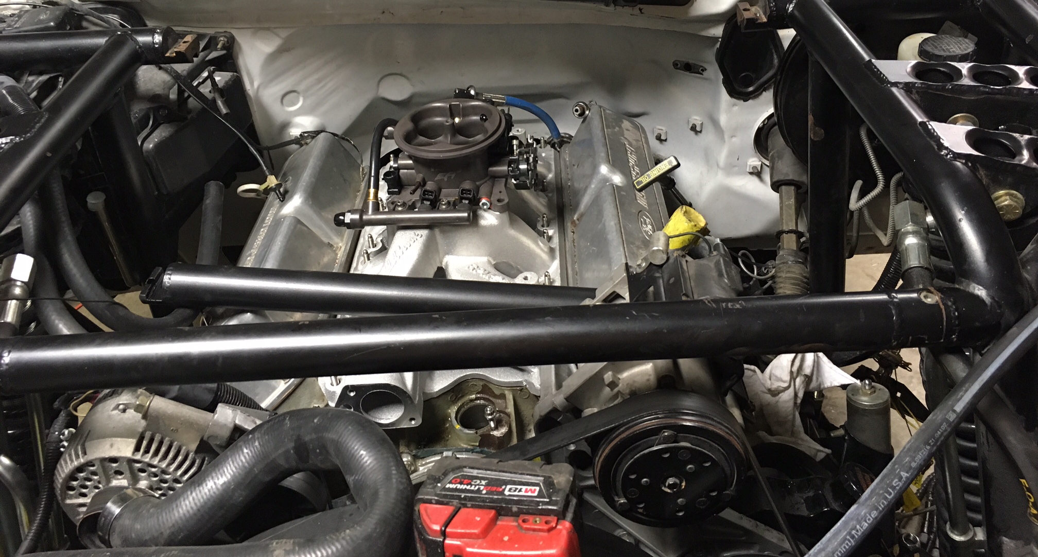

So close I can smell the carbon monoxide!!

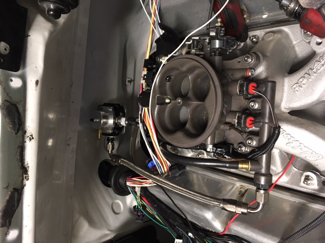

- Posts: 2338

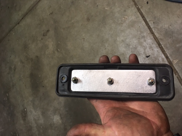

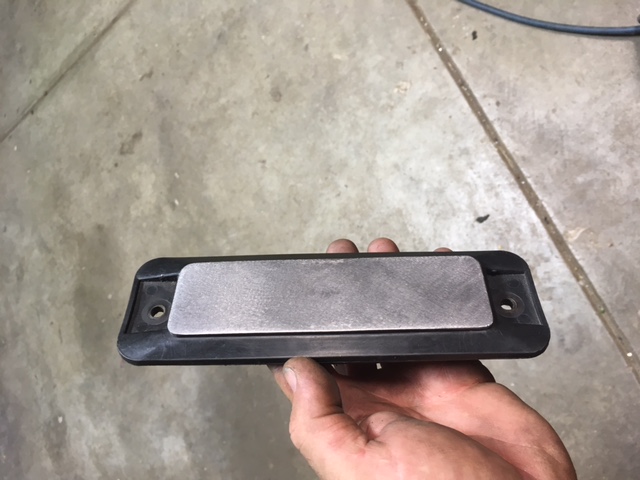

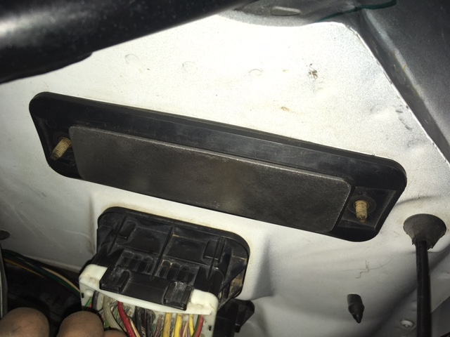

Now that I've got a throttle body vs SEFI on the engine there's a fairly large hole to contend with. Here's my fix that was fast, easy and required no welding wire lol!
- IMG_1108.JPG (92.76 KiB) Viewed 2322 times
- IMG_1109.JPG (85.09 KiB) Viewed 2322 times
- IMG_1110.JPG (99.52 KiB) Viewed 2322 times

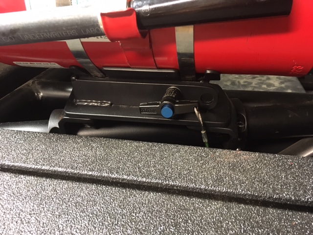

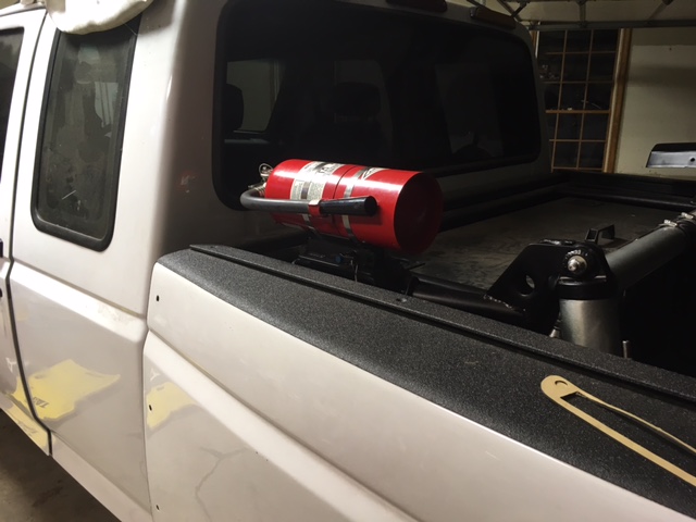

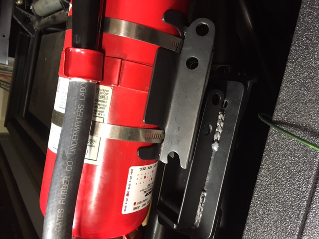

Few pics of my quick release fire extinguisher mount- gotta love that ozone friendly Halon 1211. Didn't want the gear clamp mechanism showing. The extra hole is for a padlock- if you're in downtown Phoenix or Ensenada I don't need it disappearing

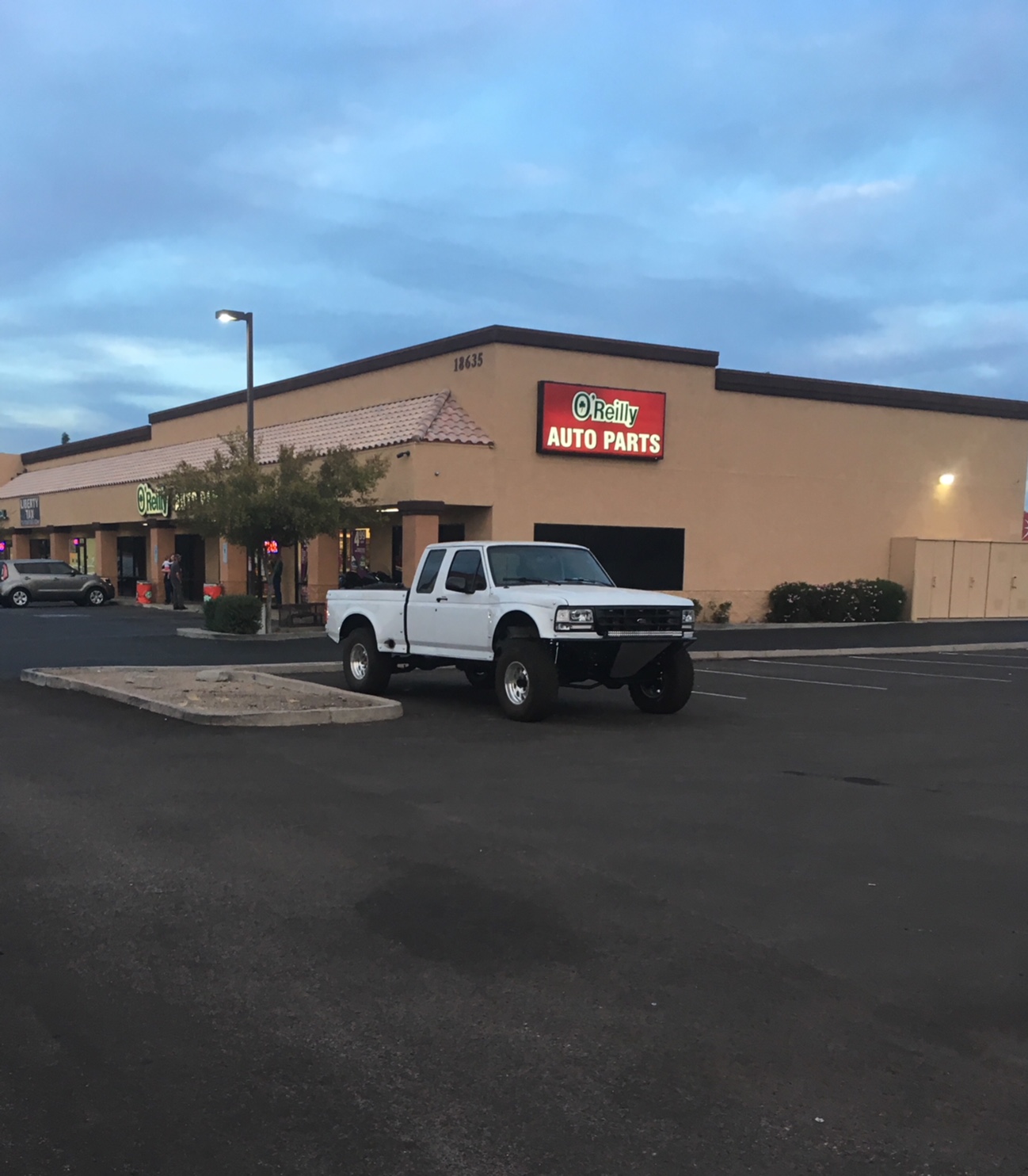

Now that I’m finalky back in Phoenix and released from the dastardly clutches of the Midwest lol...Marilyn is finally getting an alignment! The local Firestone fellas probably haven’t seen a 4.5” over swingset steering truck.... maybe ever!

Well just an update- I’ve taken this truck to 2 places - first place the front end was too wide for the machine; the second place is just honestly being chumps and not willing to do the work. Reason #1892 to not go wider!
If I cat get the engine tuned and the trans controller to work right. It’s a super killer truck but it’s really (and I mean really) testing my resolve.
