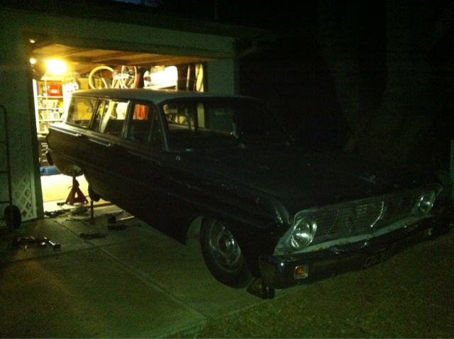

Sunday: I get a hair in my ass to lower the car some more. This car has always looked weird because the molding makes it looks like the front is higher than the rear even if it's not... out come the coils. Through a bit of distraction from the kids, I end up lopping off just over a round instead of the half round I intended. Nothing to do now except make the other side match! I was worried at first but it ended up in just the right spot. The car is significantly lower still has enough travel to ride pretty damn well.

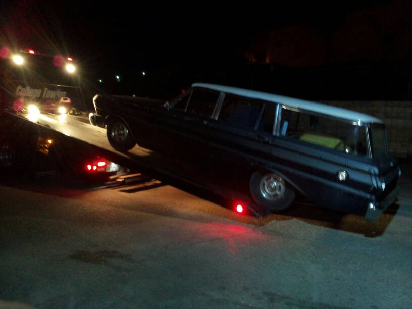

Back to the freeway to test it out. Still hesitating. Crap. I call it a night and head home. I take the offr-ramp near my house and the engine stalls on the off-ramp... traffic coming up behind me, the light is green, I need to get out of the way. It's flooded, I open the throttle, crank, crank, crank, fire... drop it in gear and punch it to get out of the way. I hear BANG! CRUNCH! Stall...! Holy s#%@! I let traffic go around me and roll the car back to get it close to the curb and see a big puddle in front of me. At this point, all the audio info tells me there is a hole in the side of the block and I am done. I call Auto Club to get the car towed back to work. When traffic dies down, I pop the hood and take a quick peek and start to put it all together. The left engine mount let loose, the engine rotated far enough to rip all the shift linkage apart and pull the upper radiator barb out of the top tank. That explains the puddle. I suppose things aren't as bad as I thought but this does put a whole new spin on getting to Billetproof in a few days.

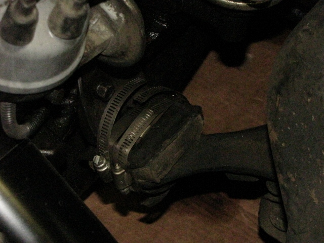

Tuesday evening, post-tow: I drain the rest of the cooling system, pull the radiator and patch the engine mount.

Wednesday morning: The problems have compounded. I still have my original hesitation plus I have ripped the upper hose barb off the radiator. I call the engine mount good even though it transmits rattles like mad at idle... the least of my worries.

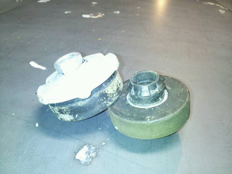

We replaced the shocks on a Flex the other day. The upper mounts looked like them might work well for building some custom engine mounts for the Falcon. A little smaller than I wanted but they totally isolate the mounting bolt and are made of squishy rubber.

Trans mount?

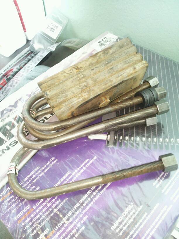

In the meantime, I'm going to install these to lower the rear to a
proper ride height. Maybe that'll help!

Ride height correction in progress.

Hey found pics of my 65, If I remember correctly I cut a coil and a half off the front springs and a 1" block under the rear (spring under) to get the rake I was looking for.
