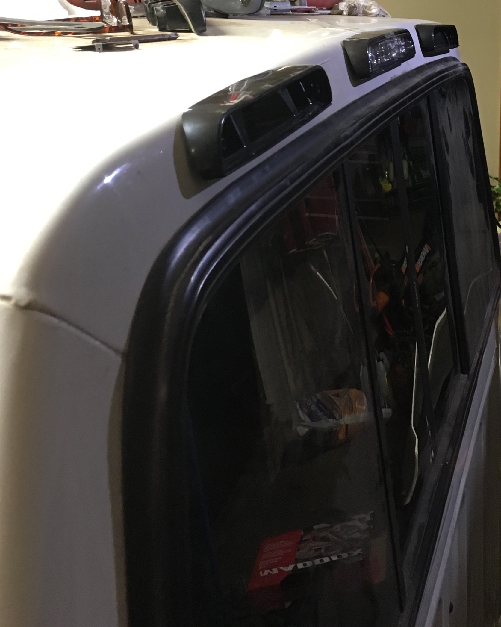

Also got the holes cut for to install the factory-esque dust light housings.....

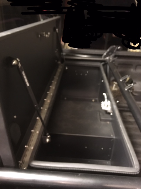

Got some work done on my bed. Got it Linexed, the bedcage bolted in, the tire rack 95% bolted in, and the bedbox all bolted in - the rectangles are big "washers" to make sure the box never pulls out. Here's how I'm planning on fueling the truck. The one thing I did after the fact and was kinda terrified about was if the fuel pump access panel cleared 100% and it does.. crisis averted lol!!!

More bed pics...
