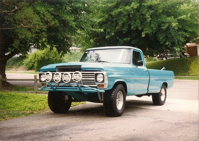

My old 67, and that's the same name it was given. It had a 428 Cobra Jet Motor and it hauled azz.
- web pic.jpg (129.34 KiB) Viewed 3466 times
