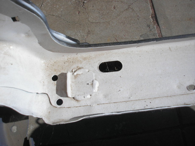

I'm realizing that they changed the radiator in like 85. Not sure this core support is going to work with the newer radiator. Might have to grab an 86 core support from the pick a part.

Tchajagos wrote:I'm realizing that they changed the radiator in like 85. Not sure this core support is going to work with the newer radiator. Might have to grab an 86 core support from the pick a part.
That's unusual, as mine is date stamped 1982 manufacture, but has provision for both types of radiator. All I'd need is the rubber insulators and the top retainer plates to match.

Maybe I'm missing something?

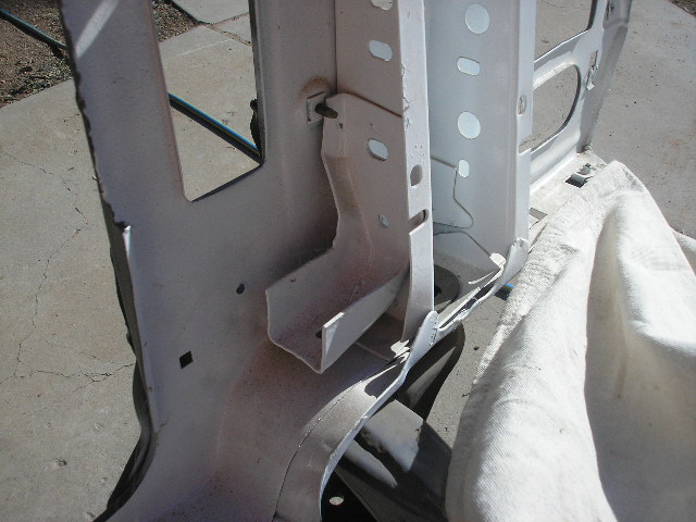

It appears you are missing these saddles:
The folded tabs for the older set up on yours, mine has welded on versions. Strange.

Yep, think I'm gonna have to just take the saddles off and weld them onto my 82 core.
