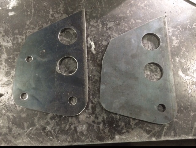

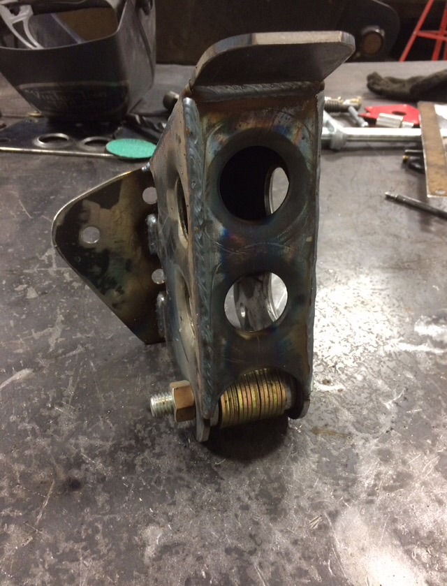

BEAMS!! Still adding a brace so technically not done but close!! I will say don't use 3/16" plate-- I had a 1/8" sheet here but it somehow grew legs. SO MUCH WELDING!!!
Re: 95 F150 - Project Marilyn
Is 1/8" plate normally used?
Posts: 2338
Yea 1/8" is pretty much the norm

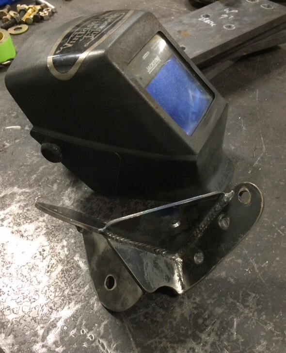

Finally got the truss done!

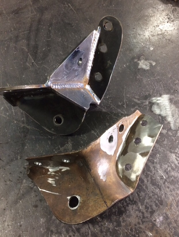

I'm gonna make a couple extra sets so pretty order now!!
VintageIronFab wrote:I'm gonna make a couple extra sets so pretty order now!!

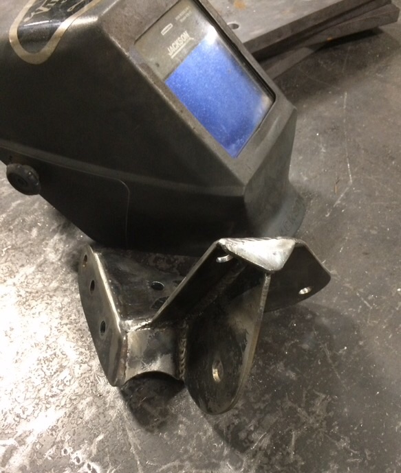

What are those?
look like radius arm plates
otter
Posts: 534
Location: Hawaii
Post by otter »
Pivot brackets
otter
Posts: 534
Location: Hawaii
Post by otter »
Axle pivot brackets.

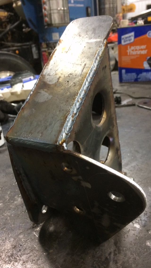

Posts: 2338

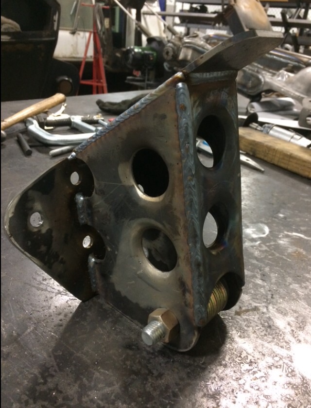

Pat is the GRAND PRIZE WINNER!!!! Pivot brackets! That's the passenger side basic shape. I need to see how hard it is to get a drill in that area of the cross-member because I am wanting to make the brackets wider than stock to accommodate off the shelf uni-ball cups. If you don't turn down the cups in a lathe they hit the bracket as it goes through the travel. So its my idea that you just widen the bracket (as well as tie it into the frame) then you don't have to mess with the lathe-- most guys have 87 types of drills but most don't have access to a lathe is my thinking.

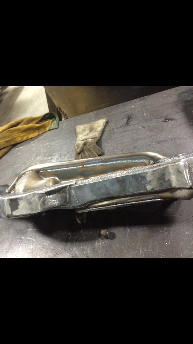

Posts: 2338

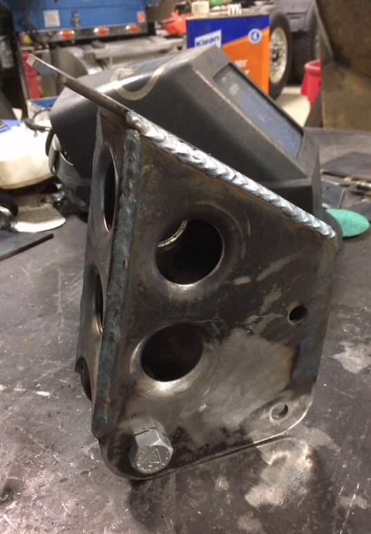

Got the passenger side pivot done today. It's grabbing frame rail and an extra hole in the crossmember. Those extra holesountibg points and 3/16" should make be pretty stout. If anyone wants a HD pass pivot bracket that's totally bolt on (except the 2-extra mounting holes) I made some really nice patterns to make duplicates :D
Posts: 2338
Got my drivers side pivot mount finished-- coilover mounts are up next!!

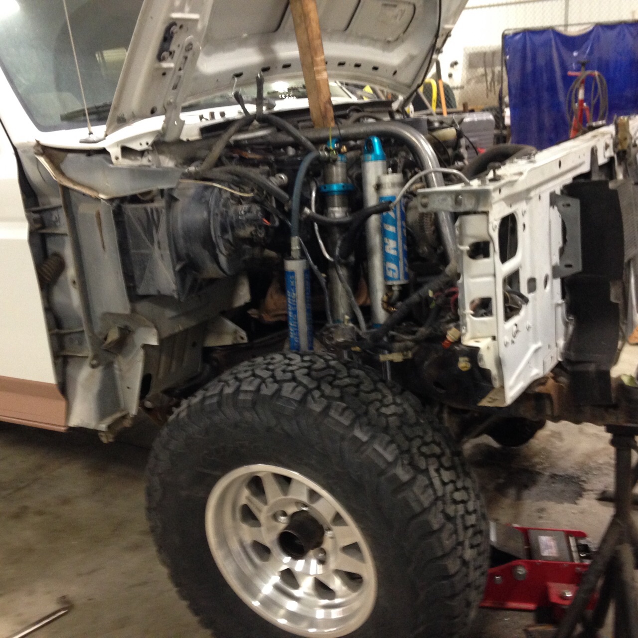

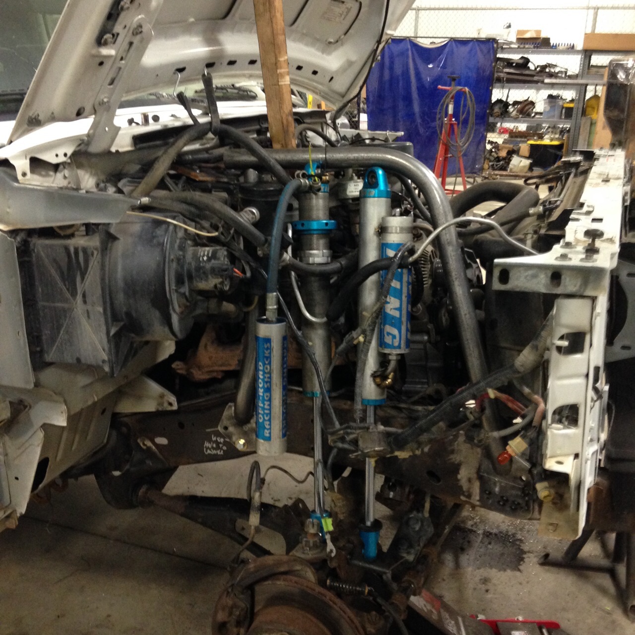

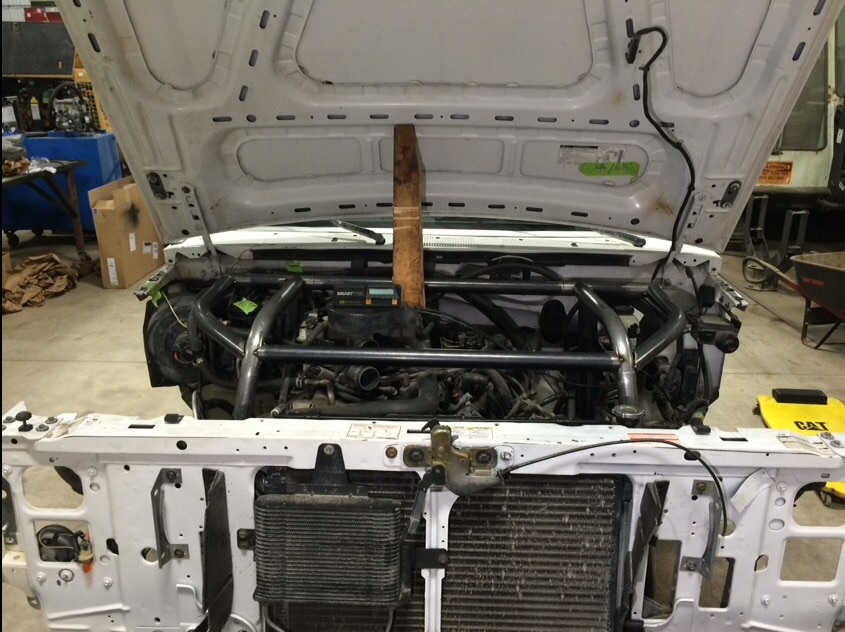

It's staring to get serious! Spent the weekend getting a game plan and bending some tube. The a/c box makes things tight! At this point I can almost feel it going faster :-)
Posts: 2338

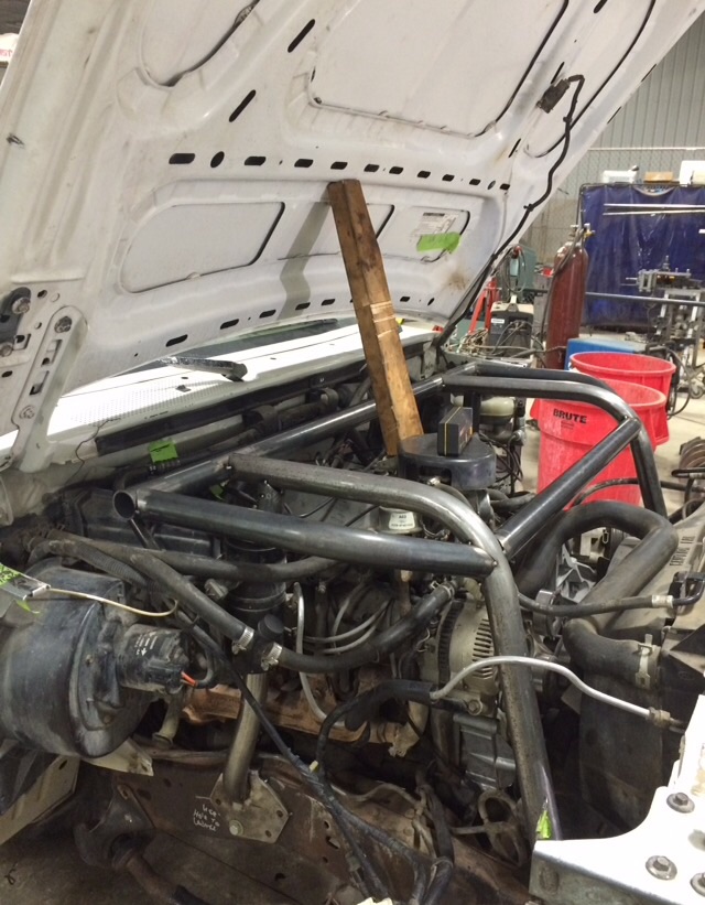

Got some tubes build for the engine cage/coil over mounts. Still have a couple support tubes to put it but it's a whole lot close! I now know why the "plate-style mounts are so popular. Just takes a really long time to make sure all the angles match and miss that a/c box. It's truly a labor of love :-) For the first time I can start to see this thing dancing in my head!
